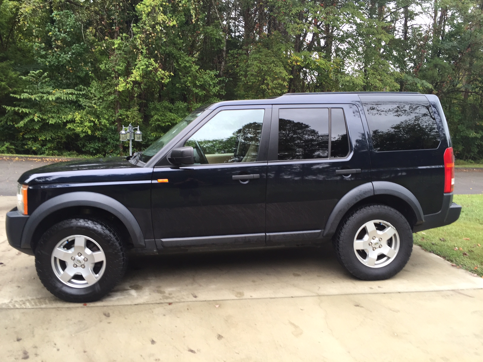

Ok, so I wanted to write and introduce myself and my rover. I purchased a 2005 se v6 rover three weeks ago with 129k on the clock. I've built three land cruisers and enjoyed a good deal of overlanding experience in Montana and the western states. Just moved to Tennessee this past year and decided to finally switch over to the rover fold. I've always watched from a distance and loved their abilities as well as comfort.
So that being said I got a pretty good deal on the rover. Thankfully due to you guys and this site I was able to point out so many small issues i got them down quite a bit on cost. I grew up in an auto shop and I'm an engineer so I'm pretty handy but i'm already learning I need to ask questions.
Anyway on to the tech;
The few things I noticed right off was the airbag light on the dash is on, there is a driveline noise, and a back window doesn't roll down at the drivers switch.
First thing I did was change all diff fluid in hopes I could diagnose the noise, nothing changed there. The fluid was very dark and the drain plugs were covered in a gummy substance and metal shavings, nothing crazy but a good deal of it. So i moved on to the transfer case, still no change in the noise.
Goal: Build a capable over landing vehicle that can take the family to remote locations. Not building a rock crawler. I want a comfortable ride for the week that is good on a mild trail to get to places i couldn't with a car...
wins:
1. I took apart the window switch and found a shorted connection, cleaned it up and added some dielectric grease and now she works great.
2. I cleaned the MAF sensor and Throttle position sensor. Both helped level out the idle.
3. Added some lift rods to give it a better stance, will post updated pics tomorrow. Looks good but caused another concern.
Questions:
1. Where should I go next? Transmission? It seems to shift well. Any other ideas on how to diagnose the culprit?
2. Any idea on the airbag? I found a few threads on a spring connection in the wheel. Is there an issue with the airbag to remove? safety wise
3. The new lift rods caused some handling issues. It is terrible on curves now and has twice pushed through a turn into the other lane. Scared the **IT out of the wife. Is this normal? I've look everywhere on the forum and can't find a good thread. No alignment has been done but it didn't look like it needed it.
4. Not sure how i feel about springs over airbags. I'm very used to springs on my other trucks. The ride of the truck seems very unstable and floats all over. It was better before the lift rods but still there. Is this normal on this suspension?
List of things to do.
  1. Replace headlight switch with auto option ( If possible )
  2. Fart fan issue resolved
  3. Build shelf setup for cargo area
  4. Get rack for roof
  5. build rear tire swing out
  6. add winch to front bumper
  7. add aux input in front dash ( working on tracking the input line on the back of the radio )
  8. Figure out the movement in the drivers seat at stops and go's
  9. buy an ODII setup or replace suspensions with springs.
Ok, I won't write all my thoughts but these are a few for now… Note for others, the muffler mod does not work on a v6. I woke up most my neighbors a few nights ago, good lord it is loud and not in a good way. Back to the old setup until I can figure out how to quiet it down after the muffler.
