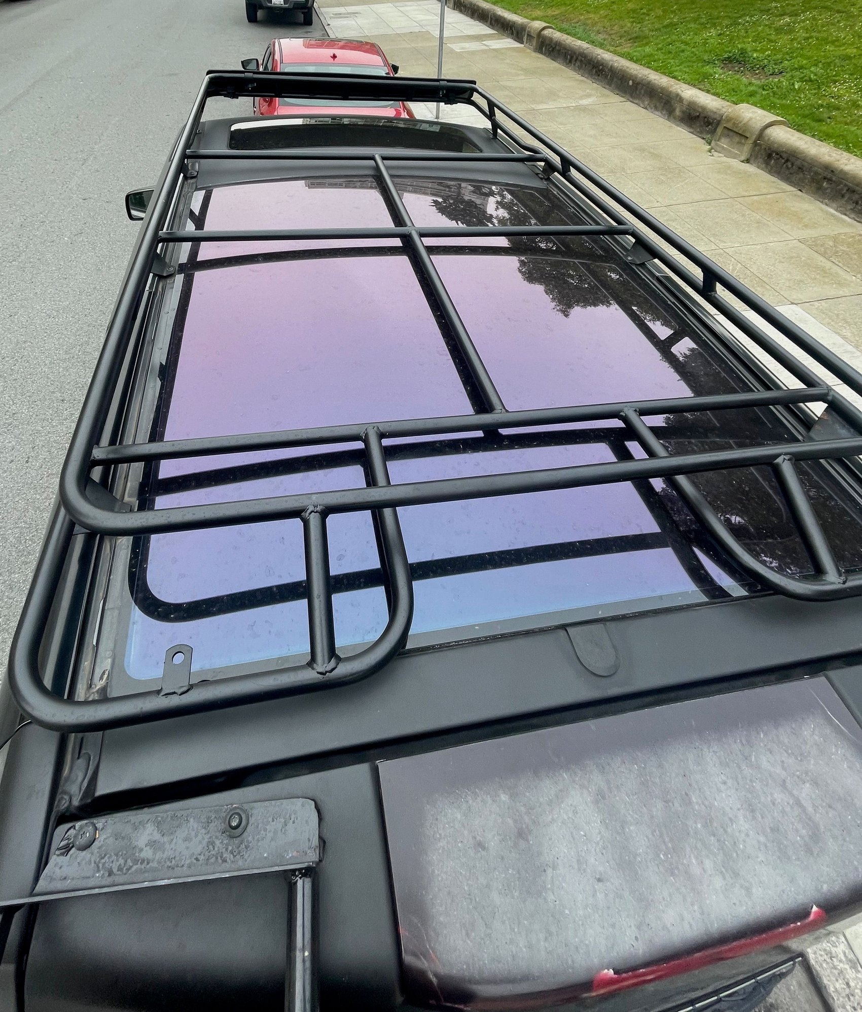

Hi all,
I just picked up a new, beautiful 2005 LR3. Thrilled with this truck so far.
I have a couple of small questions, and maybe someone can help me out. Thank you!
The roof rack is custom-built, but modeled after the Gobi racks. It doesn't, however, have any sort of floor. From the photos, Gobi racks seem to have a sort of cross-hatched foundation. Any thoughts on what to do here?
Second, there's a gap in the cargo area when all the seats are folded flat. I'd love to fill this in to create a solid floor. Ideas?

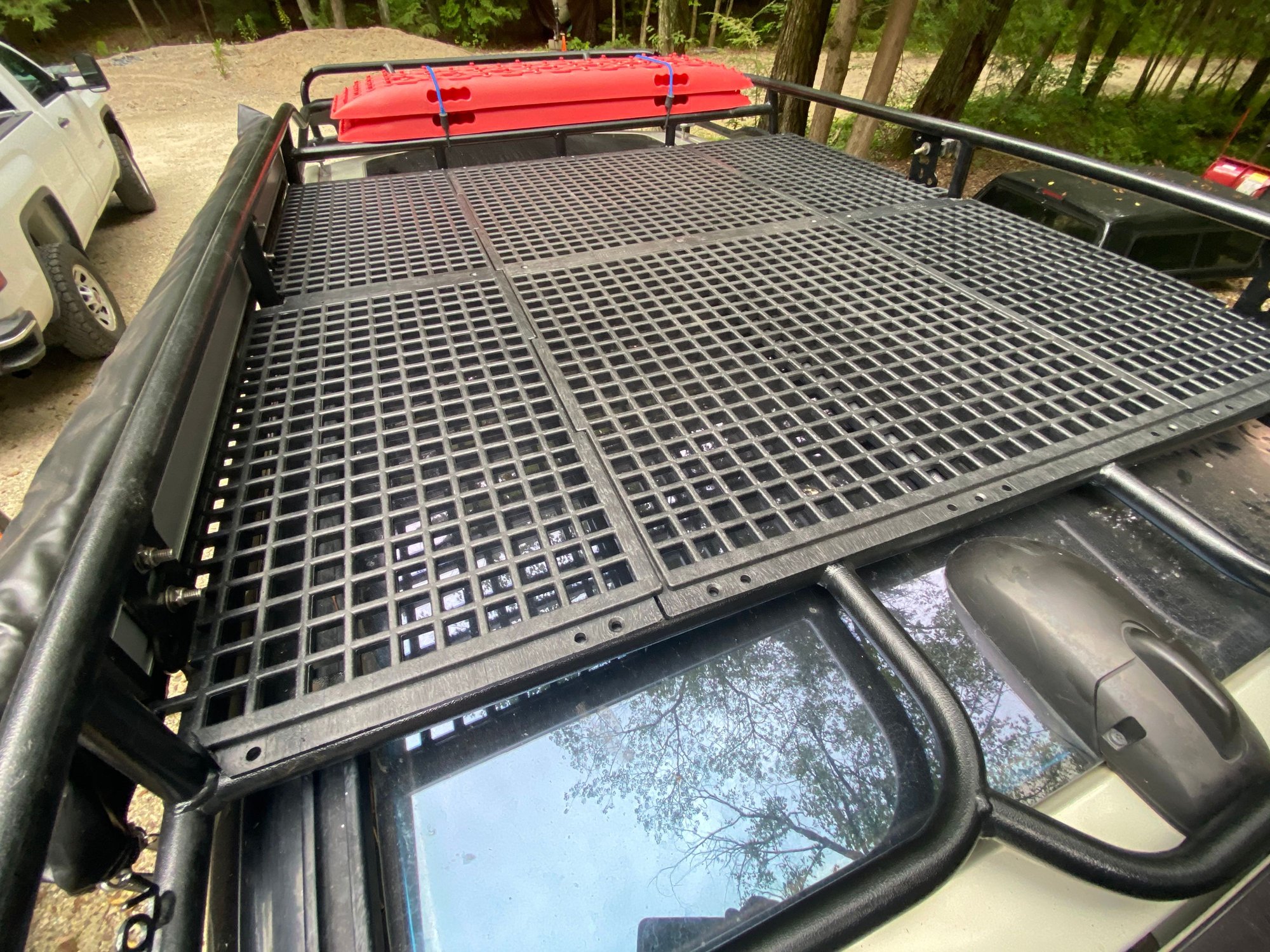

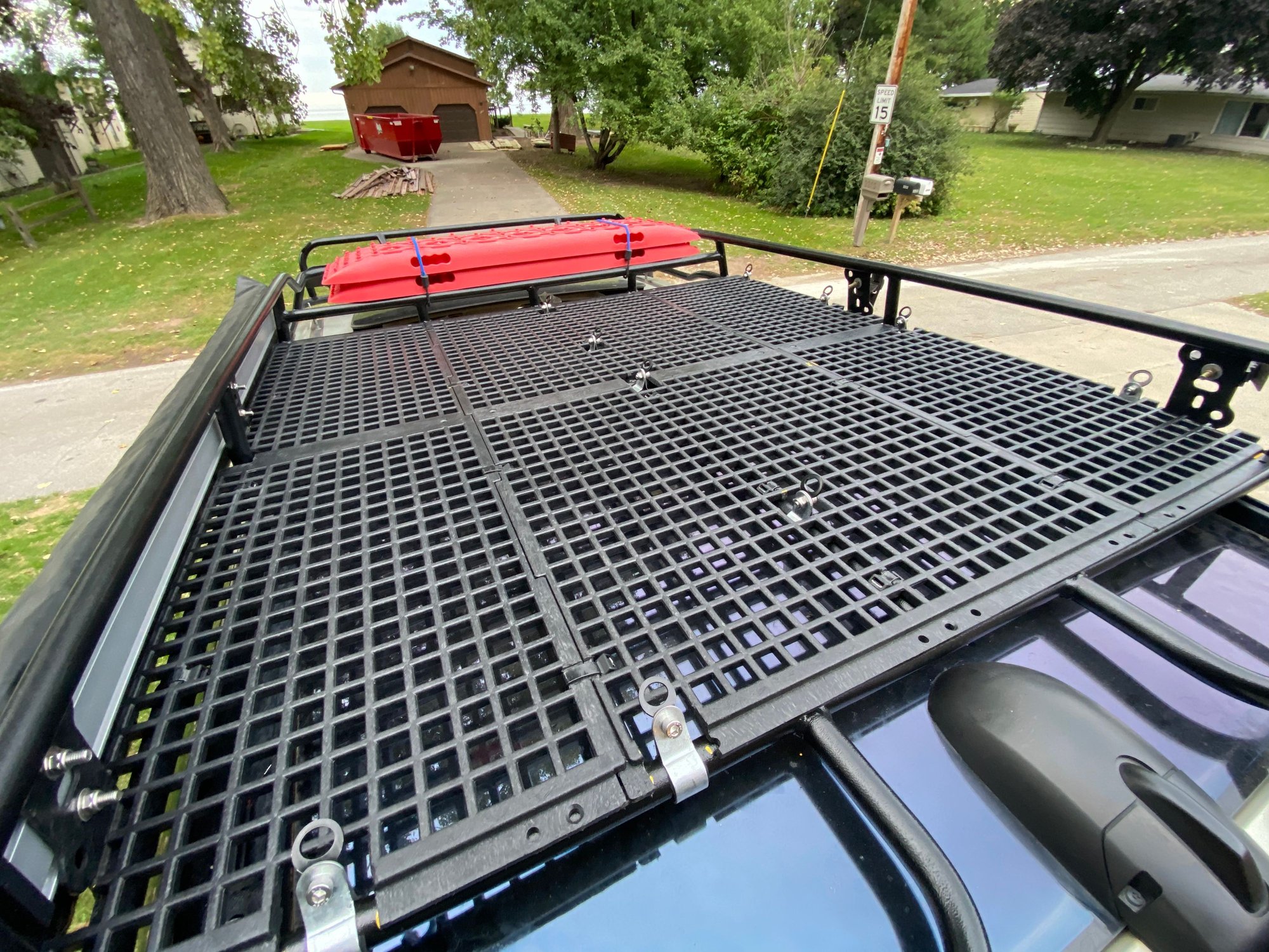

This is what I did for decking. I have a Voyager Rack which, if they called me after placing the order to follow up, I would have had decking installed. But they did not, so I got searching and someone mentioned Versa Pad. It comes in two configurations with how they interlock.
https://www.miller-mfg.com/product/VP2349PK3.html
I found them in state for just $20 each at a farm supply store (Farm and Fleet). I used very heavy duty UV stable zip ties to secure them and I did cut into them to sink the tie and prevent cargo from cutting them. I also placed seams of the pads above crossbars for support. It is holding up well, and while the pads are pretty flexible they are strong. I just dont think I would put all my weight onto one spot. Some pics of install progress. Dremel was a blessing. Last pic also shows some DIY custom anchor points that have worked incredibly well too with ratchet straps. I tend to hold lots of firewood on the left side and Dewalt cargo boxes on the right.
