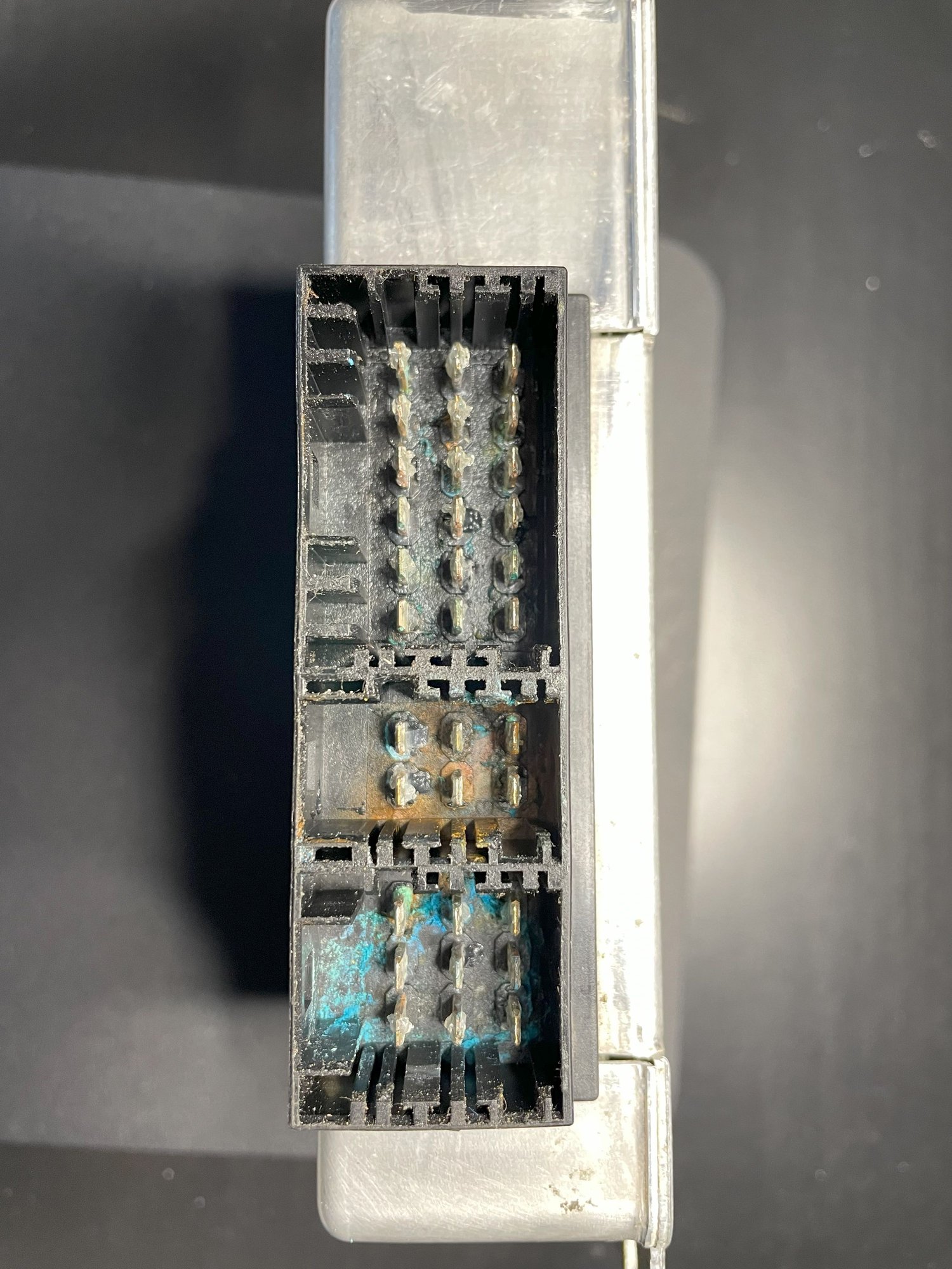

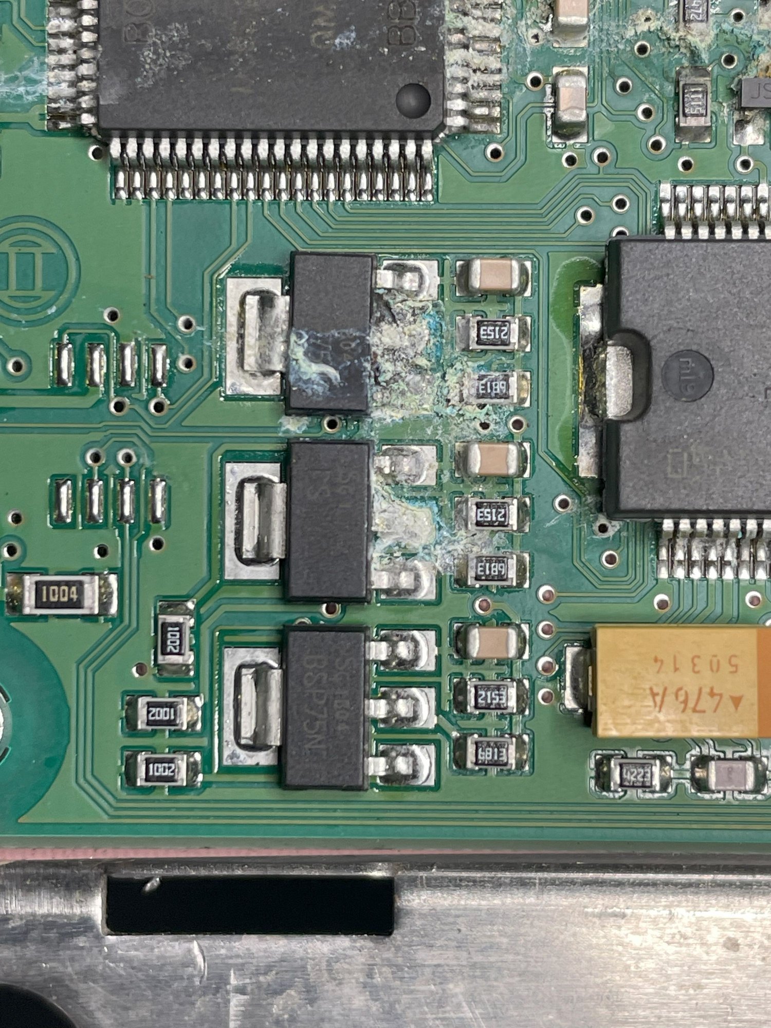

From: Colorado
Well, seems that someone was in the TCCM before me! Maybe the next step is finding one good used TCCM and getting into reprogramming it. Is this something that the GAP tool will do or are we talking the dealer in here?

From: Green Bay, WI
That is a sign of water entry and battery not being properly vented. Your connectors will be equally damaged. You have some work ahead of you. Start with cleaning the connectors and those terminals with vinegar and baking soda. Tooth brush can work well but if the corrosion is bad, things may break off. But if that happens, well it was toast to begin with. That ECO case opens pretty easily by the way. If you replace, just swap and live with a silly code saying there is some sorta VIN mismatch or whatever, but it is nothing to worry about.

From: Green Bay, WI
Oh, and I see what you mean by someone was in there. Nasty dialectic grease should NEVER be on the contacts.

From: Colorado
Upon further inspection. Seems a safe bet to assume that this is the problem, right?

From: Green Bay, WI
No, not a safe best. Safe bet is your issues is all of the corrosion as a whole. Meaning if you cleaned only that you would probably still have issues. Was the battery vent tube hooked up to the battery?
Edit: Also check the hood seal in both corners. Usually one has to modify it to allow it to fit again leaving a gap at the very front center. It shrinks and pulls from the corners letting water get in those areas.
