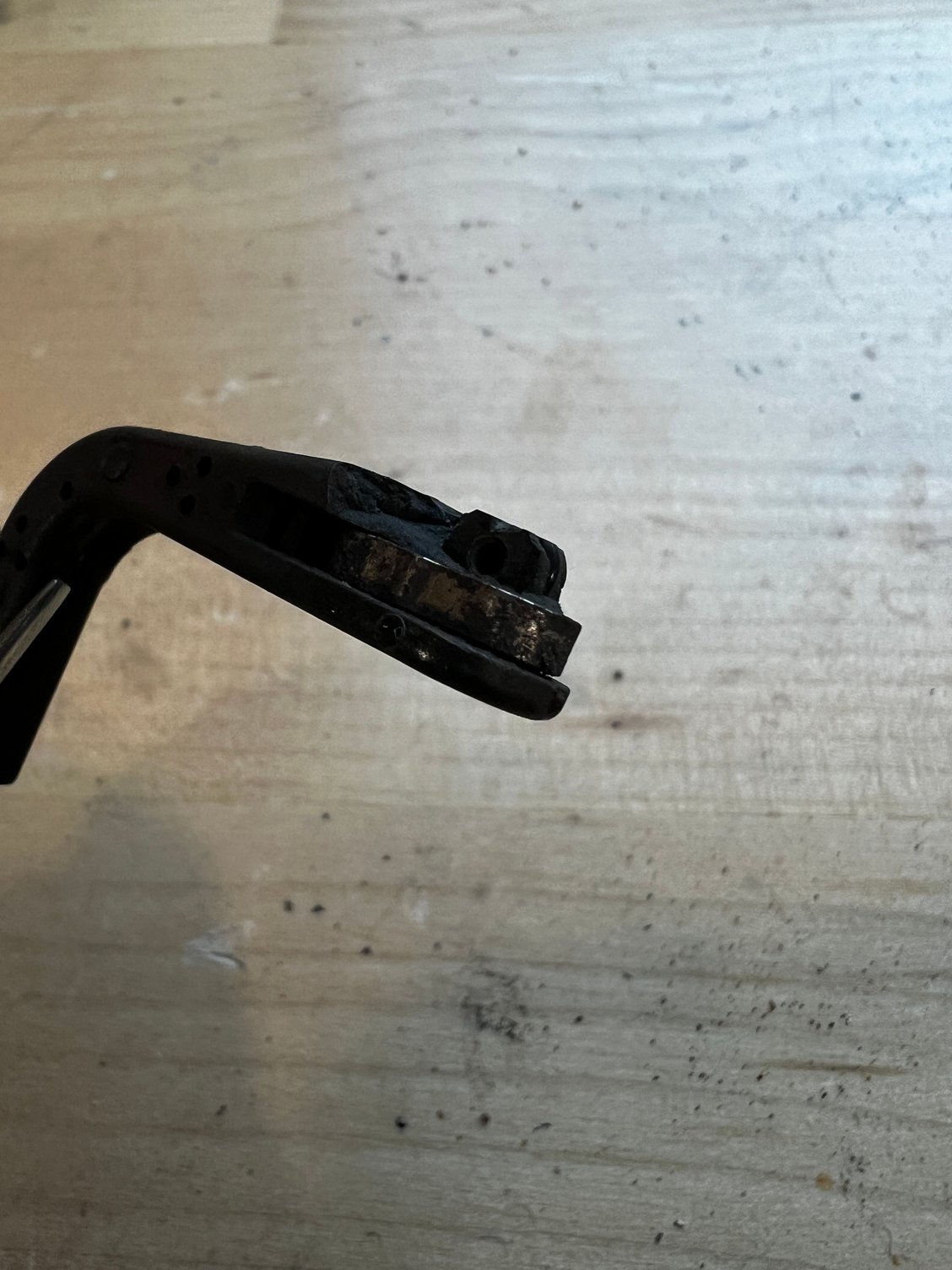

Pulled the front sensor and it’s fine. Hopefully I got it reseated correctly. It’s way harder to reach with the wheel on in off-road height as opposed to on jack stands without the wheel.
Pulled the rear pad sensor and found the problem. Next weekend will be rear replacements for sure.
Here are a couple of photos of the worn sensor in the event someone hasn’t seen one.
It’s been cut off and the wires bonded together to turn off the light.
Rear pad wear sensor. Worn.

I replaced the front one when I did pads and rotors because it was corroded. It wasn’t that hard to pop the liner, run the cable and plug it in. Turned out it wasn’t the one that set the light, it was the rear.
I haven't replaced the rear yet, just cut it off, spliced the wires together to create a circuit and override the light, turning it off again.
