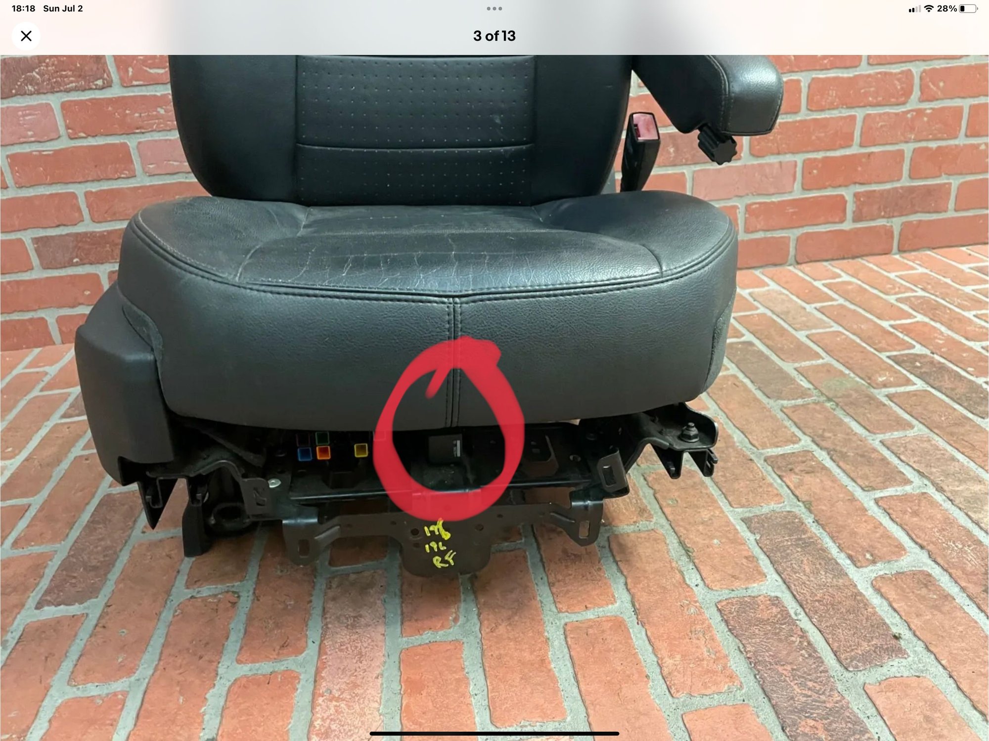

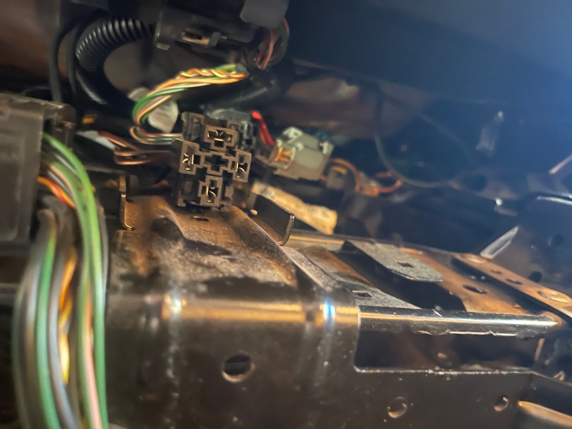

My passenger seat wont move. 05 LR3 HSE. Ive checked the fuses and they are good, so I dug deeper, replaced the power seat switch but that didnt help. Then I looked at all the wiring and had this wiring loom missing a terminal end of some sort. I cant find any info on what relay goes there. I attached a photo of a seat with the missing relay for reference.
My seat frame missing something
What I found looking on eBay for reference.

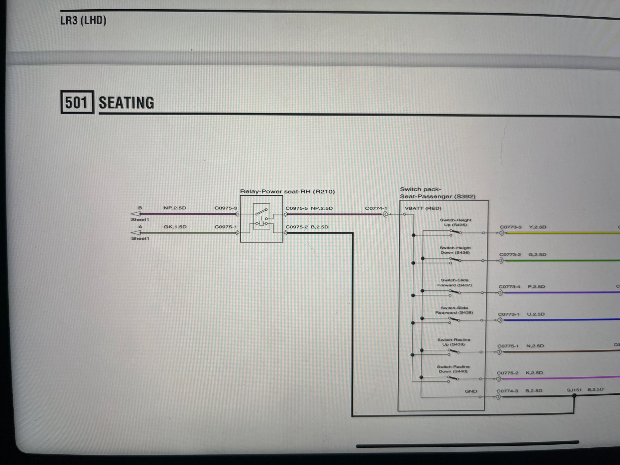

This is the missing relay. R210. Does anyone have any info on what the amps are and part number?

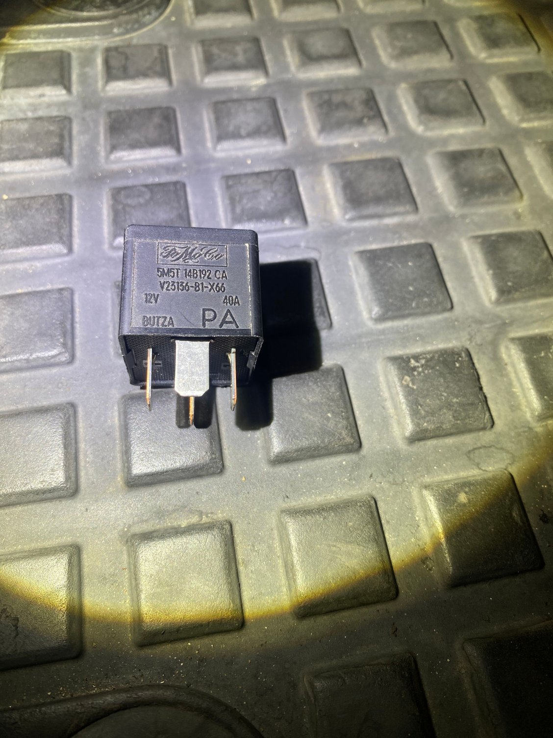

This is from my 06 HSE without heated seats.
Yup thats the one. Can you see if it has a part number or amperage?

Sorry, I thought that number would get it. Here’s the good side:
5M5T 14B192 CA
V23136-B1-X66 40A
Old Jul 3, 2023 | 06:14 PM
RescueDog1's Avatar
Joined: Sep 2022
Posts: 52
Amazing. Thank you so much.
