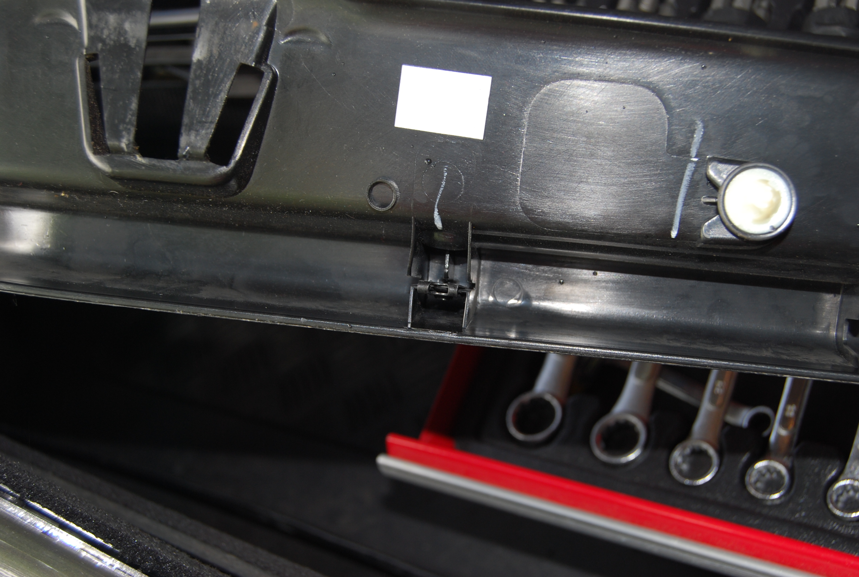

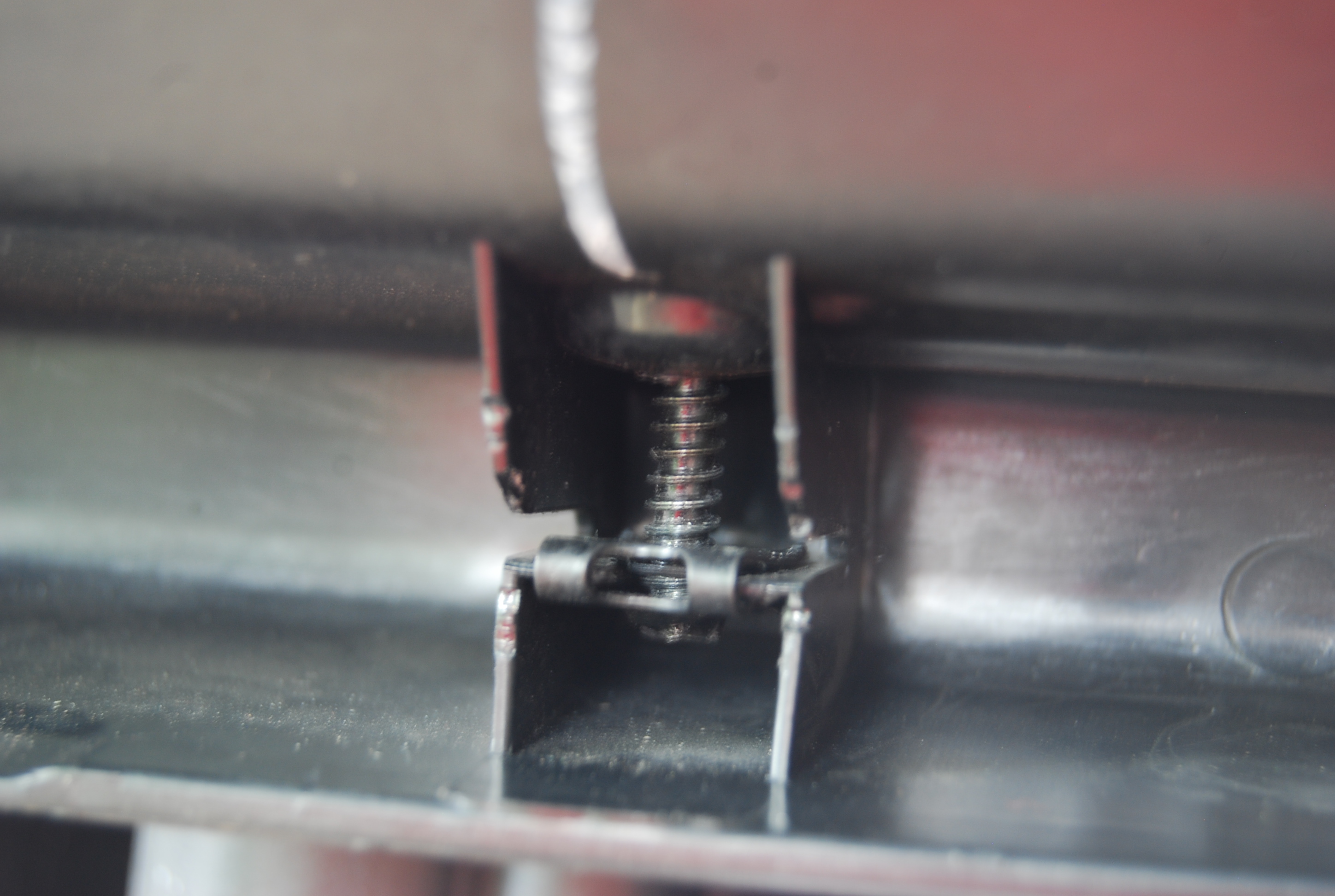

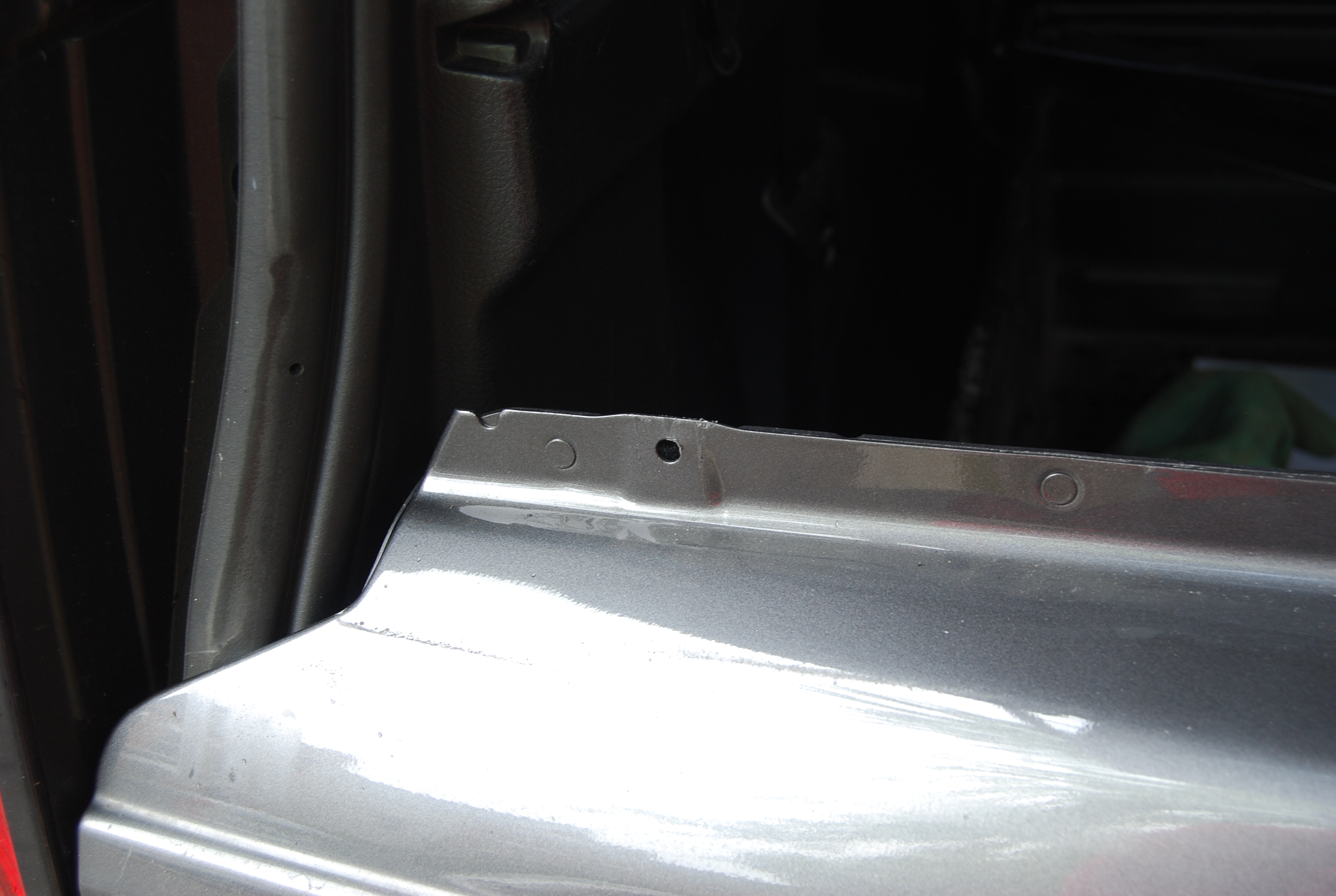

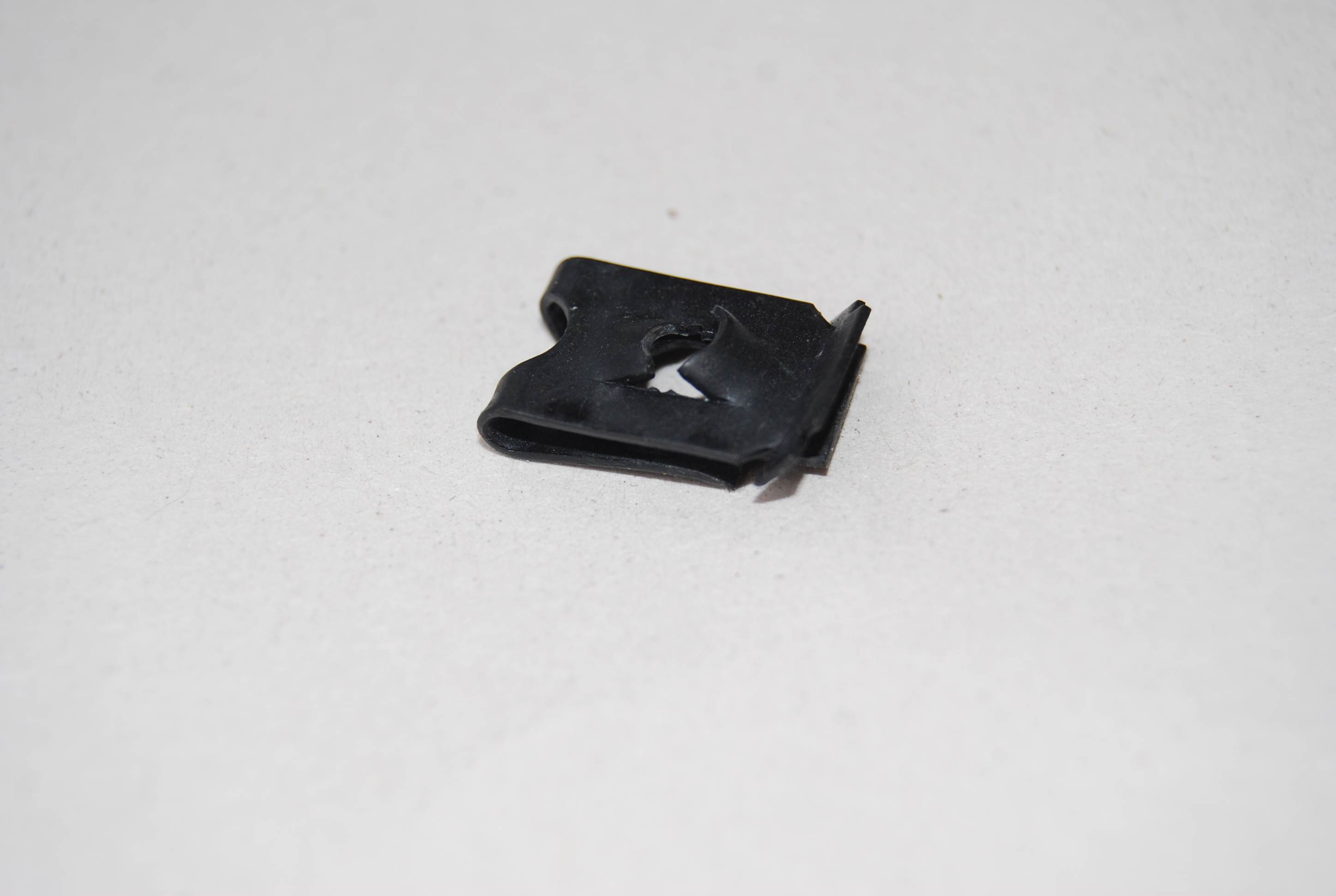

Don't get the ones shown in the last post, they are the wrong ones, I just checked by taking off my trim. These u-clips are what you want; photo 1, they fit in the under side of the trim as photo 2 and when the trim is put in place the clip lines up behind the hole in the door seen in photo 3.
Now when you put the securing screws in they pass through the hole in the door and into the U-clip see photo 4. The U-clips should be available from any good auto store or online and measure 11mm x 17mm.

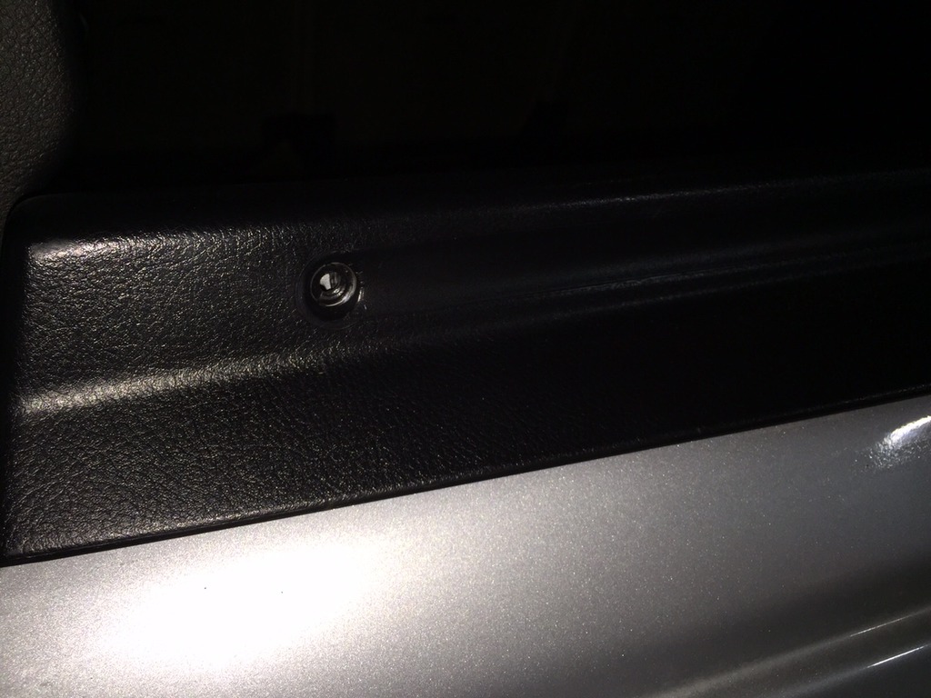

Thanks guys, but I'm actually looking for the rivets that are external to this trim panel. Does this make sense?
Old Jun 5, 2015 | 03:42 PM
Alphamale's Avatar
Posts: 256
Likes: 51
From: Belfast, N. Ireland
They aren't rivets, what you see in your first photo is a plastic screw cap that covers the head of the screw that you see in my 3rd photo. The cap is part no EZU000010PVA and the screw is EYP500250.
