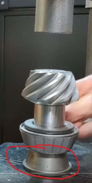

3.) Do you know where I can get the bearing press sleeve (any of them) that is used to press the bearing onto the pinion shaft? I've looked online to no avail, and it seems to be one of the pieces of equipment I'd be missing to do this.

The piece circled in red is an inner race from an old bearing, not any kind of special tool or sleeve. These old parts are often the best because they're perfectly sized and of adequate strength. I use sockets, sleeves from a ball joint press kit, sometimes special tools, but I often end up with creative combinations of parts and pieces from my arsenal of tools and old parts. This is great that you're doing this!
