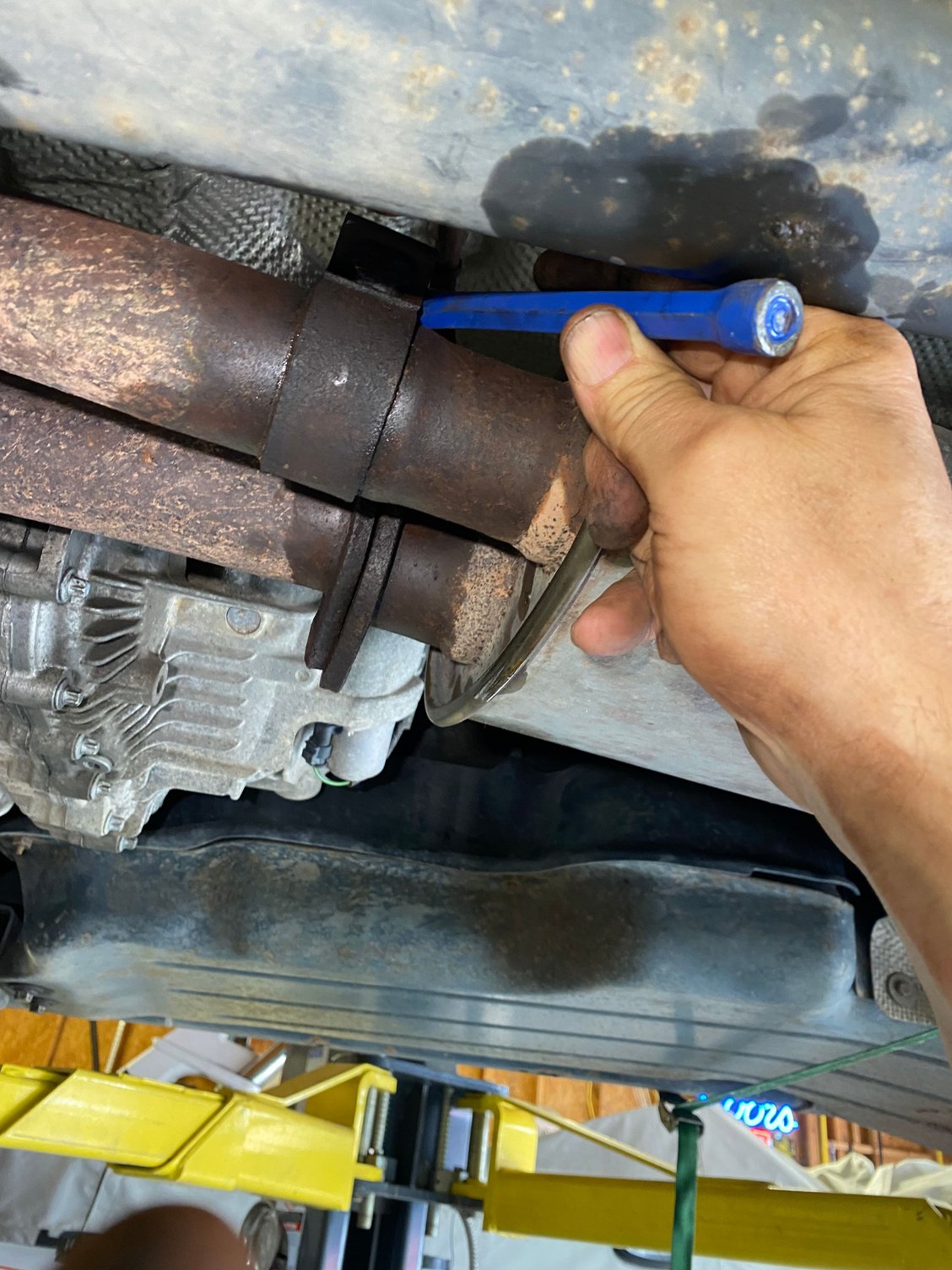

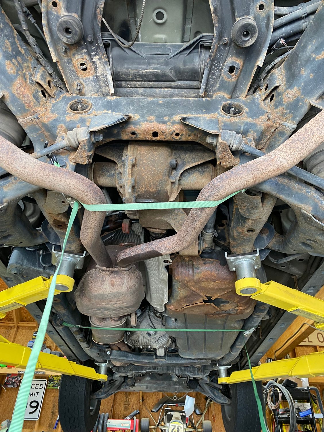

Chisel tap on the clamp after removing the bolt helped free it up.
Tie down straps work to keep the exhaust from crashing down.
Rear exhaust assembly is removed.

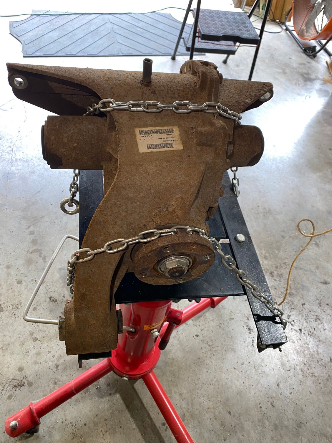

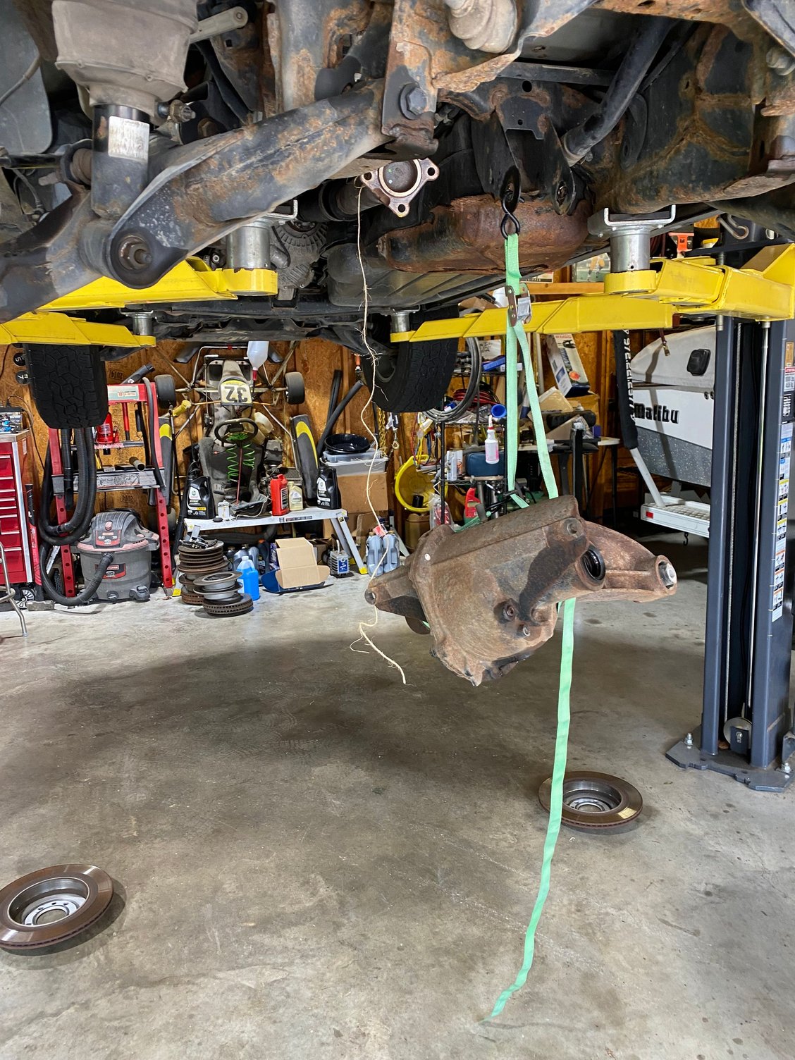

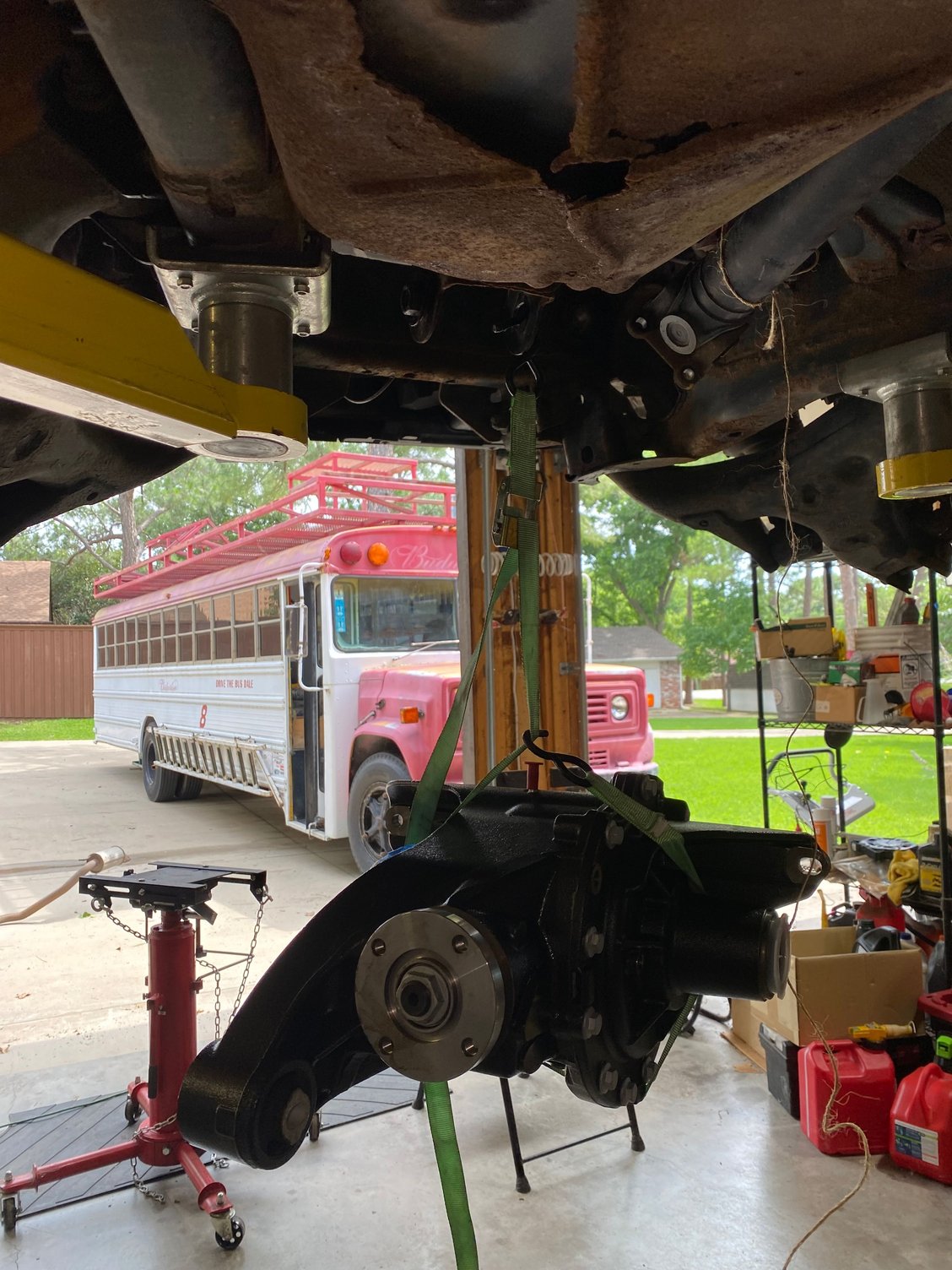

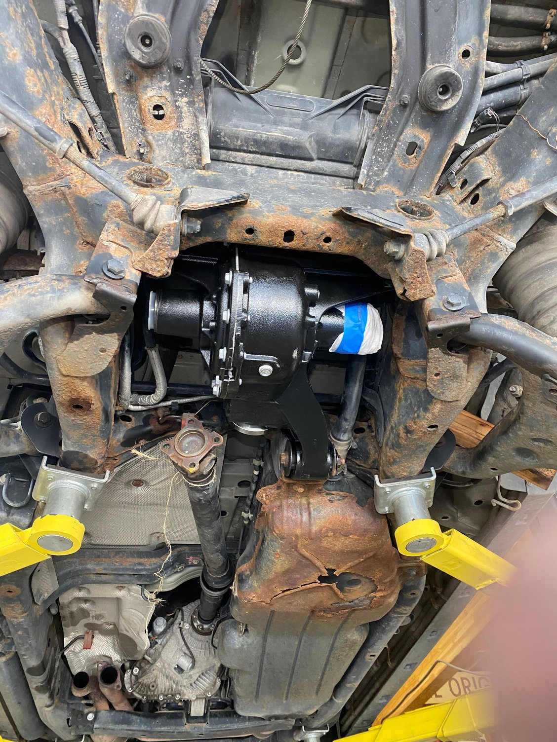

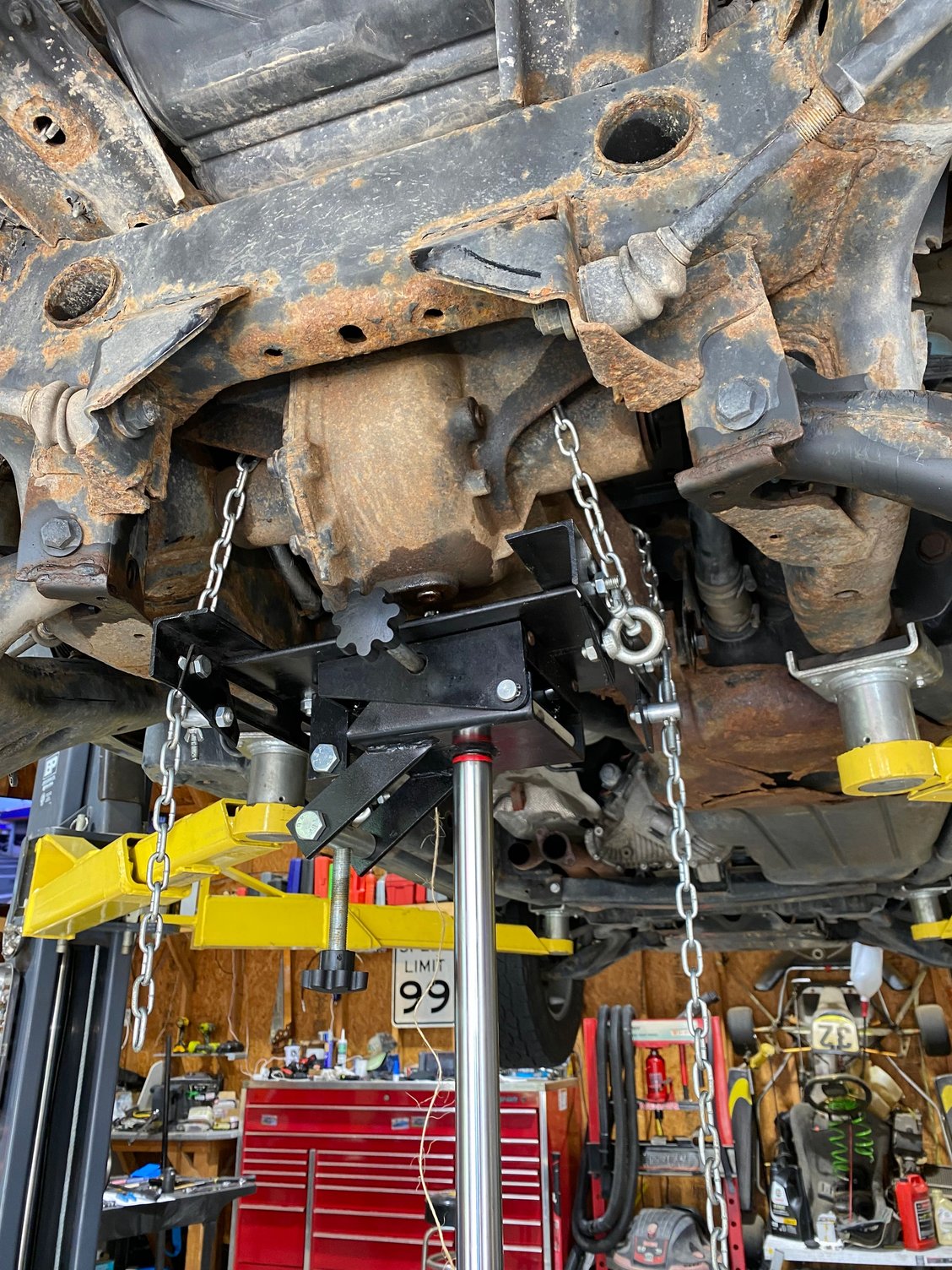

Out with the old, in with the new. It wasn’t as bad as I expected.
Transmission jack worked great.
I hung the diff from the car, removed the trans jack, then lowed the car to set the diff on the ground.
Picked up the new one off the ground the same way.
Plenty more to do to finish this job, but so far so good.

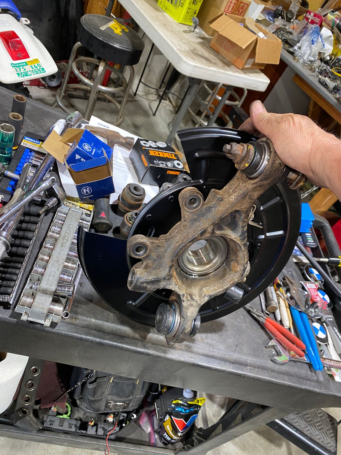

Left-rear knuckle restored.
