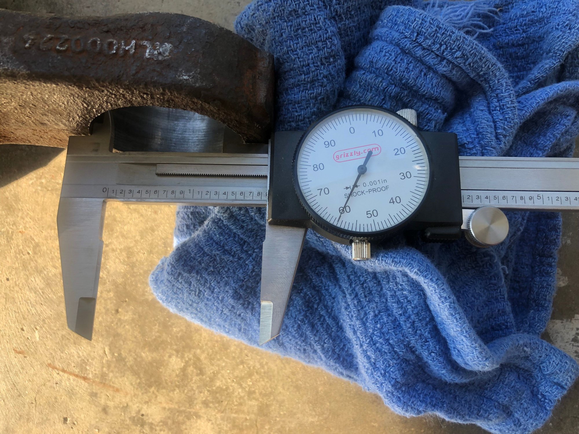

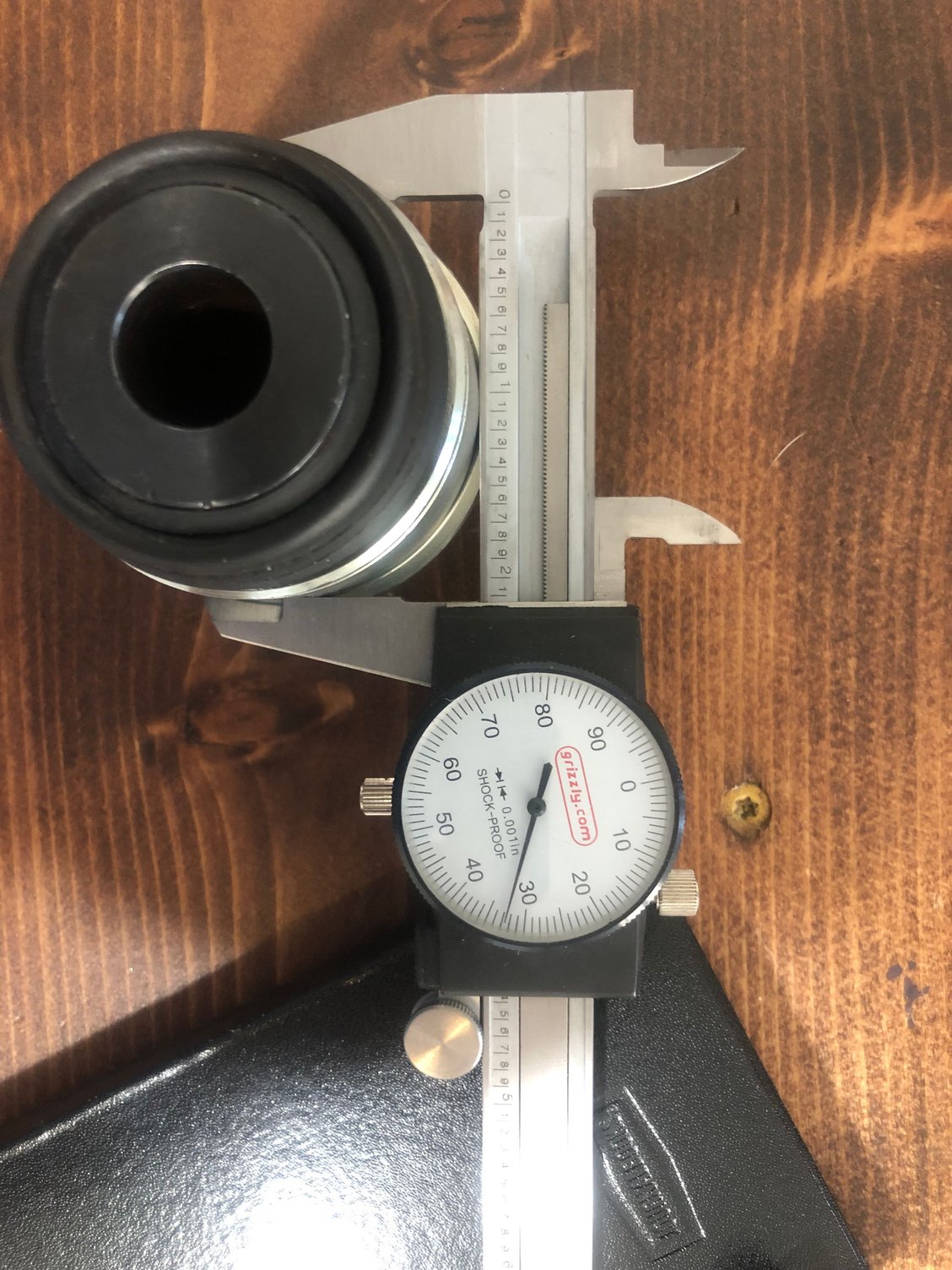

Need Help!! I’m replacing the rear lower knuckle bushing on my 2008 LR3, and the OEM part is too big. The hole is 1.86” and the bushing is 2.133”. Is there something I’m missing? According to the manufacturer it’s the right part.

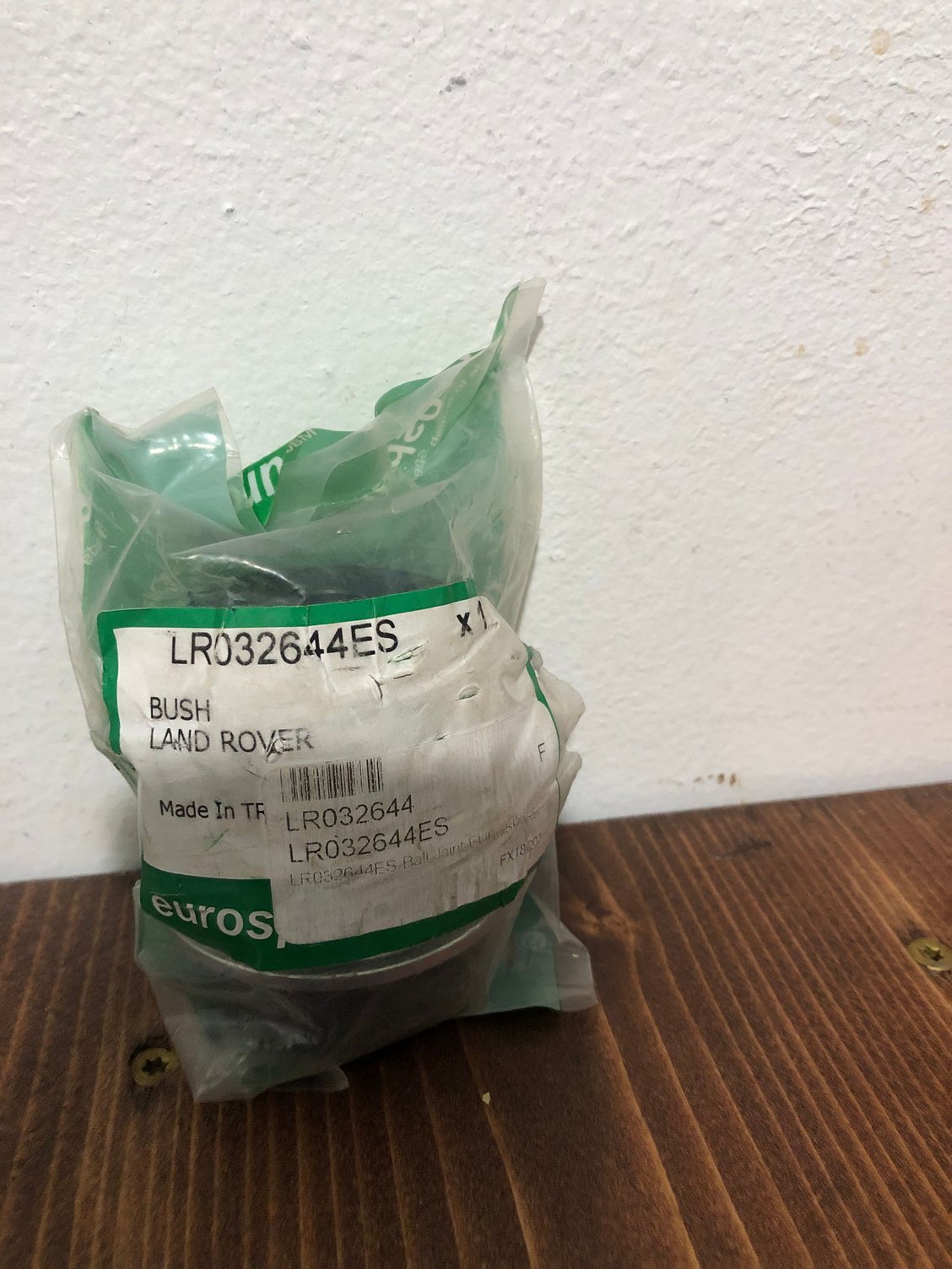

That part number comes up as for an L322 or 2010 + RRS also, wrong part in the bag maybe ?

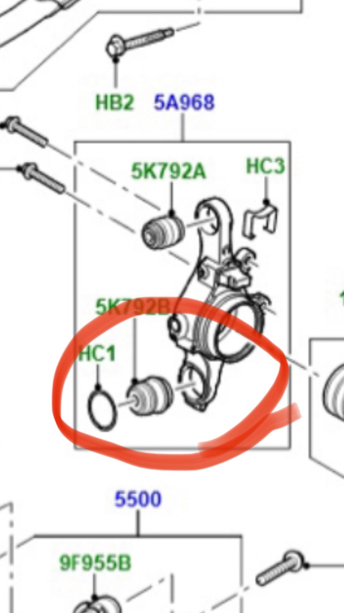

RHF500100 (upper)
RBK500220 (lower)
RYV000010 (c-clip for lower)

Thank you Dakota travler, in reference to part# RBK500220, that is the part I have and is too big (OEM# LR032644)

According to Land Rover that part was superseded by LR032644, supposedly the same…

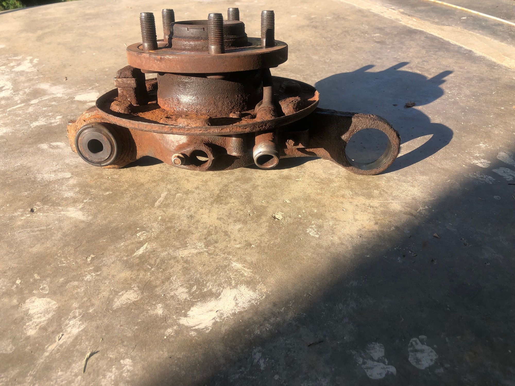

Well which knuckle are you working on? The knuckle you show make me think you are working on the RIGHT side of the truck (as you sit inside). Which means you removed the UPPER bushing but the part you have is for the LOWER bushing.

Contacted the parts dealer, and he has measured the upper and lower bushings, And it seems the bushings are opposite. I have an upper bushing ordered, I’ll try to have them installed by Friday I will post when I found something out. Thank you to everyone for the help.
