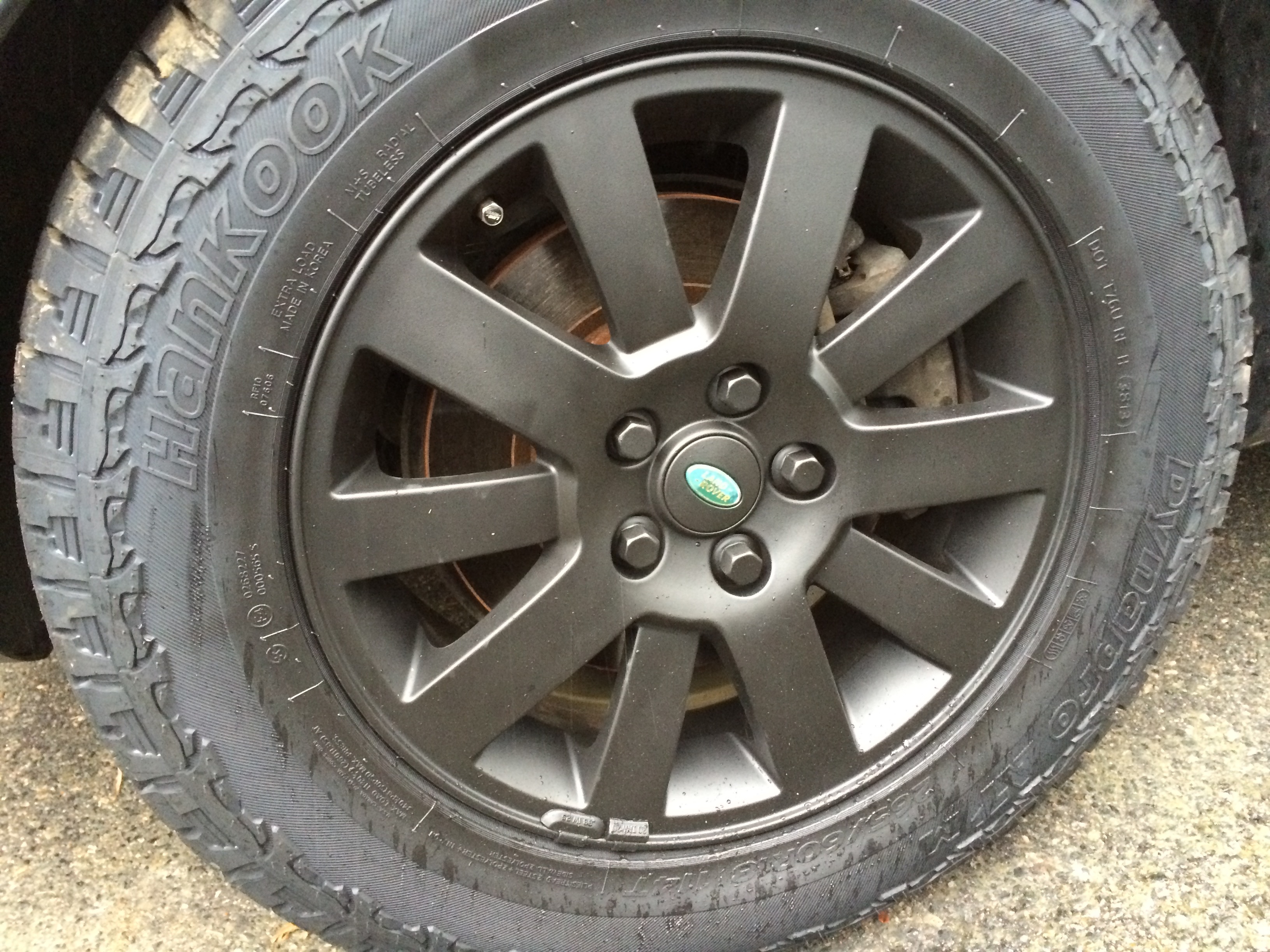

Default Plastidip them :)
why don't you just plastidip the wheels black. Cost me about $20 to do all my wheels. They've lasted so far about 2 years.
Attached Thumbnails Recommendations for Black Rims?-img_5022.jpg   Recommendations for Black Rims?-img_5024.jpg

Was looking at this myself. Is this pretty easy to do?

Yup, I removed whell, scrubbed real good whith wheel acid front and back to get off all the baked on brake dust, dry, mask tire, spray let dry , do several coats, think it was 5-6 cans for 4 rims but I did the entire wheel front and back
Look in my 05 lr3 thread
Think I used the brand from Lowes?
