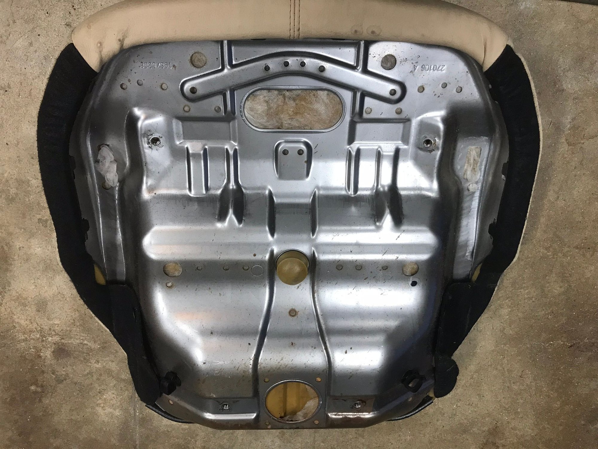

Anyone have a guide for removing the bottom seat cover on the driver’s seat of my 2007? Tried YouTube and couldn’t find anything.

There are five bolts under the plastic covers. The covers pry up except front inside cover prays inwards. T50 torx I think
Use 7 mm socket to disconnect the main seat connector.
Tip seat backwards. Disconnect the seat connector from the frame by levering up the small plastic bit under the connector and sliding the connector to the front. You’ll need access to the back of the plug if you have heated seats.
Remove 4 smaller torx bolts the attach the pan to the seat. I think you’ll need to remove the plate (Four screws there) in the front that the main connector attaches to so that you can get to the front bolts.
The 4 seatpan torx are smaller like t25 or so.
May need to pull connector for heated seats from main connector. There’s a tab you lever to the side and pull the connector back.
I haven’t tried to pull the seat cover off, but I do remember plastic tabs that went into the metal pan. These are just photos on my iPad, but will give you an idea what I’m talking about....first time doesn’t take long. Gets easier the more times you do it!

Outstanding! Thanks for the assist.
