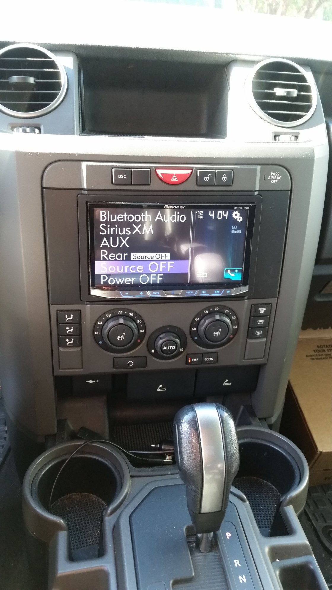

I picked up my first LR3 this summer. The PO told me that the OEM radio had gone south, and so he replaced it with a Pioneer touch-screen unit (AVH-4200NEX). That is supposed to support Android Auto, but I've not been able to get that functionality to work yet (haven't tried too hard, though). He had an iPhone and said it worked great with that. I did use the Sirius satellite radio that he'd paid for for the first couple weeks, so I know that works. I think the system looks pretty good as installed (attached a photo so you can be the judge).
I haven't noticed anything acting up in connection with it, though the statement by ArmyRover about losing a clock on the dash makes me wonder...I don't have a clock on my dash - it shows up on the AVH-4200NEX screen instead. If you want, I can dig around and see if I can find out where he had the work done...maybe it's a standard install for one of the usual car stereo places?
One nice thing about the AVH-4200NEX is that there's an add-on unit (AVIC-U280) that adds Nav functionality. I'm probably going to get that, since mine didn't come with the Nav screen in the cubby. This could be a good alternative for those who would like to install aftermarket (or even OEM) Nav in a rig that didn't come with it.

The '05 SE I picked up this summer came with a touch screen unit that replaced the original radio (PO had to replace the radio because it went south). I need to re-flash the ECU with my iid tool to see if I can get the dash clock feature to work, but right now, the clock only shows up on the radio. However, since it's an '05, that might have been the case even before the aftermarket unit was installed. This particular aftermarket unit (details in my signature) apparently easily accommodates front and back cameras, and it also supports Android Auto and the iphone equivalent. That said, I'm still working on connectivity to my Android - at present, I can talk through the mic and hear through the speakers, but the Android Auto interface is only working on the phone screen, not the screen for the head unit. I think the issue has to do with which USB port is being used for the cable that the phone plugs into. Apparently, only one of the two USB ports on the back of the device will work with an Android, but both work for an iphone (and the PO was an iphone guy). There's also an add-on Nav unit that can connect to the head unit, so I'm thinking this may be a good workaround for me (and others) with rigs that didn't come with OEM Nav. Saving my pennies to give it a try. Photo of unit in dash is posted below.

For the Pioneer, Androids can only use the 2nd USB port, but iphones can use either. Since the PO was an iphone user, I suspect that the input is going to the wrong port. I'll try to get in there soon and find out. As far as the canbus acting up, are there symptoms to watch for?
