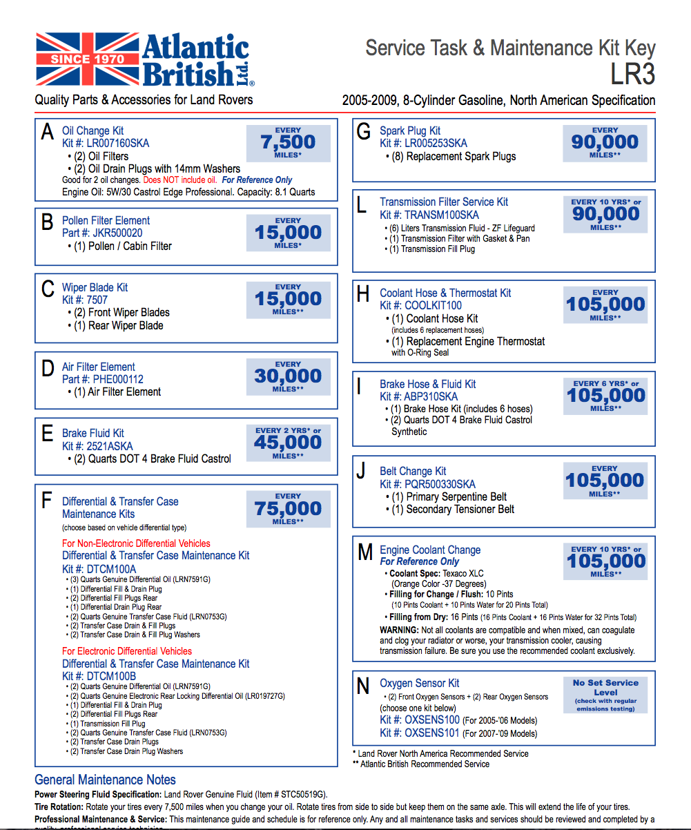

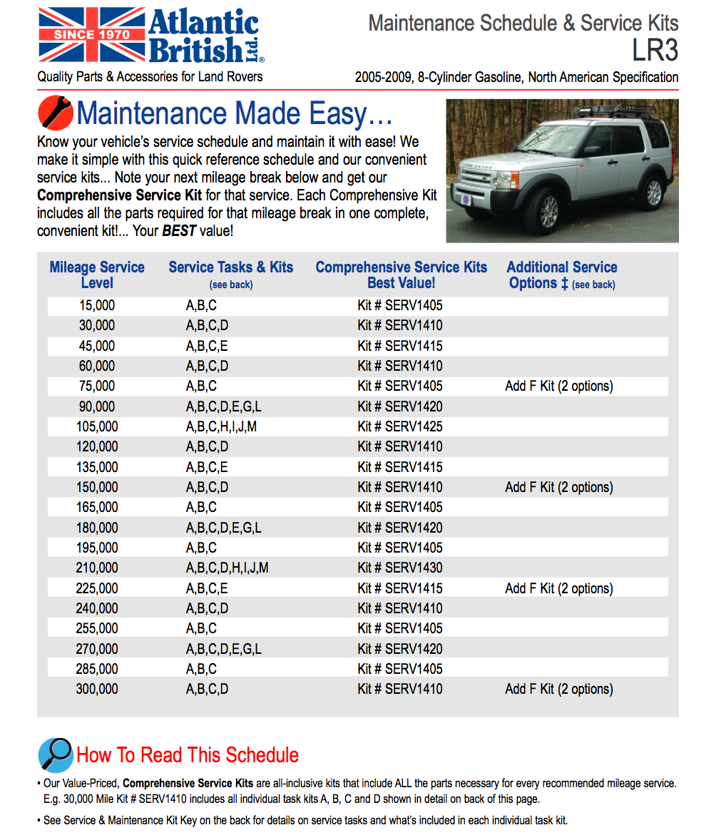

I would save the money and use half of the $890.00 to buy a 2d tool. With the tool you can update/flash install software plus hundreds of other things. Look at the attached service docs for what needs to be done for the 90,000
maintenance. Hope this helps.

I would probably do it as long as it includes the spark plugs. 90K is a pretty big one and $840 doesn't sound out of bed. Sure you can do it yourself for cheaper if you have the capacity. I don't have the space, tools or patience.
...Also, maybe they can give you a break on a tranny fluid change. They throw that in and wrap it all up for <$1000 and I'm in. $999 and I'm doing it.

I'm with noob up there. I've not had good experiences at the dealer but have had good luck with independent. Once you've found your favorite independent, you'll be happy. I don't think the price sounds out of line, but it depends on what exactly it includes.
The belts are due at 95k, transmission was due about now. Transfer case and diffs-- do them regardless, inspect the oil.
