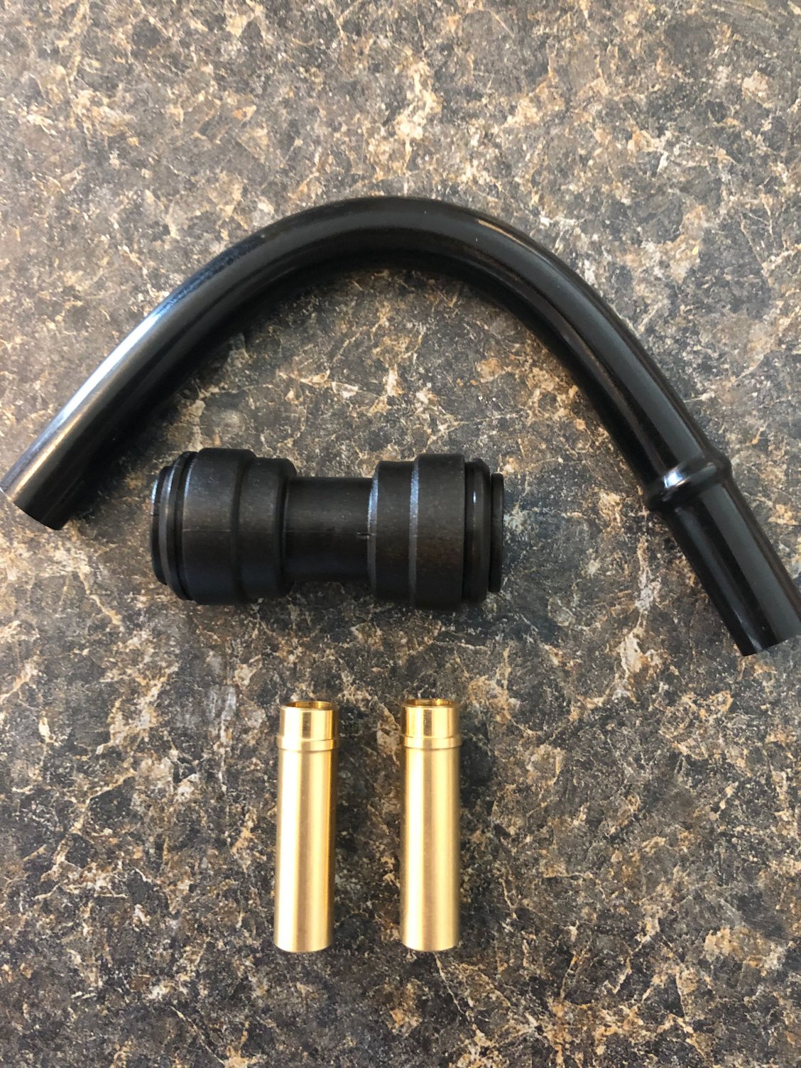

Ok, the repair kit arrived. On the hose, there is a flange on one end. My guess is this is the end that goes into the pump. Then the other end attaches to the coupler while the end of the current hose attaches to the opposite end.

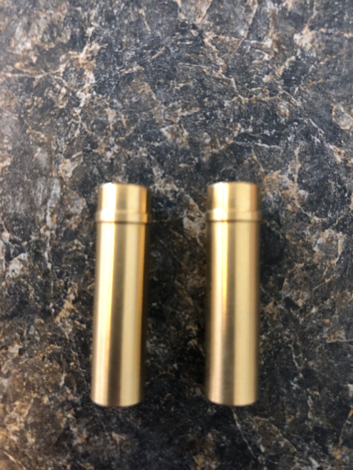

There are also brass inserts. My guess is one end goes into the flanged end of the hose that goes into the pump. But the brass fittings also have a flange. Does the flanged side on the fitting insert into the hose first or the other end first? What about the second brass fitting? Does this go into the opposite end of the replacement hose portion or into the hose that is left on the rover.
Then there is cutting to new hose to size and cutting off the damaged part of the remaining hose on the rover. What is the best way to do this? Pruning shears? Hack saw!

You dont need the inserts really. They do NOT go to the compresor end but to the coupling end. They just ensure the hose is true to round. But I never found a need to use them.
