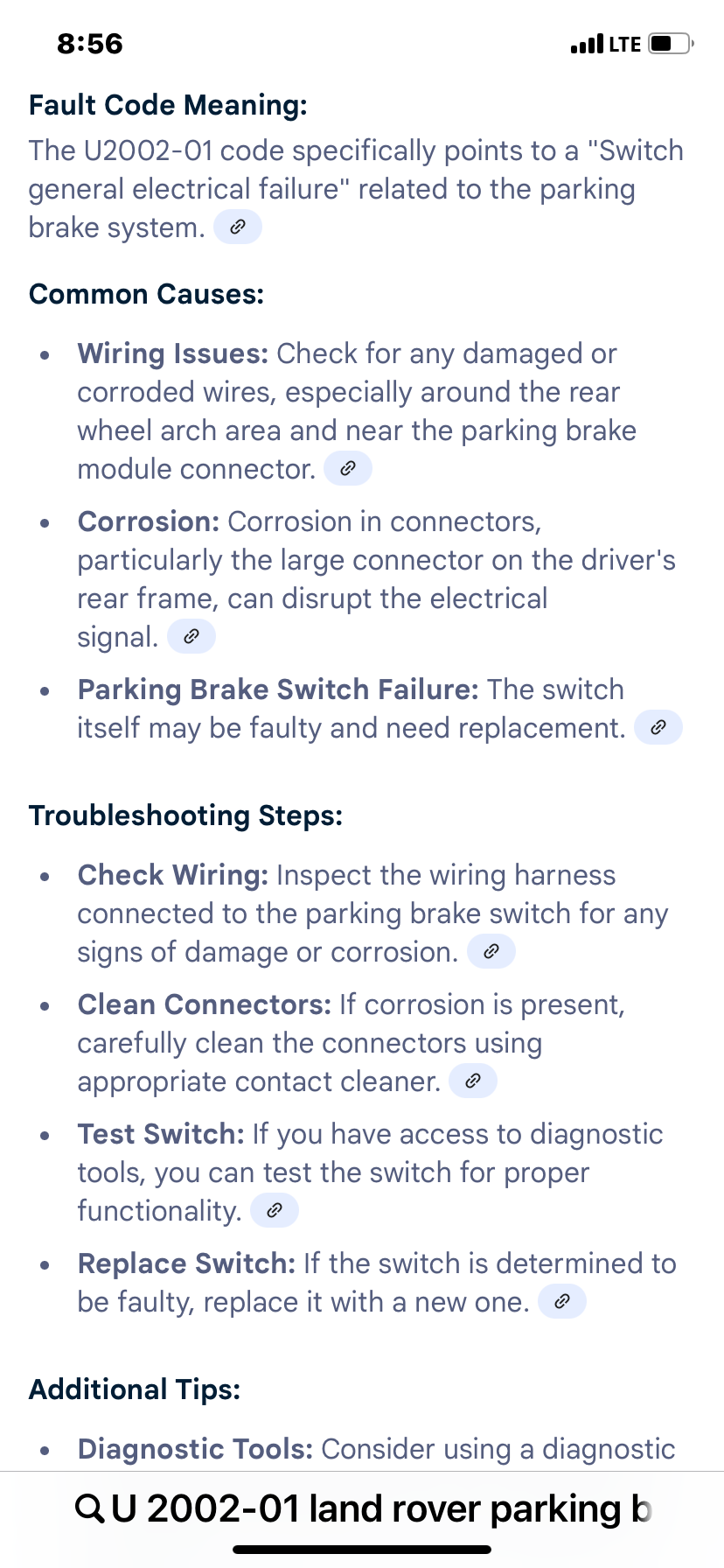

I’ve got a 2005 LR3 that unfortunately had some clogged roof drains the tail end of last year and I had tarped it for the winter, but somehow some water still got in and then we had some back to back storms in the Midwest where it was raining sideways. Finally got a clear day and I discovered mold high and low with soaked carpets. After much fighting and trying and pulling the mold is gone but when I’ve had to move it the parking brake system has gone haywire. I’ve lost my security control module so I have to manually lock and unlock the vehicle — but I can’t see anywhere that the water coming in the moonroofs would cause damage to the parking brake module. I clear the codes with my GAAP device and it comes back immediately.

The EPB wires come to the CJB… and your water leak was (possibly) pretty much directly above it. If you suspect wiring, test for continuity. If the code pops back constantly you might want to share which one it is.

Ignore Passive ignition relay code, almost everyone has it and Land Rover never figured iut hiw to eliminate it. Second code could be the little parking brake sounder speaker, located between pillar C and D on the driver side or faulty parking sensor.
Third code could mean faulty Brake Light Switch, easy enough to replace, but could also mean damaged wiring behind rear driver wheel on the chassis, right by the air strut.

Okay! Last double post from me unless I am posting an update. I posted the following in another thread to follow up with other folks that were helping out.
Just a little more information on the below, I was able to pull around the block, but the suspension kept lowering due to the fault codes from the AB Brake Switch, previously I couldn't move it 10 ft without the parking brake engaging so we're making great progress. Went ahead and hit everything with stop rust and let the air mover dry it.,. Vehicle is parked with a canopy over it just incase a rogue thunderstorm decides to wash me down stream again.
So I actually have some good news, I've got the Brake Switch showing up now as seen in my print out below. No more Parking Brake Failure.
And my key fob works for the first time in my entire ownership of the vehicle. It was a Kodak moment when I hit the fob and the lights flashed, absolutely thrilled.
So fingers crossed when the brake light switch comes in on Wednesday I will be able to get that swapped out and we should be back in business.
Hell the sound that I used to get under acceleration is gone now too from when I took it around the block.
I'm going to take tomorrow and pull the headliner and run all new tubes for the drains, I picked up 50ft of 3/8 hose with 1/2 push to connect fittings instead of a barb connector.
Thank you for the information on the center console because I do have an issue where the down leaver on my height adjustment doesn't work and I figured it would be something like that after I got to playing with it earlier.
I greatly appreciate the efforts and input everyone. I'm gonna jump back to my other thread and chronicle the remainder of this journey.
