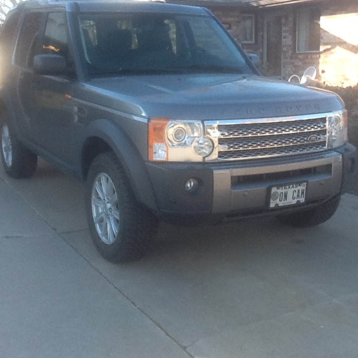

I have those falkens in the 265's. I really like them a lot . They have great road manners, not a bunch of tire drone. Here in Kansas dirt roads are just that, they aren't gravel roads. They have great traction on those muddy dirt roads. They aren't mud tires , but they are better than other A/T tires I've had. They won't rub even in access mode
