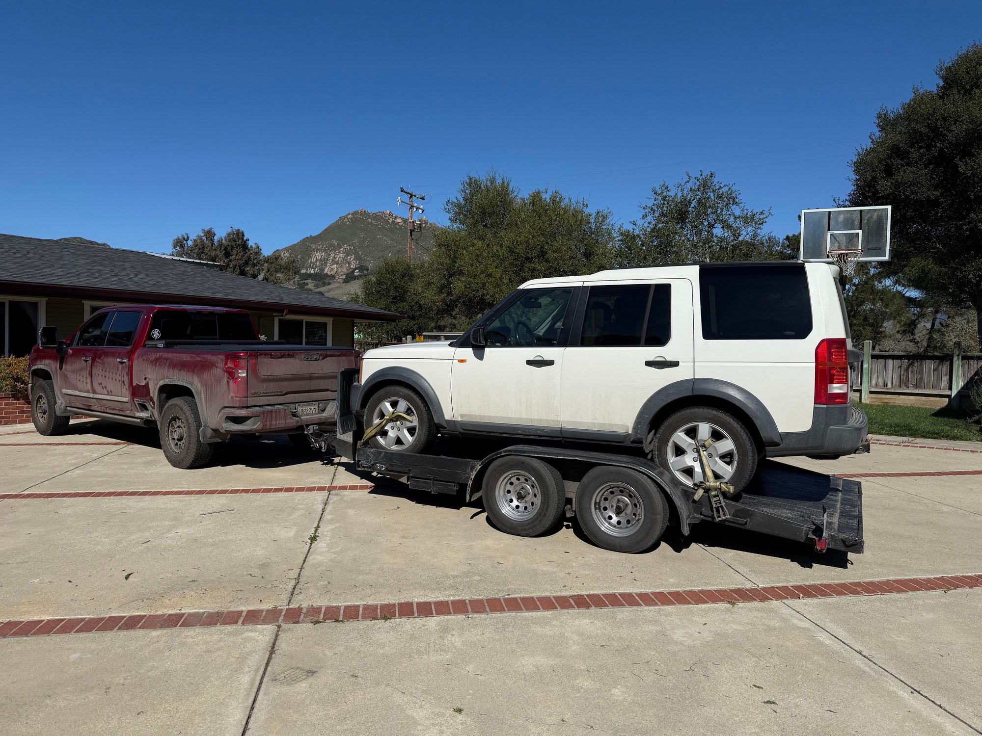

The Drive up
The Drive up
My son's LR3 has been in Montana for three years now. It's having issues that shop can figure out. They did a new altinator and Fuse box because of carosion on the board because of a sunroof leak.
