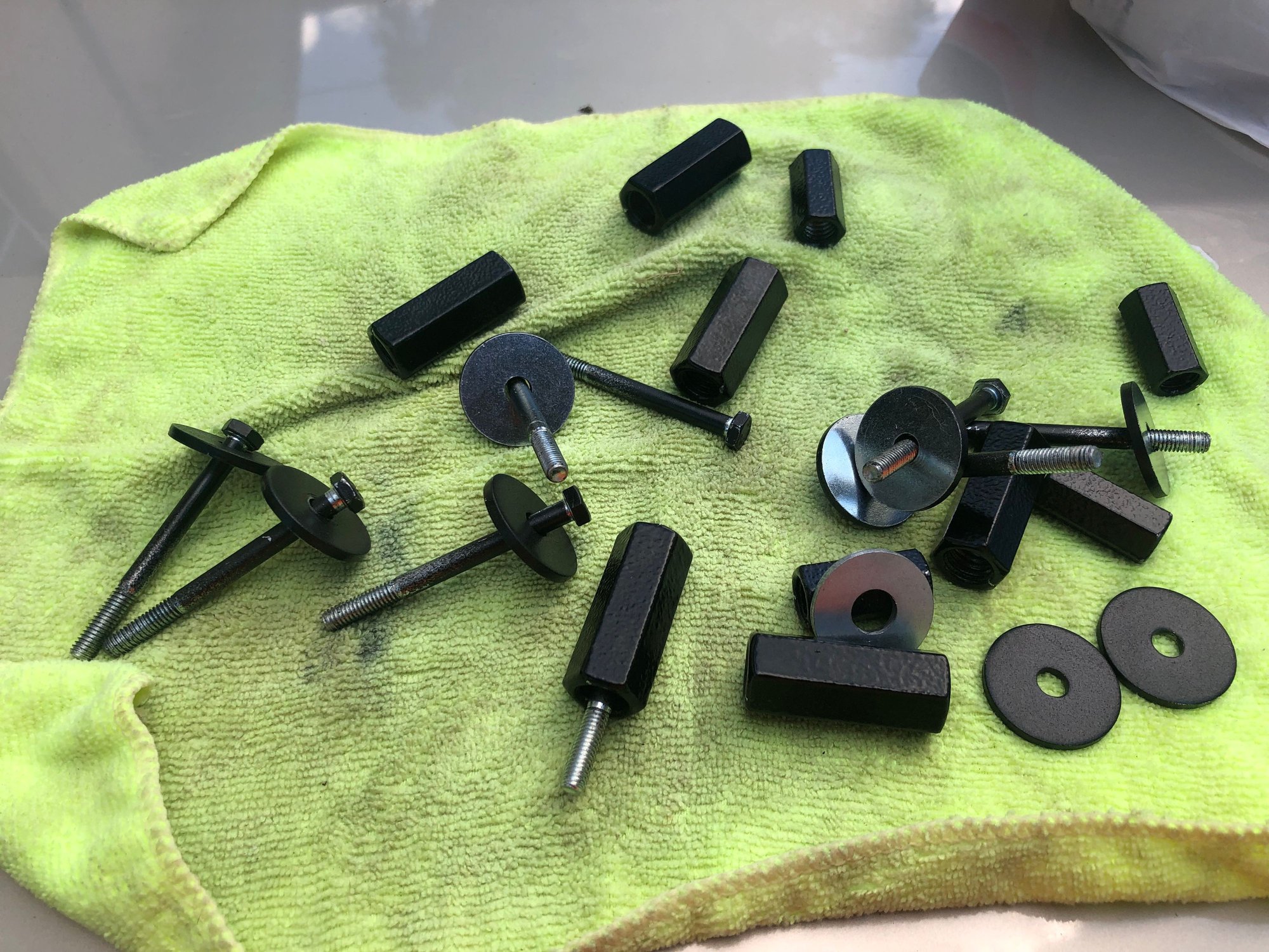

The hardware provided is complete crap. It does not help there are no directions at all and of course you can not reach anyone at Voyager. After my friend and I racked our brains and watched a video we *thought* we had it. So we secure the back six mounts only to find the forward mounts are too high up from the truck, so nothing will work. Also the sunroof at full open hits the rack even with it pulled all the way back. We used these short couplers they provide for the back six mount locations. If you use the larger couplers, there is not enough thread available on the bolts to get through the rail and into the body mounts. They give you six small and short ones and eight tall, thicker ones. Figured six short o the back and use two larger at the front mounts. The couplers are coated in black, very nicely. But the rest of the hardware I painted. As far as we can tell, the rails stay in place. They even ask when ordering if there are rails installed. Another issue is the couplers have such a huge ID that they float around the bolts a lot, so much so that the couplers can get caught at odd angels in the openings of the eyelets. So when set, they can be uneven. I have to think that maybe one is to enlarge the rail's upper holes (that normally have the small plastic cap) to allow the couplers to drop down further. But without knowing, I did not want to drill my rails.
So I decided to just shop around for a better solution. I used M6x1.0 threaded rods in all locations. Small amount of lock-tite. Then I dropped a 1 inch steel sleeve into the rod. This sleeve is small enough to get past the first opening in the roof rail (plastic cap) and then rest on the lower part to secure the rail down to the roof itself. Above the sleeve I put a M6 flange nut and then a rather hard to find thick fender washer. You need to use thick fender washers. I managed to find some that were slightly smaller than the ones provided with the rack, this allows more movement to adjust the rack around. At top to secure the rack down I used another thick fender washer and a nylon nut. For the two months up front I used a threaded rod and two couplers. A small thin washer at the bottom and at top of the couplers another larger thick fender washer. (for those that dont know, fender washers are generally larger washers with a much smaller inside diameter. So they fit onto the bolt well but have a large surface area).
I still have no clue how to use the hardware provided in a way that would be safe. We even used more washers to prevent the couplers from wanting to pull up into the rack eyelets. That just reduced thread length for mounting and still resulted in the sunroof contact issue.

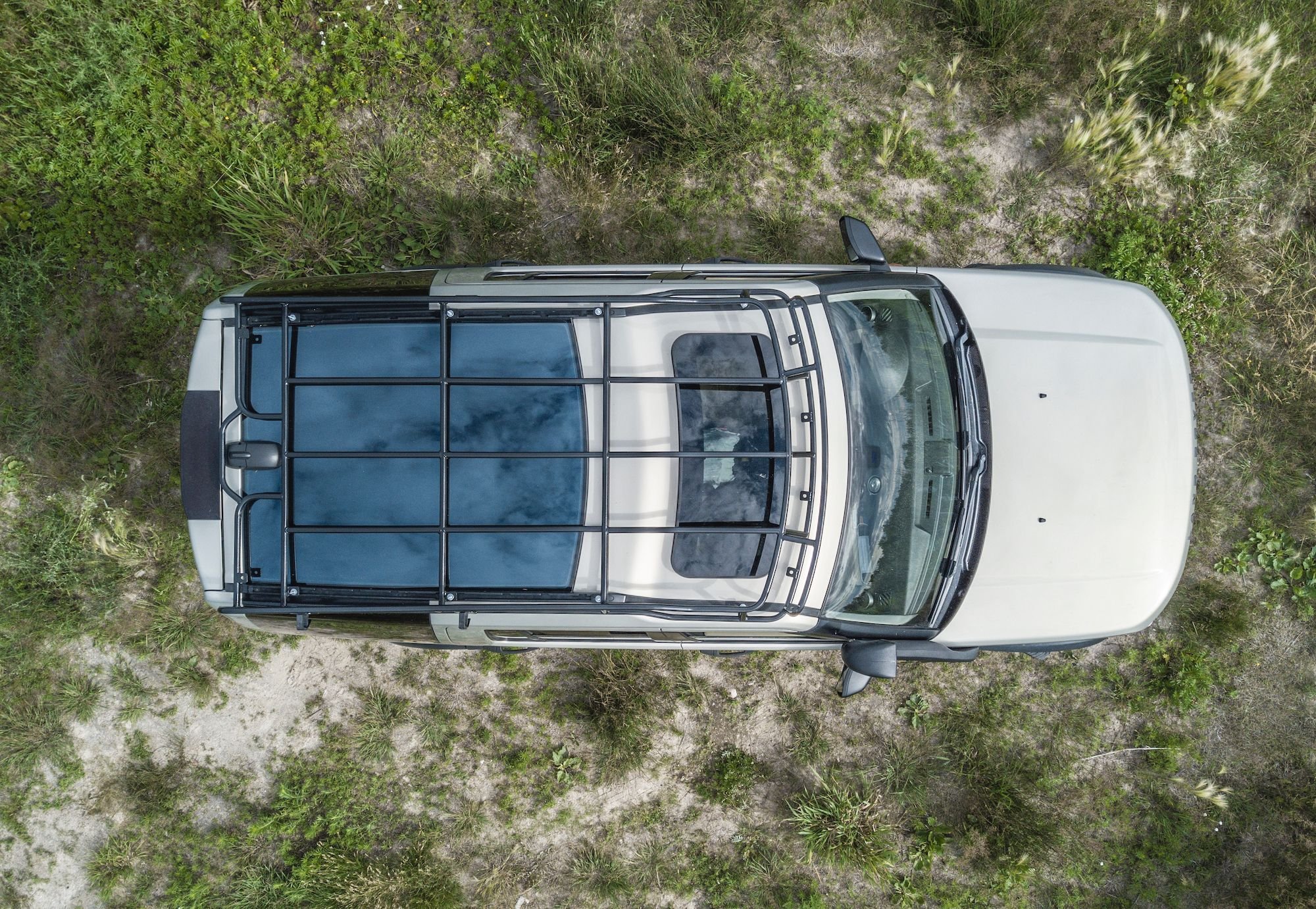

A few pics of the rack installed.
