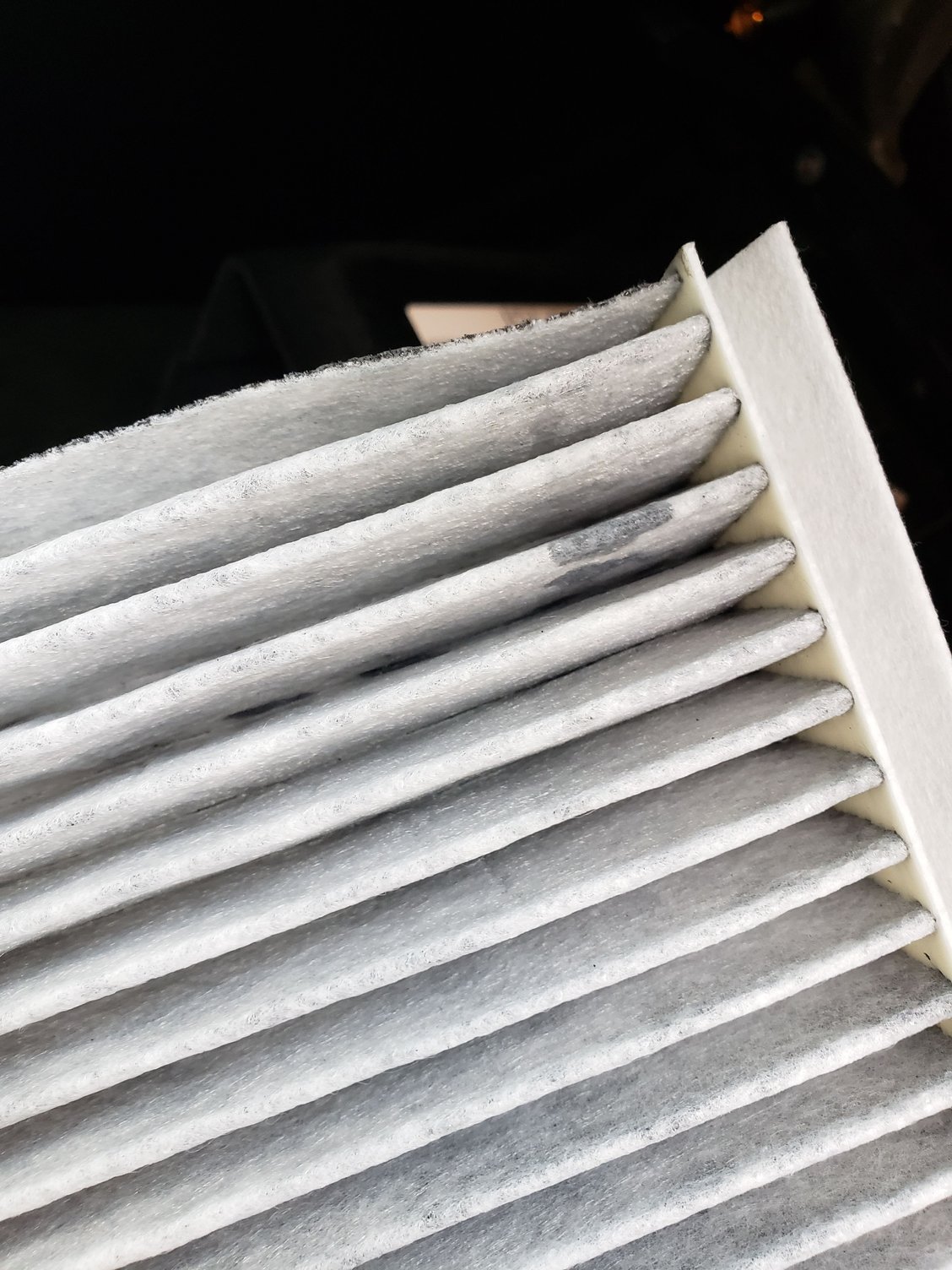

Recently bought an lr3 and it decided to rain last night. California rain so it wasn't even much. However, as I dreaded throughout the night I awoke to water in the cabin. I think I was able to diagnose the water on the passenger side, after removing the air cabin filter I saw water in it. So I knew it couldn't have been the drain from the sunroof. Sure enough my cowling was old and warped. I have pictures of my diagnosis as well. What do you guys think?

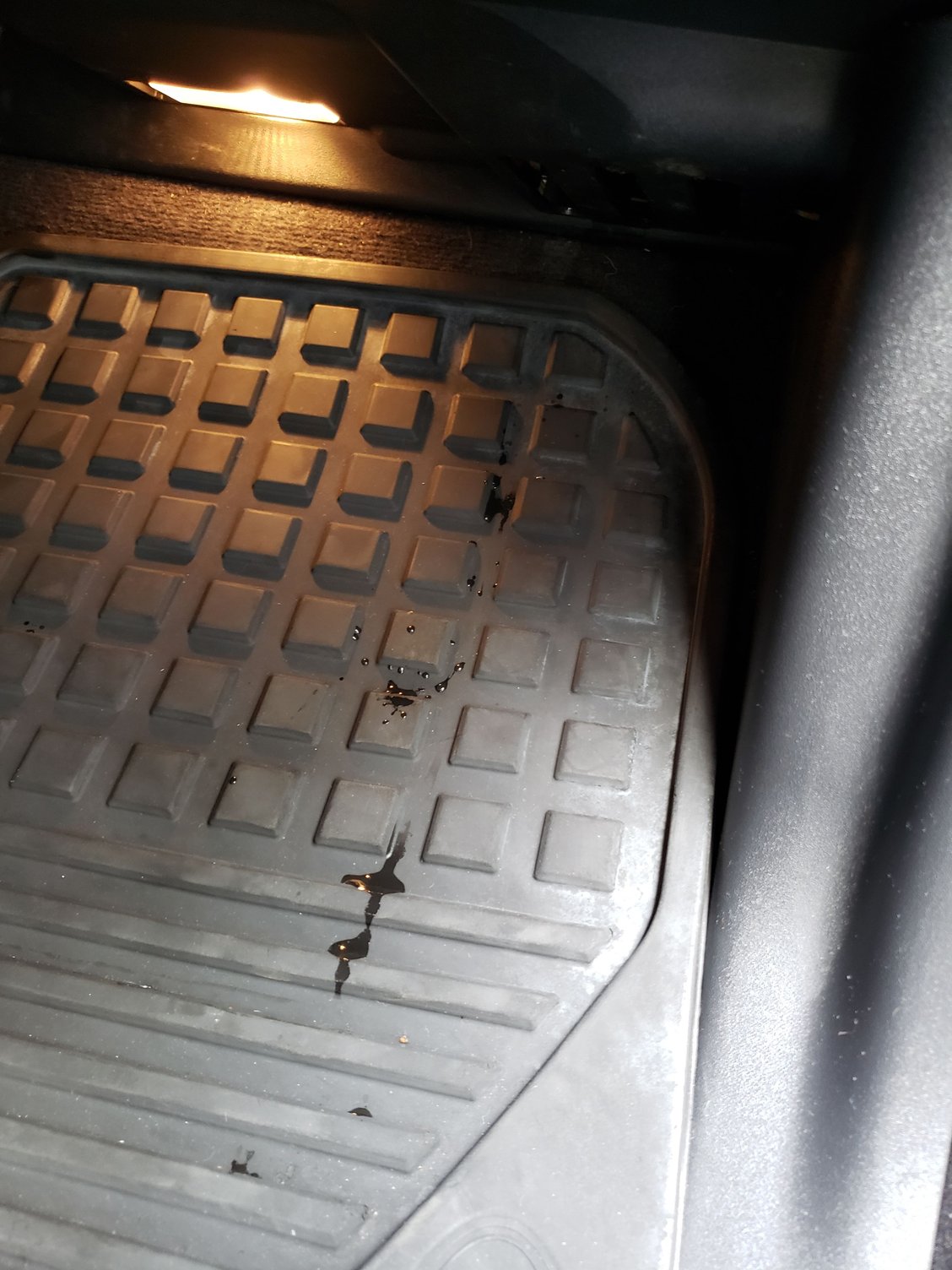

Drips I first noticed.

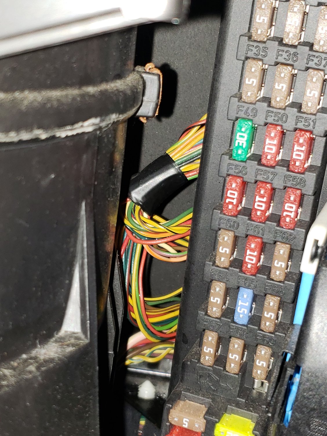

There was water dripping from the side of the filter housing onto that wiring harness in the back.

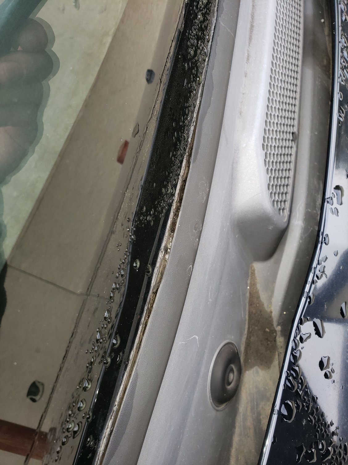

Warped cowiling. Any advise on how to properly seal it after buying a new one?

Definitely a warped cowl issue.. replace cowl, add a shield on the pollen filter intake, and while your at it, try to clear out sunroof drain tubes by blowing air on it or snaking it with trimmer line
