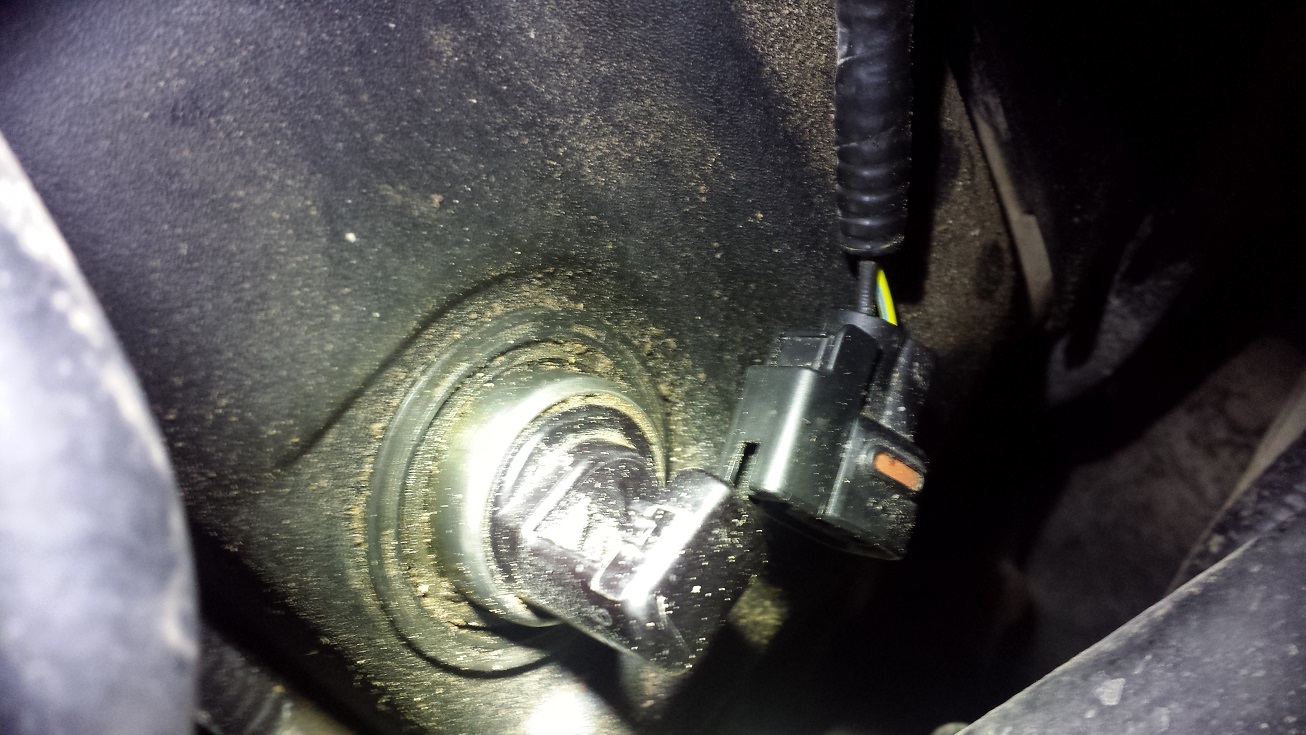

I noticed a little oil dipping from this sensor, on the driver side of the engine.
I've looked up shop manual but didn't find what it is.
I think the rubber O ring is bad, but looks like it's hard to remove. Is the dipping something I can ignore?

The variable camshaft timing ( VCT) oil solenoid electrical connector.

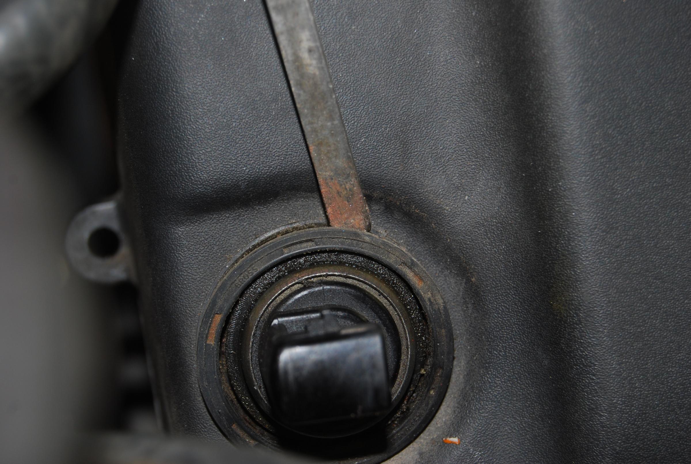

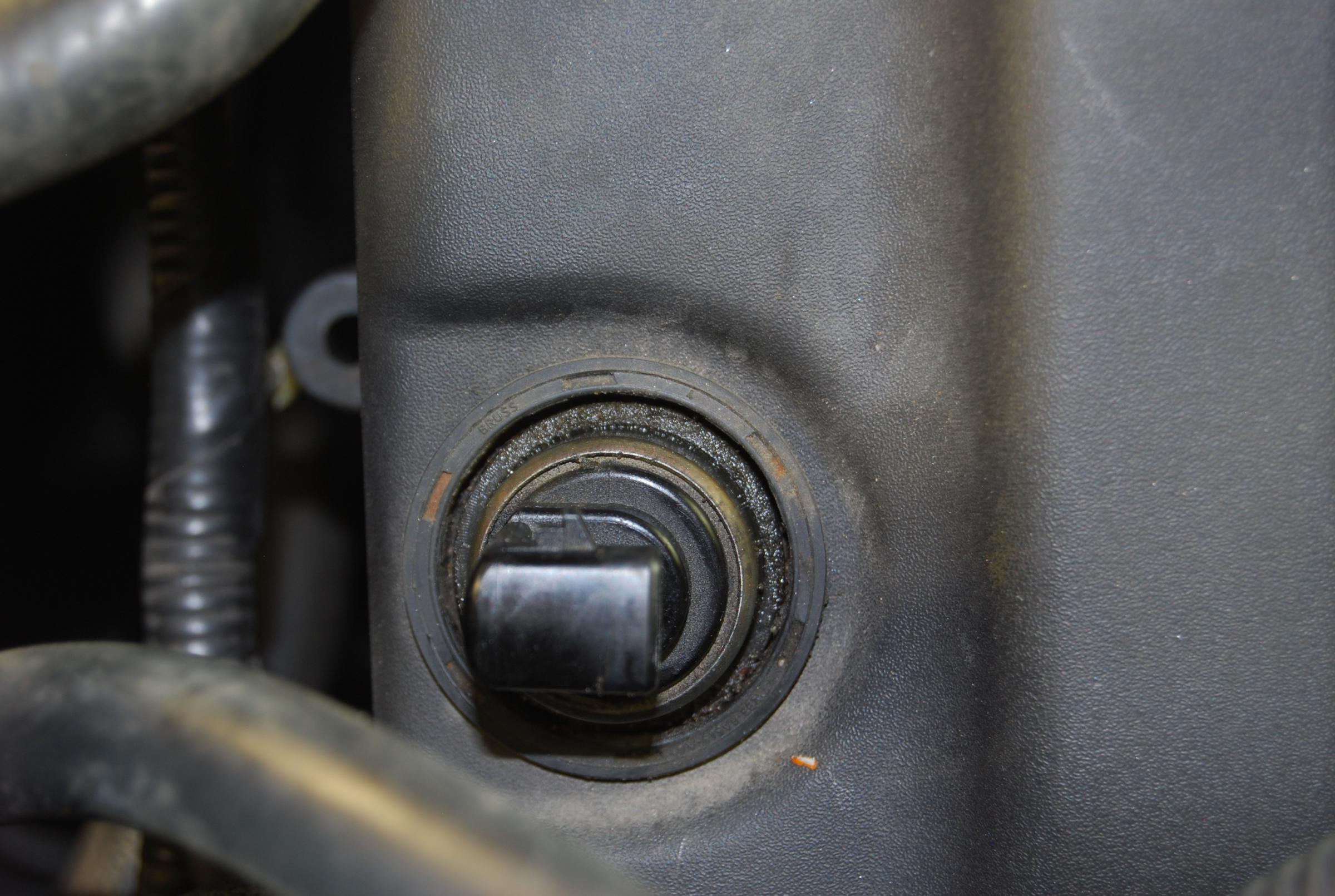

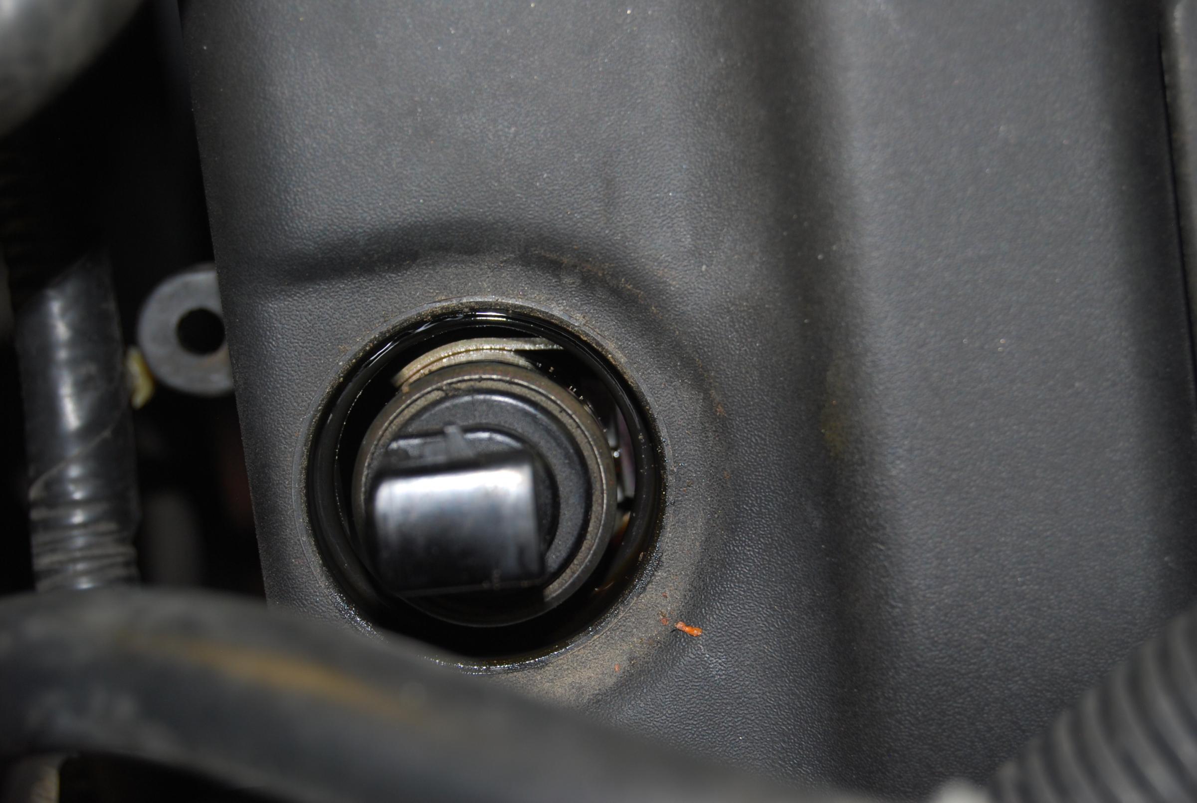

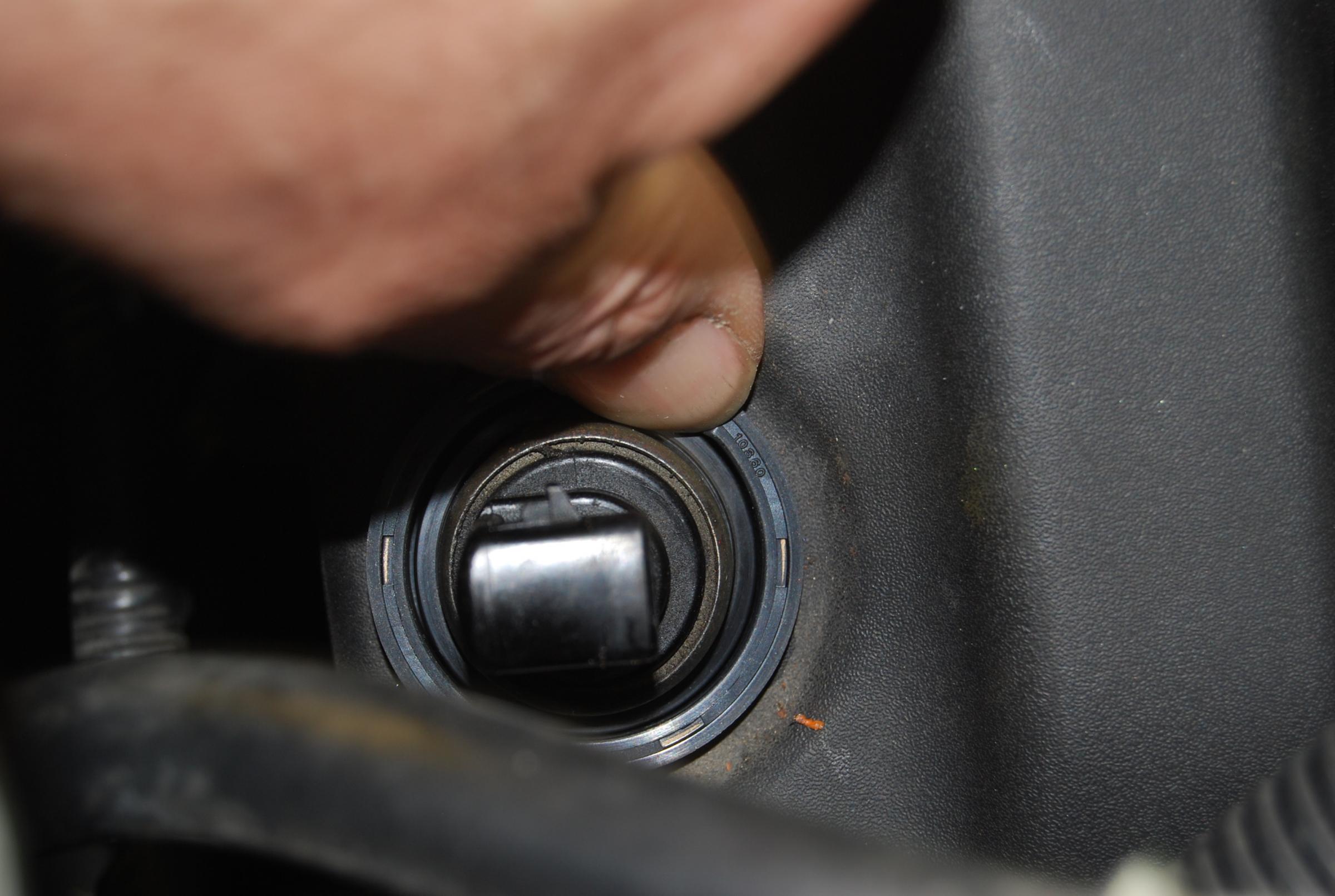

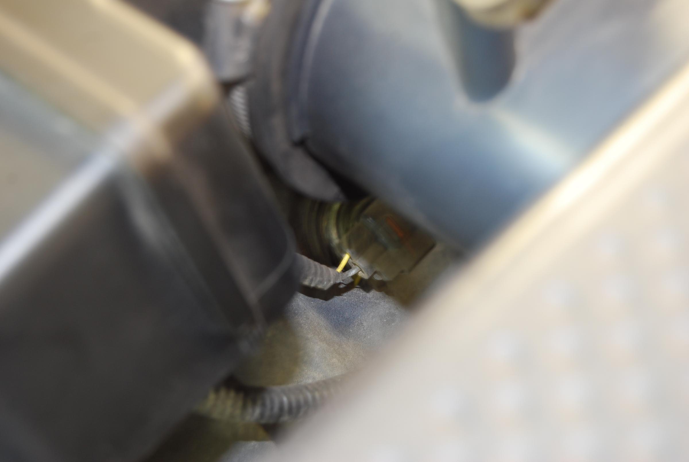

Hi, just received my AJ82856 variable camshaft timing ( VCT) oil solenoid seals and fitted them in no more than 20 or so minuets, including removing the engine cover, MAF and air filter cover. Access to the left bank seal is unobstructed and after disconnecting the plug on top of the VCT I used a 1/4" chisel to prise out the seal, new one just presses in. (Photos).
Right bank is a little more awkward as the air filter housing lid and MAF need to be move out of the way, but then the removal and fitting of the seal is the same, easy peasy and MAF and covers replaced.
No messing about teasing out, just lift out and refit.
