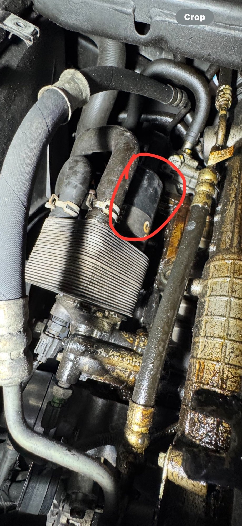

Default Here’s a pic of my leak…
Is this the oil cooler gasket? Circled is the oil filter. Is it coming from the filter? I have been looking for videos on how to replace the cooler or the gasket and no luck yet.

Did you replace the oil cooler gasket that looks like an 8?

The gasket is pretty easy. You will not have to drain oil, but some oil will come out. Best to do it after it has been sitting a while so oil does not drain back as you work. You can remove the oil filter to help drain oil and reduce weight of the cooler itself. No need to remove coolant lines. I have a feeling your valve covers may have a slight leak and I bet your main seal is leaking. Main seals will leak with age and miles, but one huge cause is the wrong oil, cheap low grade oil (not that all cheap are bad) and pushing oil changes too far. The main seal is not a hard job either, but a bit of work. I have to do mine sometime.

thank you so much for your reply. I watched a video on the gasket change and I think I can do it. I won’t lie though. This is a bit intimidating. I am hoping I can get the truck high enough to work on this area. I have a floor jack and some jack stands but I really wish I had some ramps and a flatter driveway.
