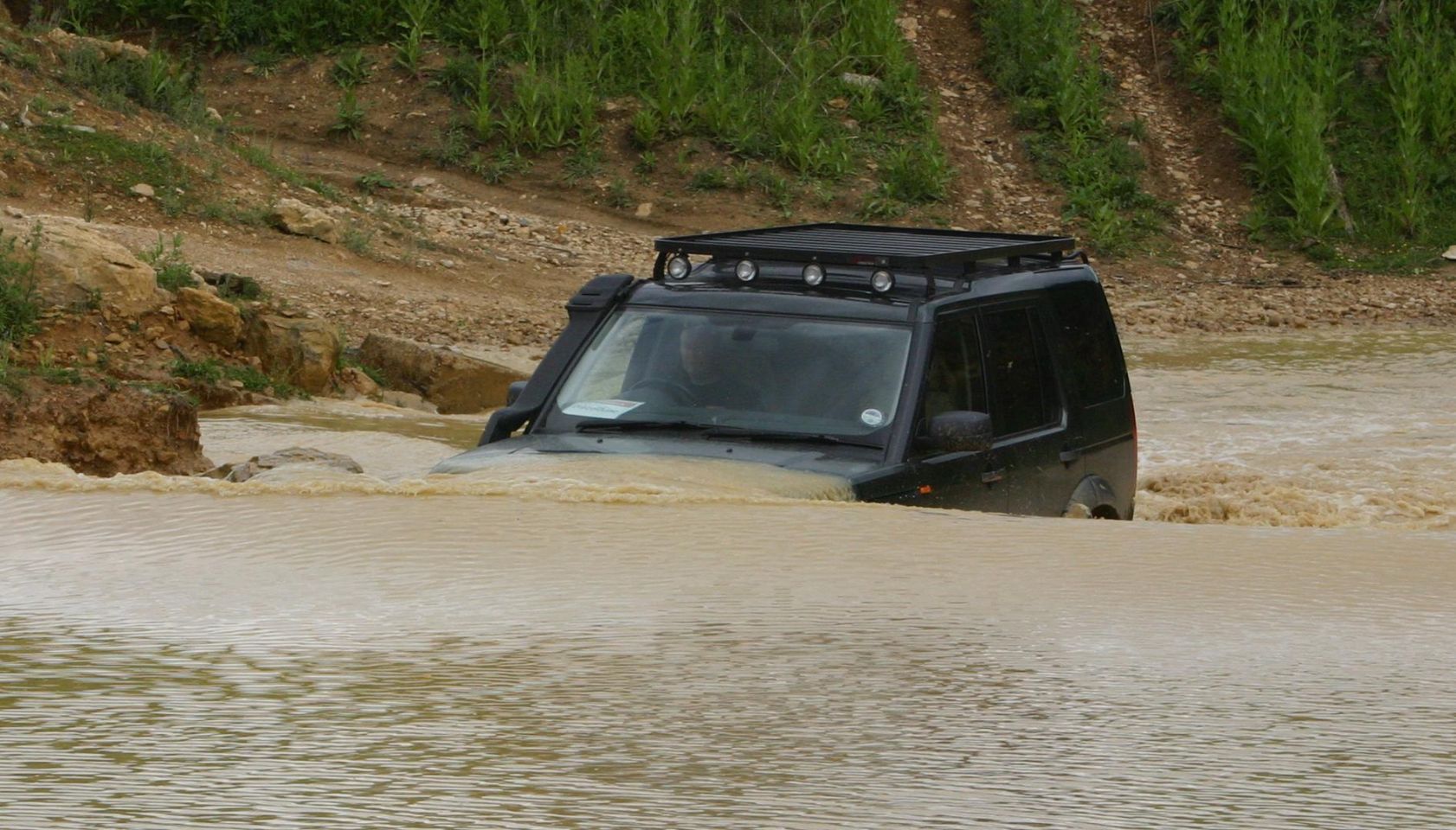

Default Air intake needs its own snorkle!
I think the Australian market certainly needs a snorkel for the heater air intake. It seems those guys somehow routinely end up submerging their 3's.
