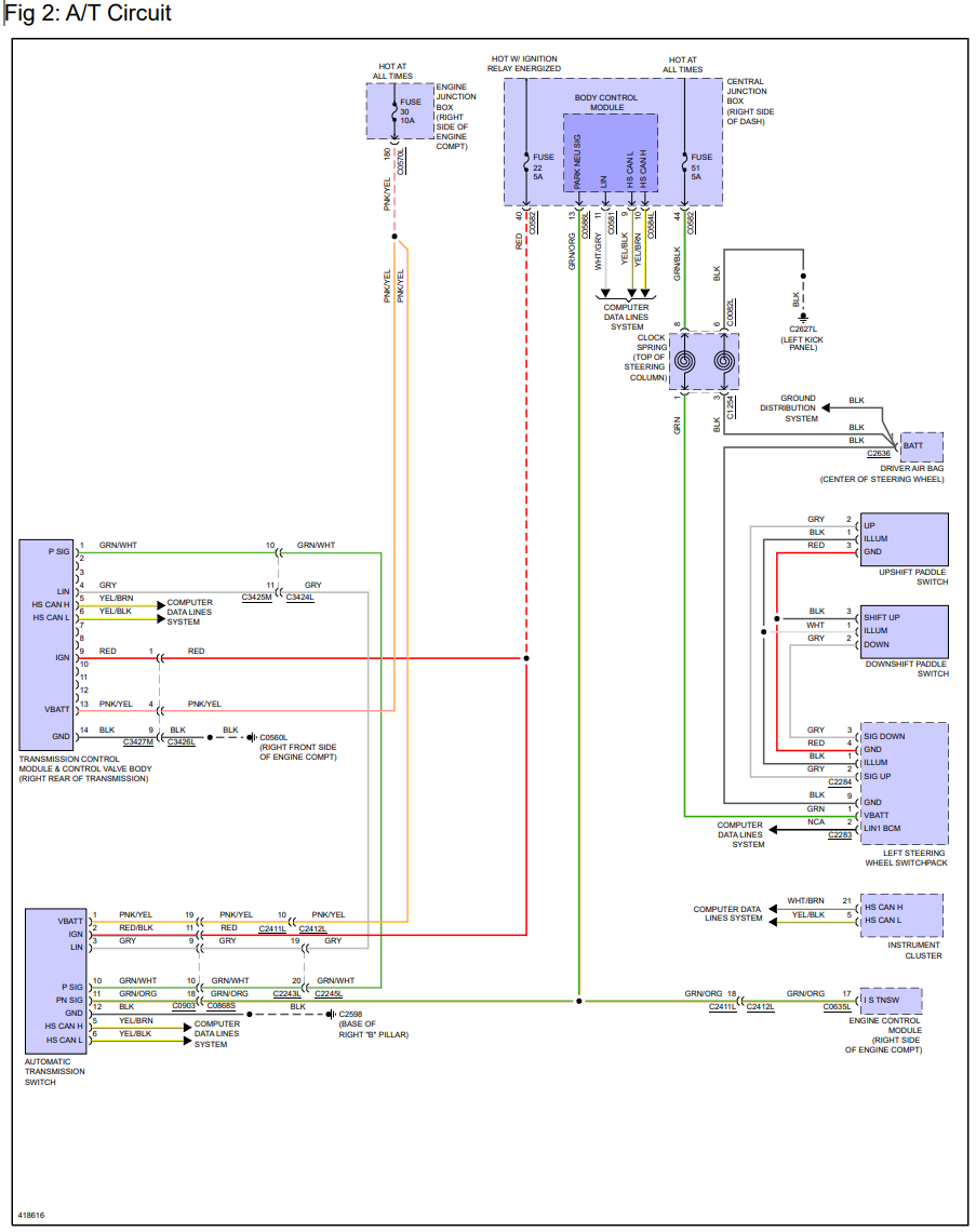

No I have a TCM P1707-77 TRANSFER CASE NEUTRAL OR PARK/NEUTRAL INDICATION CIRCUIT, ECM U0402 INVALID DATA SENT FROM TRANSMISSION CONTROL MODULE, IPC U0102 LOST COMMUNICATION WITH TRANSFER CASE CONTROL MODULE. Is this possibly something electrical like maybe a TCM maybe or is the transmission shot? from what I believe the U codes aren't to concern and after chasing my tail I see I dont have a TCCM so the u0102 may be because of that, but when I clear the codes and shift into gear the p1707 and u0402 come back. I'm getting ready to start ringing wires between the shifter and tcm. When I took the battery out see these bundles of wire not wrapped in the picture attached, that's not from me that was already like that. I'm sure it didn't come from factory like this.

When you changed the pan, I presume that means you installed a new plastic pan with filter? I’m not familiar with that code, but if it’s telling you the B clutch is heavily worn then you’ll want a clean filter in there to help capture the crud in your transmission.
People say U-Codes can be ignored, but I disagree. They are a symptom of a problem and almost always related! The TCM is in the valve body. It is rare to have a TCM problem unless you’ve messed with the TCM or connector plug (connects at back of transmission).
There is a shift position sensor switch on the side of the valve body (in the transmission). Metal fragments can build up on the switch and cause shifting problems. I *think* this could be related to your problem. The other thought
I have would be solenoids misbehaving because there is too much metallic crud in the fluid, this is a known problem on Ford ZF clones.
Sorry I cannot be more definitive, but hopefully this gives you some ideas to investigate.

Today I shot the wires at gear selector and that seems to be working as advertised. Something I have never noticed and my wife either but when its in park/neutral you can hear and feel a clunk in the rotary selector. I assume that's suppose to do that just never noticed. Feels and sounds like a relay.
My next step will be to pull the plug on the transmission, inspect, and shoot the wires and even back probe them.
I agree with you. I find it hard to be a TCM especially since it seems to be hard to find one for my14 lr4 landrover with 8hp70. I've found a few that say bmw, dodge, jaguar, but not for my lr4.
If I'm thinking what you are I also wonder if I moved around some crude and it's getting into a solenoid or shift positioner switch sensor like you suggested could be the culprit...
All I'm trying to gain is narrow this down to the best of my ability before I pay a shop to troubleshoot and replace/rebuild the transmission and still have the problem. I do have a few reputable "British" car shops in the Houston area, but I'd really like to try to give it my best before opening my wallet.

I guess i'm going to go after the TCM. I was able to check the wires at the rotary switch. I'm getting 12v with pin 1 all the time, 12v with pin 2 when ignition on, pin 3 gry, pin 10 grn/wht, pin 11 grn/org the fluke moves when you select park/neutral. pin 12 BLK has continuity to ground and also checked between red/blk and pnk/yel (mines prp/yel). My next move is to get to the plug on the TCM and check continuity between the TCM and ATC switch. I just realized I have an oscilloscope for my Autel scanner so I may need to play with that and figure out how that works.

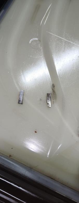

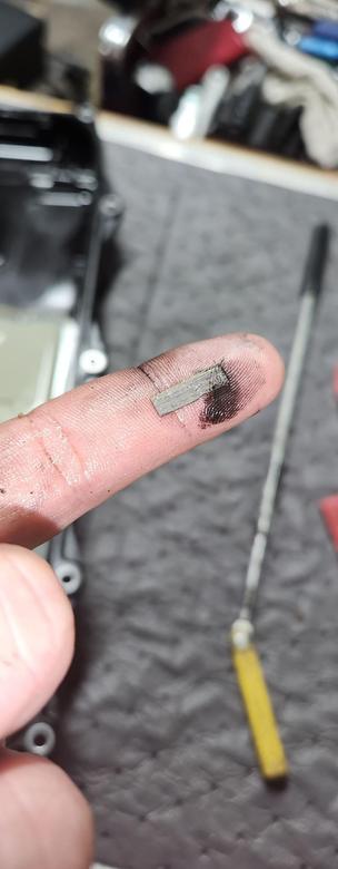

Just in case anyone is following this post...... I troubleshot down to the TCM, but I wasn't having good luck with finding the correct TCM online and the internet has a lot of misinformation out there. I decided to pull the valve body and TCM to get the part number directly off that. Well if you look in the first picture with the red square you'll see a little piece of metal. I wasn't sure where that came from at first. I noticed it when I got back underneath the lift an saw it laying there and I didn't know where it came from or where it belong.
So I decided to put it to the side just in case I figure something out in the mean time I hunted down the exact valve body/TCM for my transmission and it was $900. Something told me to wait before I pulled the trigger and I'm glad that I did. I was trying to dry off the oil pan and I heard something rattling in the filter and that's when I pulled that other piece of metal and then that's when I knew I was screwed.
Now $1,300 later I have a donner 69K transmission I guess I'm replacing everything.

Wow. I’d call that catastrophic failure. Very rare in these ZF transmissions from what I know. $1300 for a lower mileage donor is a deal. You’ll need to study up on the swap, but I’m 99% sure you’ll need to swap your current TCM (the black thing also called a Mechatronix) to the donor because it is programmed to your ECU/VIN —that’s a major reason why the new or professionally rebuilt TCM+valve body cost so much for these.
It’s certainly not what you wanted to find, but at least it is a diagnosis. Thanks for the update.

I appreciate that. Sucks but I was also told by a local shop that works on European vehicles and he said the same. He does not recall ever having to change out a transmission on an LR4. I asked what the labor would be for remove and replace this transmission and I was quoted about $2,200 just for labor soooo looks like I'm doing it myself.
Also I have an autel scan tool that has capabilities of programming and it has "gear change module" selection I believe is what it's called on the scanner. I still feel that it's electronic, but finding these metal pieces leads me to think otherwise. I will however use the donor valve body.
