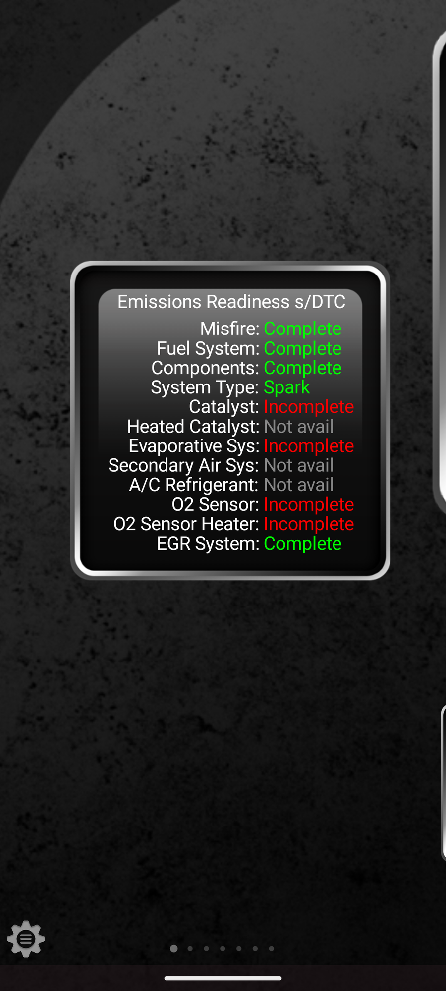

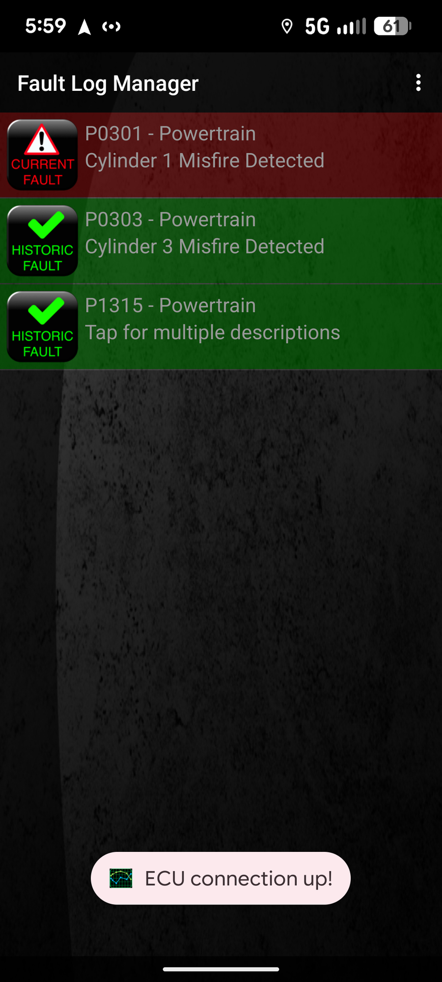

Looking at this 2015 LR4 with 119000 miles in it priced at 5000$ because it needs work. Seller stated it's burning oil. Went to check it out and pulled the codes with the Torque app.
1) rattle, clunk noise and rough running
2) codes P0301 (red) cylinder one constant missfire
3) P0303 (green) cylinder 3 intermittent missfire.
4) P1315 (green)
5) Long term fuel trim Bank 2 went up to 20%
6) the rest of fuel trims somewhere between -6 to 6%
7) Coolant was kinda low and looked murky.
8) someone must have reset the check engine light? since some emissions tests were complete
9) light smoke from exhaust. Not coolant smell, owning a D2 I can smell it a block away.
All the numbers below at idle. Did not get to drive it.
Posting screenshots from Torque App.
Walk away or go take another look?

The rattle is the timing chain or its guides. 2 day job and 2K or 7k at the Shop. The cylinder 1 misfire is a little freaky so you are looking at head gaskets but owning a D2 like me, it is not hard to do. I always look at the items which can stop you getting home and if that chain goes, the engine is ruined. I am in the same boat as you, save the #1 piston, and I know the PO put in spacers to fool the (probably ) full Cats and the code which would come from the same. .

It's the clunking that worries me the most.
I know a missfire rattle, there is no clunking with a missfire, unless it is a 70s motorcycle which I have rebuilt 4 of those.

I wouldn't mind getting a project class D4 needing head gaskets, or timing chain, both is kind of iffy but the clunk and lack of fire in the #1 hole make me think there is more wrong in there, like cracked valve or a really bad HG that's let the block erode. You'd want a boroscope on that before deciding, and TBH for that at $5K and not being the one you really wanted you were right to walk away.
