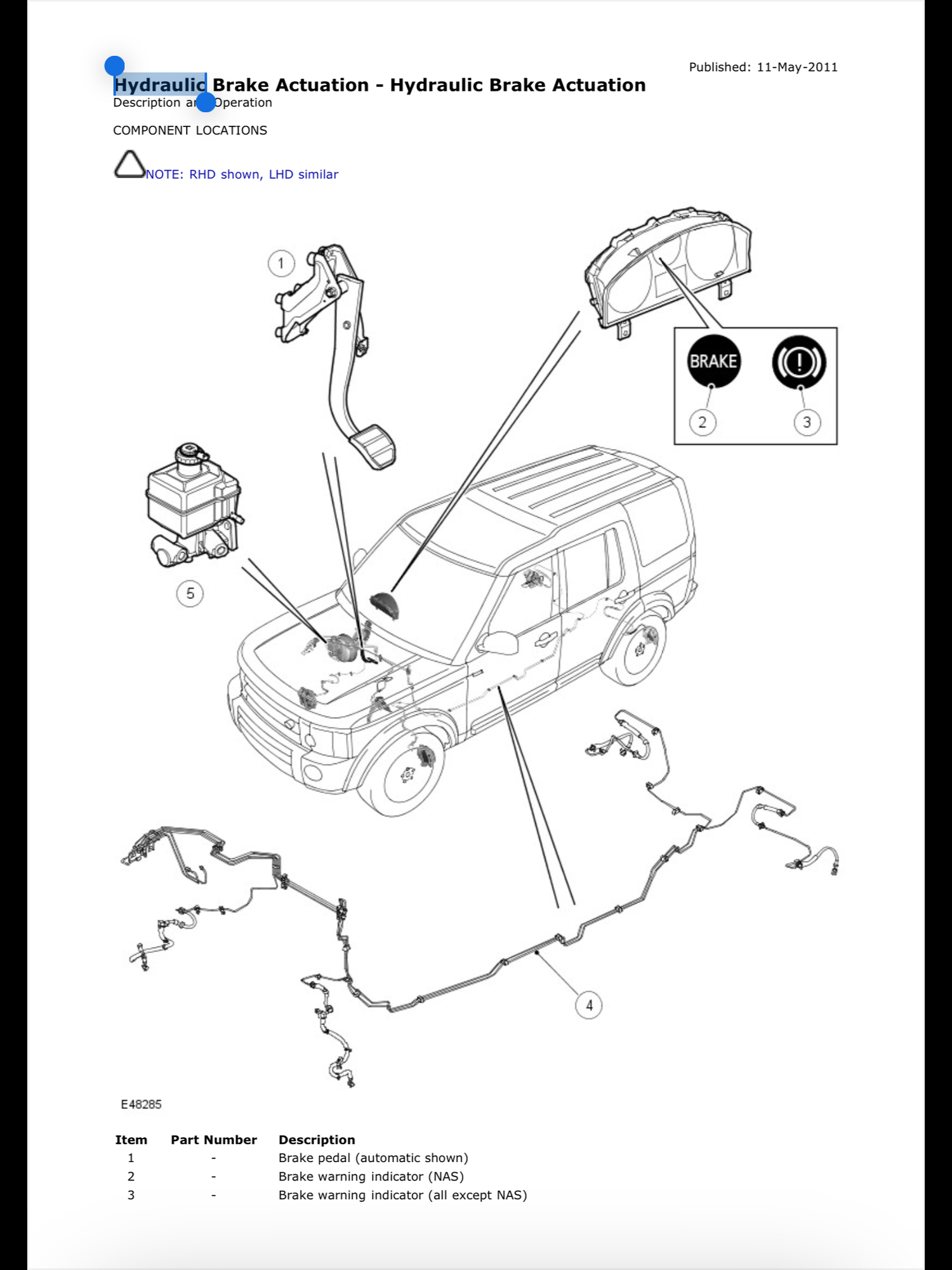

Hello everyone! I recently acquired a 2015 Land Rover LR4 HSE that needs new brake lines. They're rusted out and leaking above the heat shield for the muffler. I'm going to replace them with the Nickel Copper lines so they never rust out again. Does anyone have a diagram of how the brake lines are routed in this vehicle to assist with the repair and does anyone know what fittings and type of flare is required? I assume I can use standard Dot4 brake fluid and not some Land Rover specific potion, is that correct?
Thanks for the help!

Do you not have a copy of the LR workshop manual for your vehicle? If not, send me a PM.
Anyhow, diagram attached.
