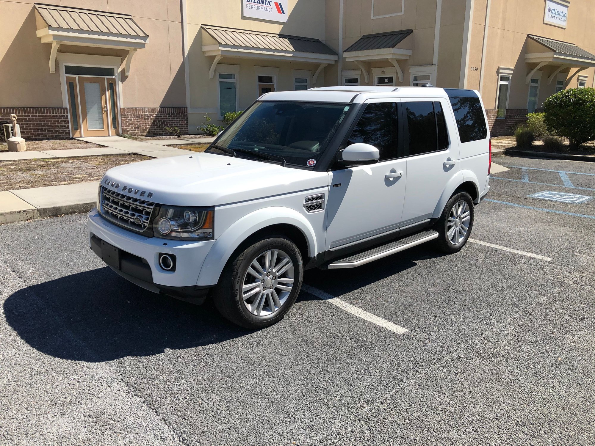

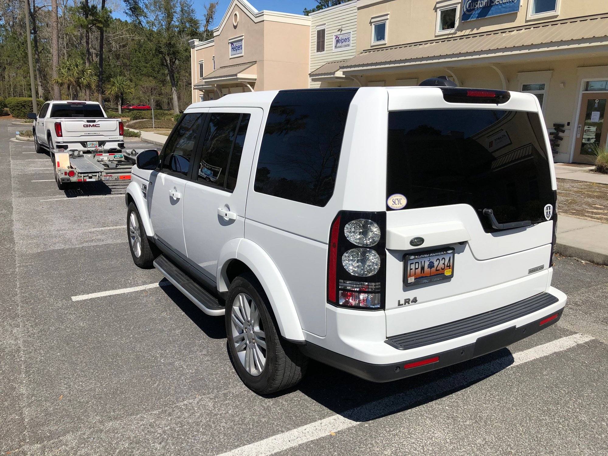

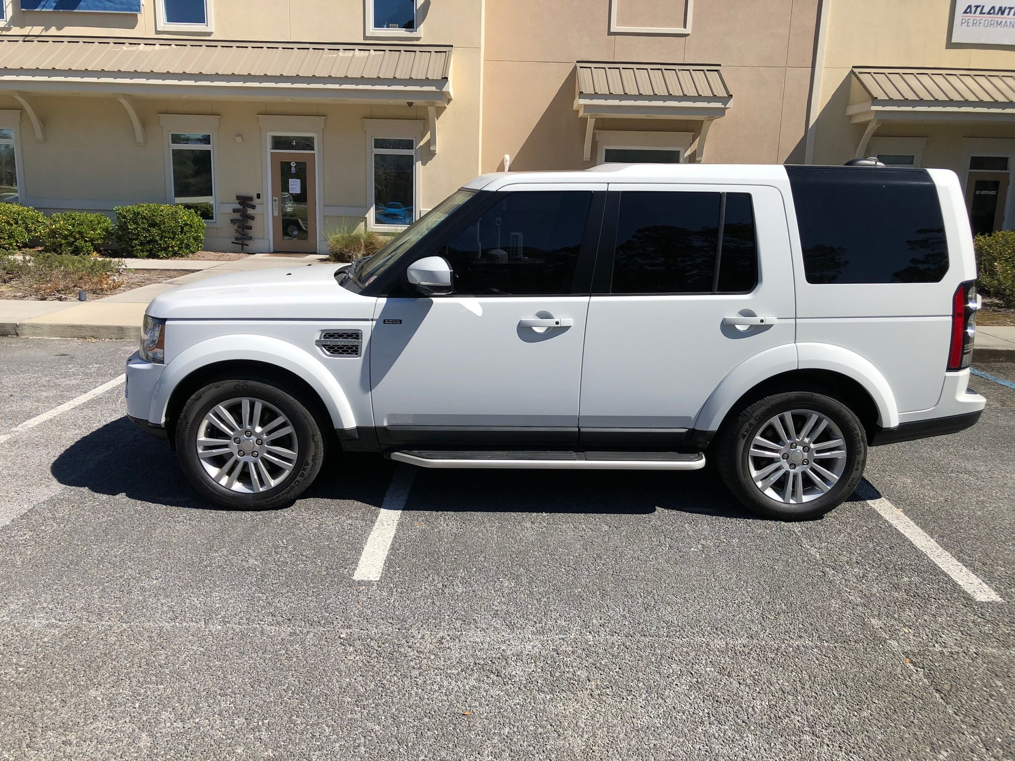

I just picked up my 2015 LR4 HSE LUX this weekend. Looking to pickup some wheels and tires and now just learning that the SCV6 have too large of rotors to run the 18" TuffAnt Steelies or most 18" wheels in general. TuffAnt does make a 5 spoke alloy wheel for the SCV6 but don't like the look and not sure I dig the PD1881 Comp's either. I guess I could run these worse case.
I would be looking at running an 18" wheel with the BF Goodrich 265/65/18 KO2's. Many seam to have good luck with those with no additional modification.
Is it a realistic idea to downgrade the rotors to comfortably fit the 18"s? What all parts are involved to do that, is there a kit? Any other ideas for me or wheels options not involving spacers? Thanks
[See attached pics of the new ride]
