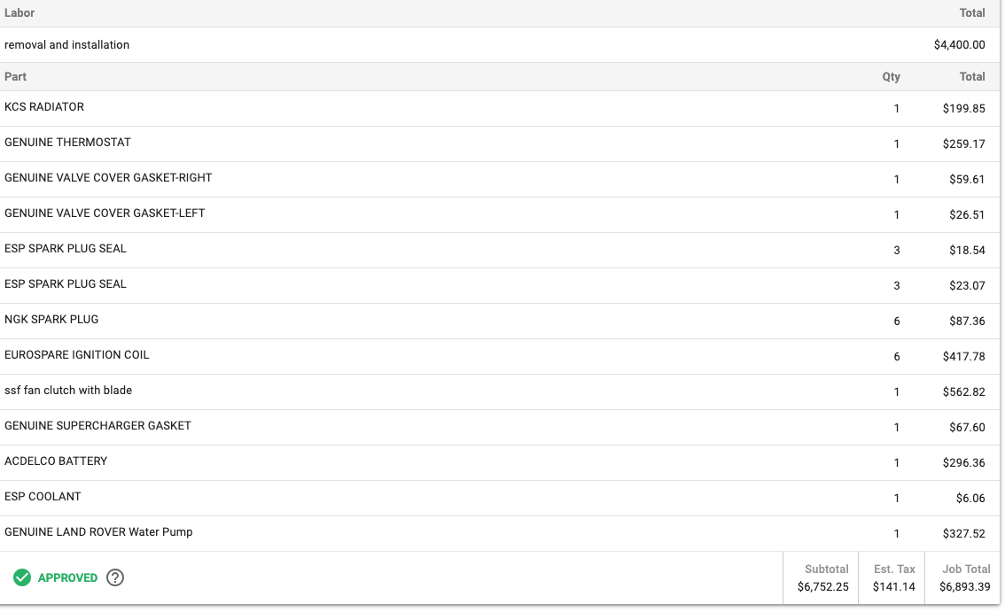

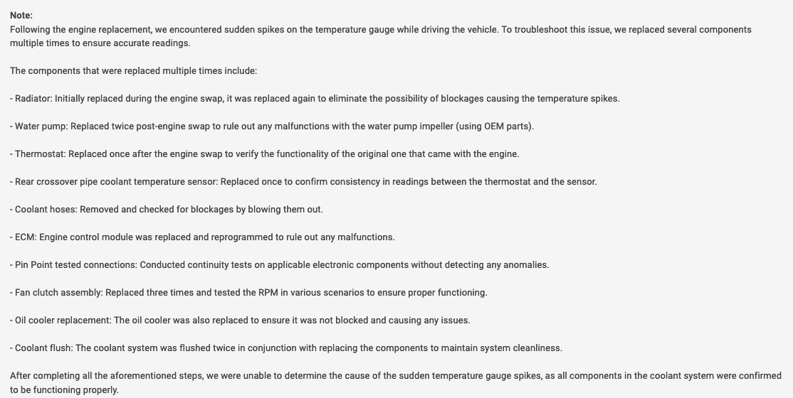

This a 2 year long saga that seems to have no end in sight. My LR4 engine was severely damaged after a sloppy coolant job that did not replace the cross-over pipe. After a long road trip the engine was toast. Since then, I have had a refurbished engine installed which seems to be working. The radiator, thermostat, valve cover gaskets, water pump, spark plugs, supercharger gasket, and battery have all been replaced. As of right now, I think I have sunk more money into this beauty than it is worth! The problem is that the thermostat shows overheating within a few minutes of running the new engine. They have changed the thermostat 3 times, twice at the sop and once at the dealer. They have checked the harness and tested all the electrical connections. The car turns on nicely, sounds good, all systems look great, and BAM! the temp guage spikes.
They have installed a second refurbished engine (both from what I believe is a reputable company in California) and the same problem persists.

parts replaced in addition to the engine
work done to date
work done to date

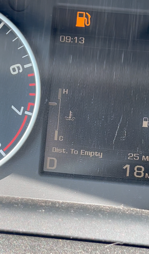

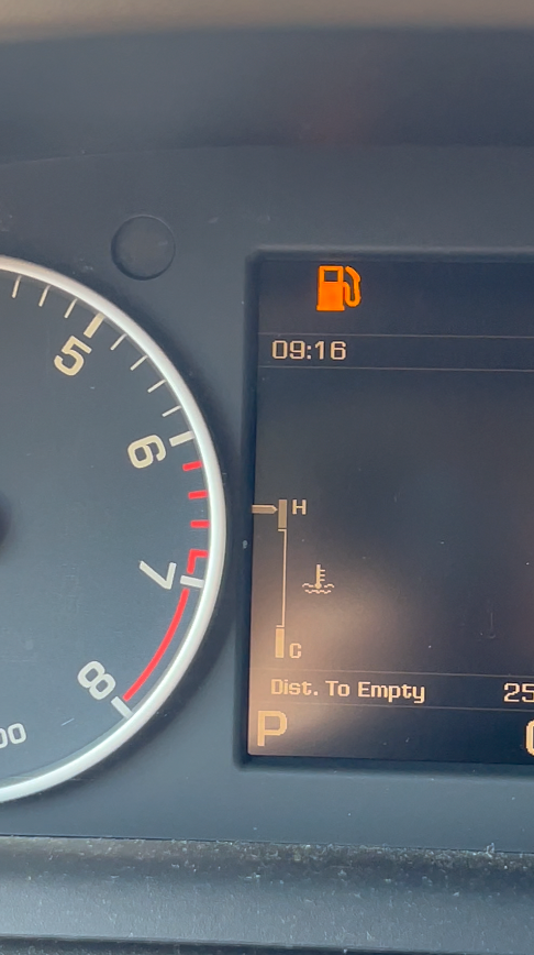

From a cold start it takes about 14 minutes to show overheating.
From a hot start after a few minutes of rest and a centered guage, it took less than 1 minute to reach the top
