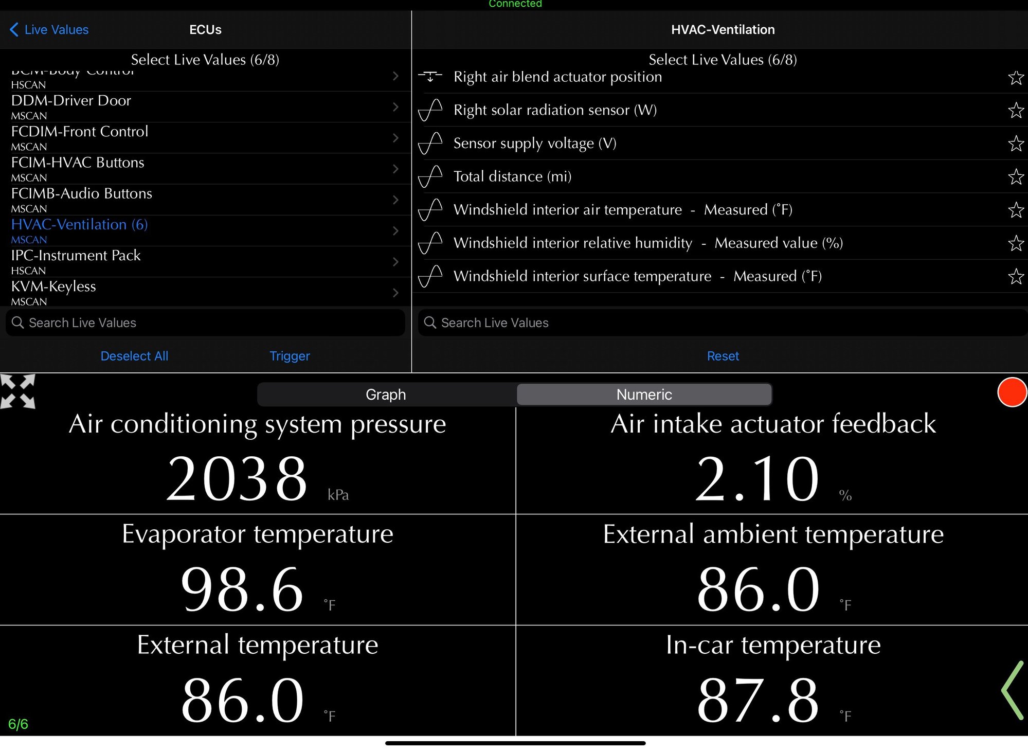

A/c does not blow cold. Here are the screenshots. Any help or anything else needed from the gap tool please lmk

The System pressure is a little high, and your evap temp is way too high. There are several things that can cause that, you'll have to put a proper set of gauges on it to see the hi & lo pressures and see what they do when the compressor cycles.

Easiest fix first. was the fluid recently 'over' topped up...
