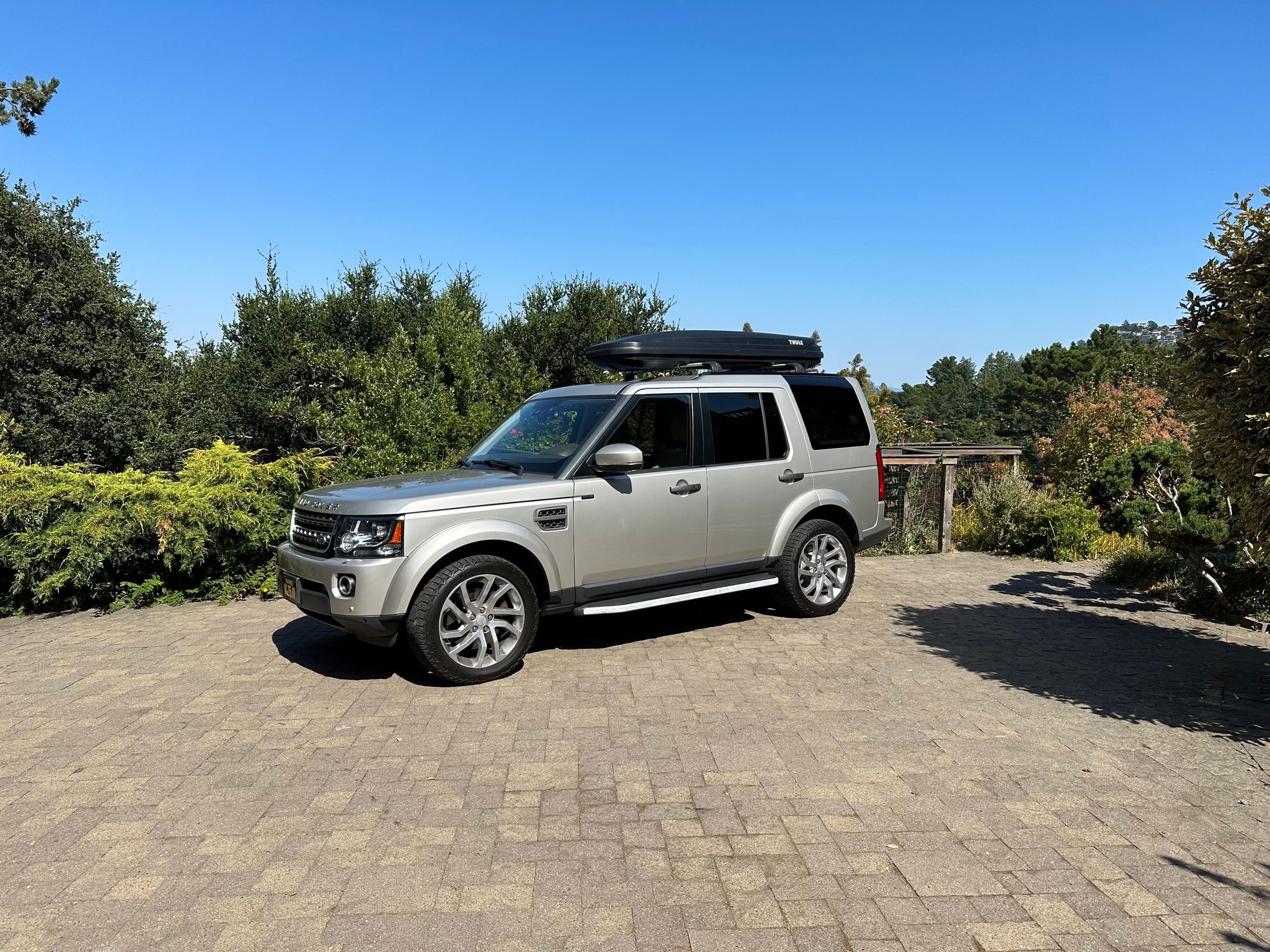

I had a 2009 LR3 that was very low hassle. I bought it at 40k miles put over 70k miles on it and sold it for a bit less than I paid for it. All-in-all a great experience. I can't give the same glowing review for my 2016. Bought it at 40k miles and put 60k miles on it. 3x more expensive than the LR3 over same mileage.
The pros:
- its a darn good looking machine, particularly with the 20" twist wheels on the 2016s. those are a must.
- the power of the SCV6 is impressive. you won't ever want for power. it will give you a kick when getting on the highway.
- its an LR and kicks ***. but you know all those things.
- I didn't like the running boards at first, but now I do.
The cons:
- it has all the same issues of the LR3 plus some new ones
- the standard issues with all LR3/LR4s: lower control arms every 75k miles (indy will charge $800-900), compressor for the air suspension typically go every 50-75k miles (you can rebuild/replace yourself), it eats brakes, wheel bearings can go...and that f'n sunroof leak. if you don't have a garage you will need to blow your drains out every few months or will end up with a swimming pool in your passenger footwell.
- then it has some new quirks of its own: the fancy gear shift ***** regularly crap out leaving you unable to put the car in gear (20 mins to replace but ~$400 part), the coolant systems on these are complete trash and need to be replaced. to save money they were made plastic components with laser welded seems (instead of molding them as one part). wherever those parts are laser welded they fail around 75k miles. my indy told me about this before I bought the car but I didn't full appreciate what a pain in the *** and expense it would be. you will need to replace the thermostat (easy, $150), but the much bigger job is the front and rear cross over pipes. those will let go and dump all your coolant. as soon as notice the first leak you have a few months to get it sorted before a catastrophic failure. you see a decent amount of SCV6s have blown engines or bad head gaskets from overheating that way. It's going to run you $4k to replace those, even at an indy. Cheap part but you have to pull the entire supercharger off and not an easy DIY job. I've only seen one video of a guy doing it. Took him a few days I believe. They are replaced with new pipes that are molded as one part, so much stronger. They will also replace your supercharger bearing while in there. Low pressure fuel pump (in the tank) was an issue with mine. A DIY job with a $150 part but not a fun one. Dealer will charge you $1500+. At idle the engine sounds more clattery and vibrates more than the V8 from the LR3. That was a great engine but a little low on power.
But the heart wants what the heart wants
