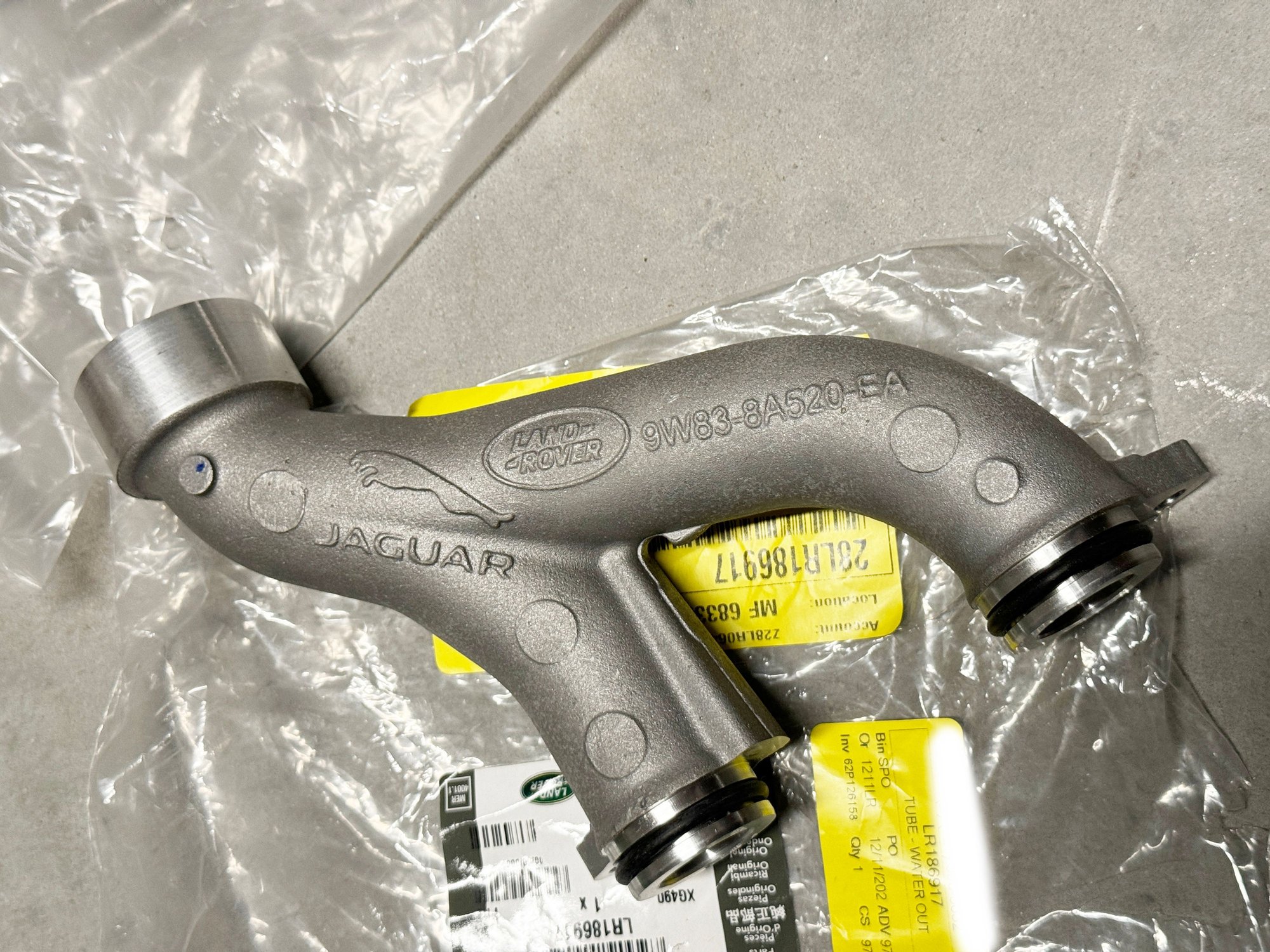

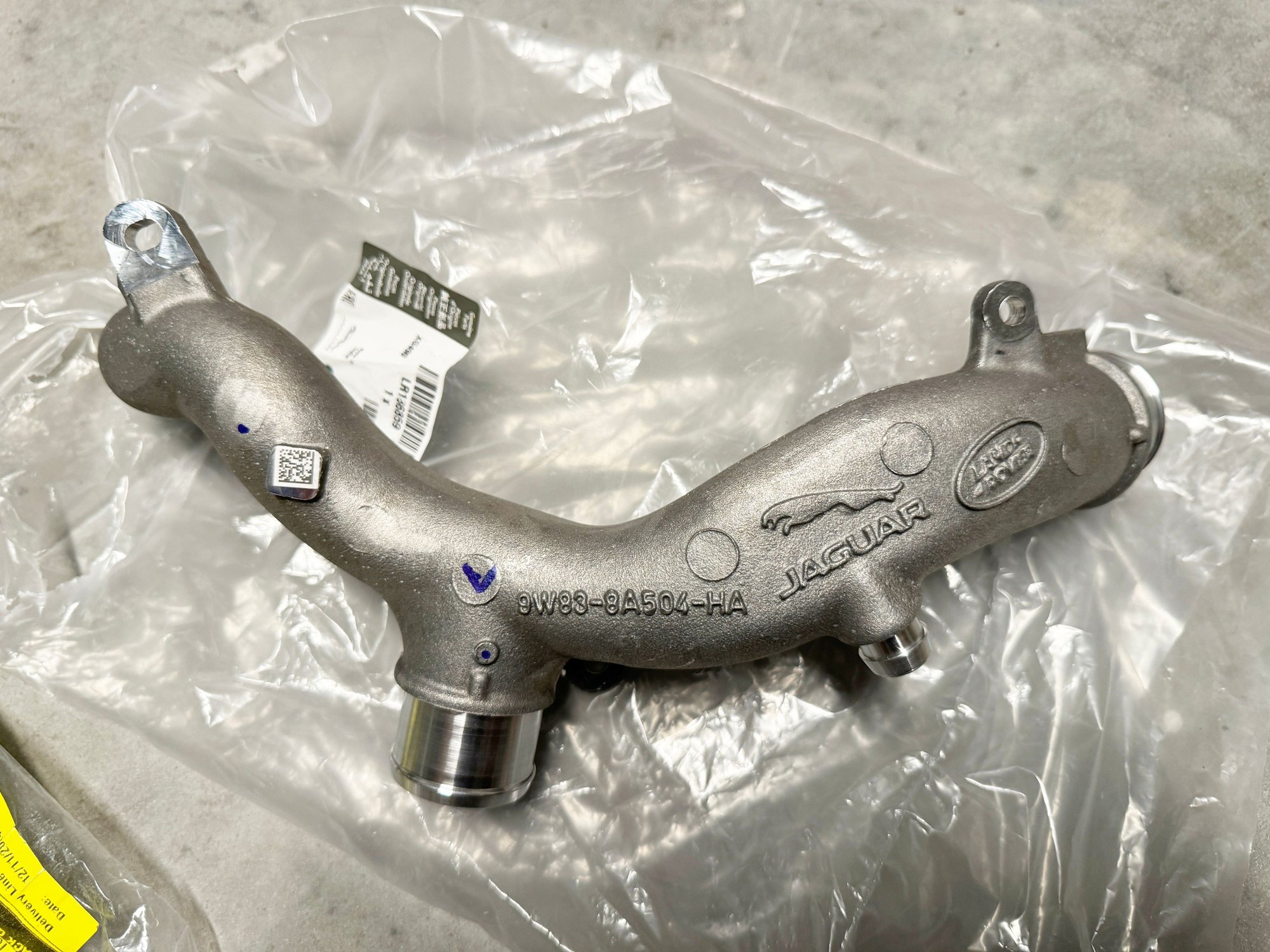

JLR have now offer alloy pipe options November last in North America.
these are for the SC not the NA engines correct?

nice pipes; sure wish they would make them for the v8 na
Correct though the NA replacement's easier.
aren't the rear pipes on the V8 and the V6 the same? i thought i read they were.
Edit: after a little more research(which, yes, i should have done before posting originally), the rear crossover pipes are the same for V8 5.0 NA and SC only. this covers LR4s, RR, and RRS.
Supercharged V6 and V8s have the same pipes; the NA V8s are different.
