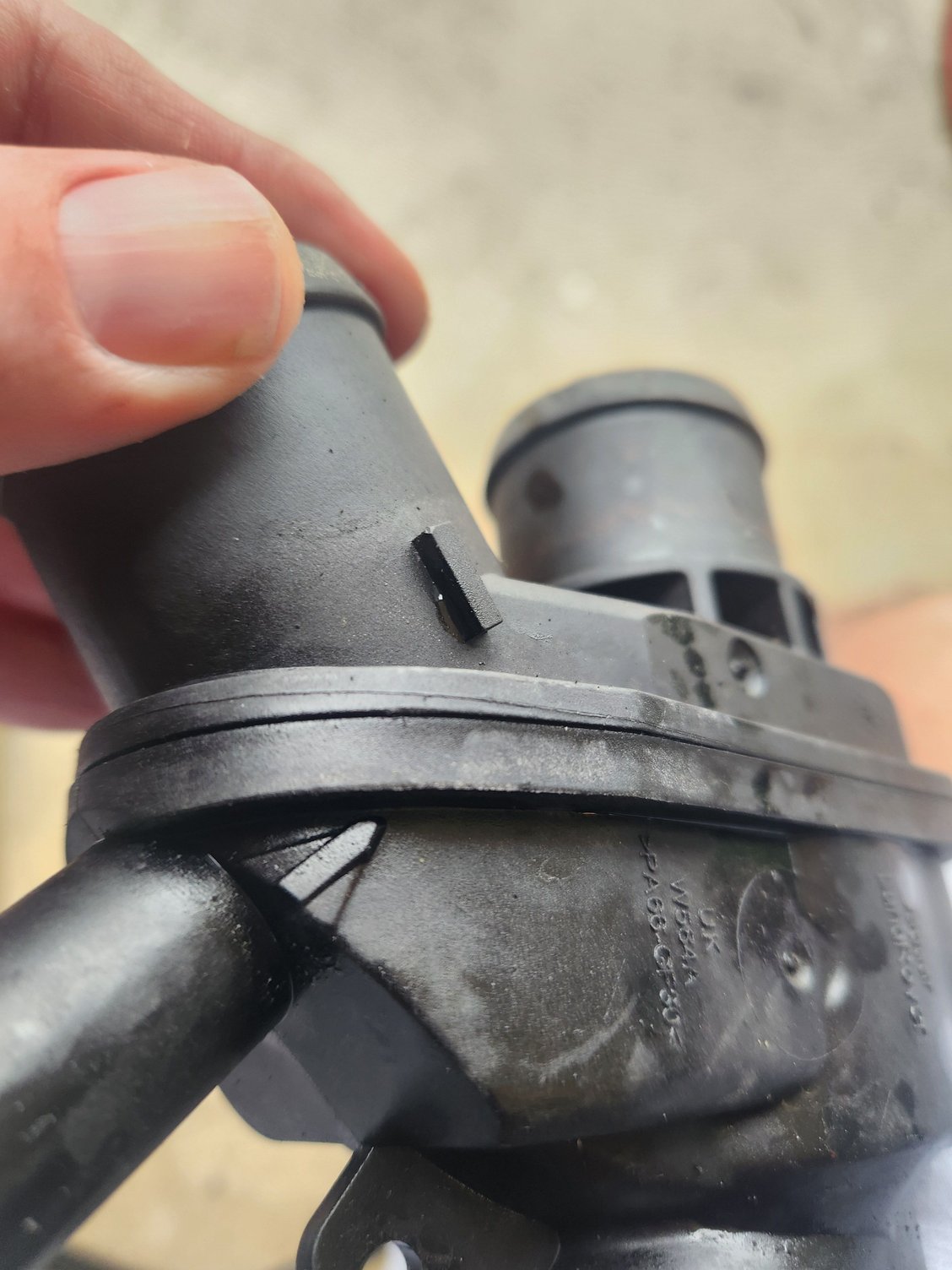

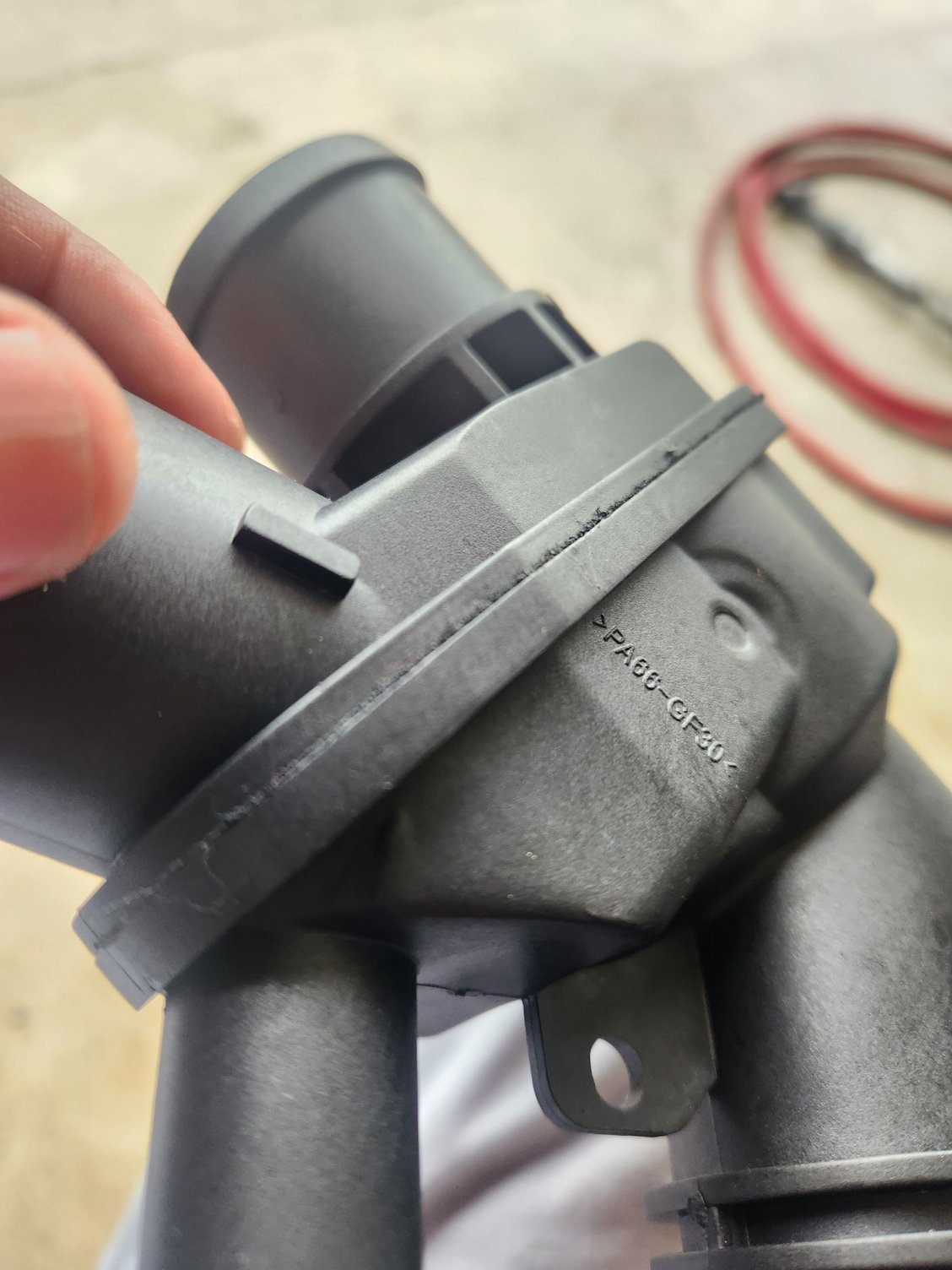

Took me all of 30 minutes to remove the thermostat. It came off the bottom hose fairly easy.
The rubber seal in the bottom hose is still fat and rounded in the connector. So I'm wondering if i should even bother replacing it.
Heres a couple pics of the old thermostat at where it was leaking at the seam. Compared to the seam on the new one.
