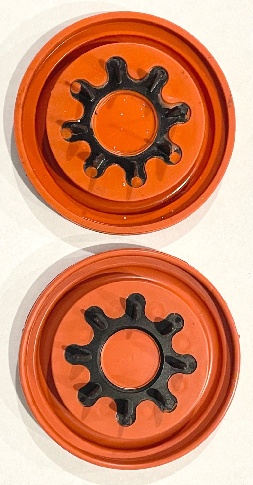

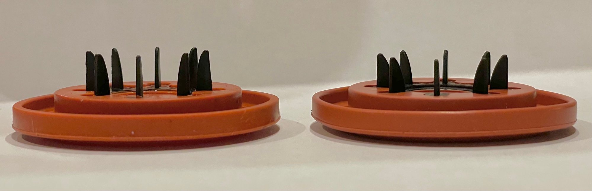

Managed to locate a new genuine PCV kit, likely I swap it this weekend. Meanwhile there are some NOTABLE differences between the genuine and aftermarket. I taken pictures but straigt away main differences include the genuine cover's must less flexible and minor differences in the inside; the valve itself has many differences including dimensions, shape, thicknesses, etc. Enough so I reckon could be a cause for the noise due to the way it would seal. We'll see soon. Meanwhile here are some photos for comparison.

Fitted the genuine JLR PCV valve and pleasantly enough it was much easier than the aftermarket, good snug fit stayed in place and snapped firmly shut. Drove a few hundred miles with no noise or whistle or strange throttle body noises.
