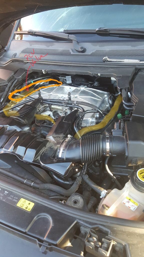

I see you found the PCV, but there are actually two breather lines, one from the PCV valve in the passenger side valve cover that leads to the throttle body, and one from the drivers side valve cover that leads to the air intake. The attached pic highlights the run for each.
I don’t know which rigid vacuum line you’re referring to (or why it would be clicking) - the vacuum line from the vacuum pump along the passenger side of the engine compartment?
One other thing you could check is whether disconnecting the purge valve line from up near the throttle body (and blocking the connection on the throttle body to prevent sucking air) makes any difference in your fuel trims/o2 readings when you’re having the issue. Just wondering if you might be sucking gas fumes from the purge valve.

Left side would be driver's side, and it's the rigid loop next to the the full load breather. Had a read of the other forum thread and it sounds VERY similar to mine.
