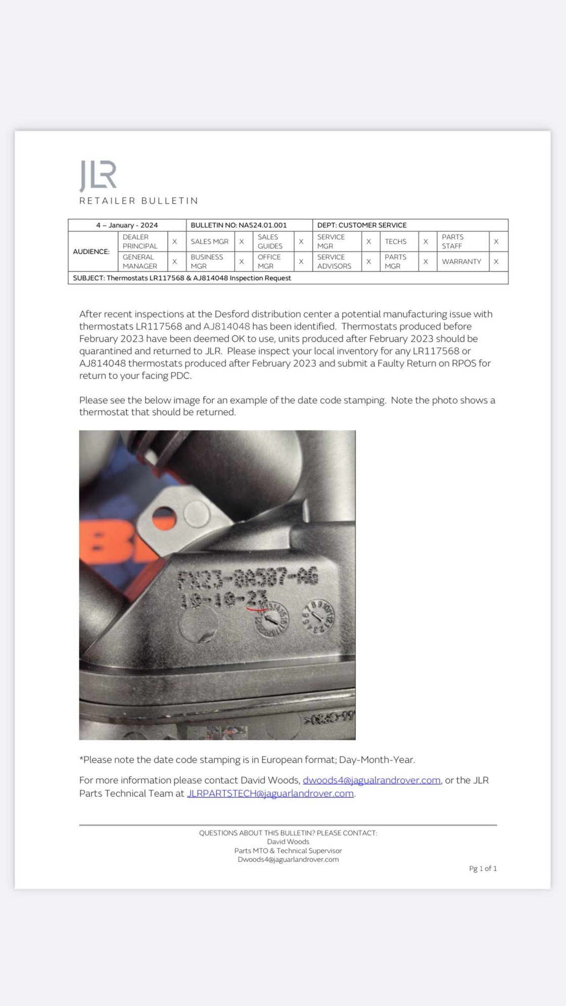

To give you an update, the thermostat that I ordered from rockauto.com that I thought was going to be aftermarket ended up being OEM. After doing more research I found a bulletin from Land Rover informing mechanics that any OEM thermostat manufactured after 2/2023 should be quarantine. At the moment there is a national shortage on all aftermarket thermostats and I've been searching high and low for a viable option. I've attached the bulletin for everyone to reference.
