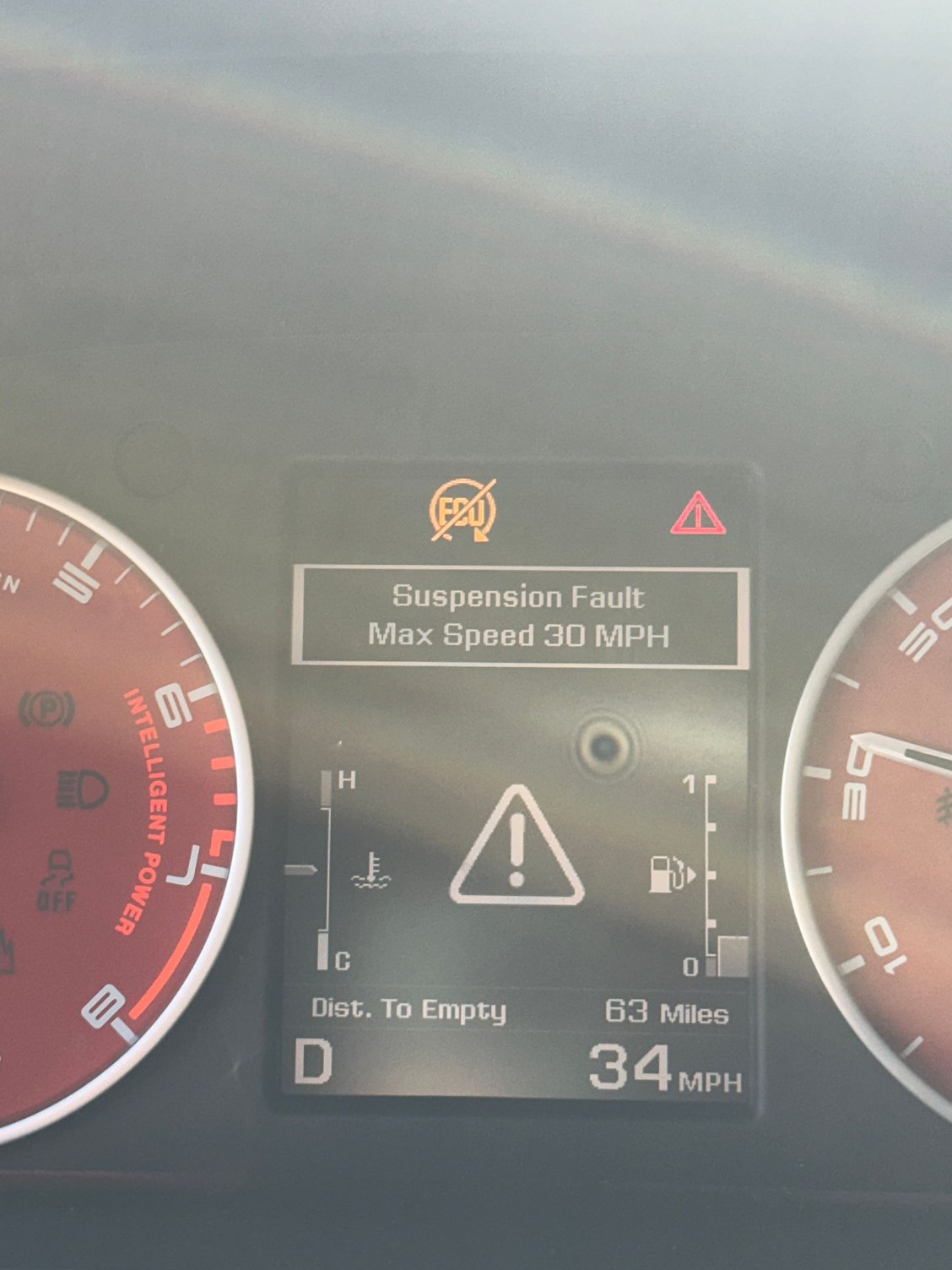

So this an intermittent problem and I am not sure how I am going to catch the problem.

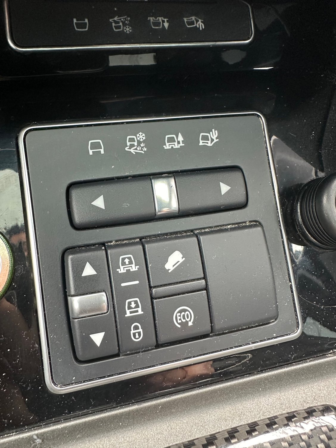

Here is what happens. Periodically the car will suspension fault and go down and sag on top of the wheels. Get the fault on the display to not exceed 30MPH but the entire terrain response system goes black. Periodically if I continue driving it will fix itself or I have to pull over and restart the car and everything will go back to normal.

Did you look at the photo and see how the terrain response system goes black and not illuminated at all.
Yes this randomly occurs.
It drops on all four corners not just the front when the fault is present. When the fault is not present and the terrain response is illuminated all four corners are even and ride height is fine.
When the fault goes away either by random or by vehicle restart the pump does raise the vehicle to normal but not immediately since it is a 10 year old car.

Yes, I have seen all of your attachments, thank you for asking. This is the programmatic response to “suspension fault”.
This does not negate the fact that you are losing air pressure. Air should not seep on its own.
Age of vehicle is irrelevant. A properly operating air pump will inflate the air system, swiftly… Unless of course, there is a leak.
