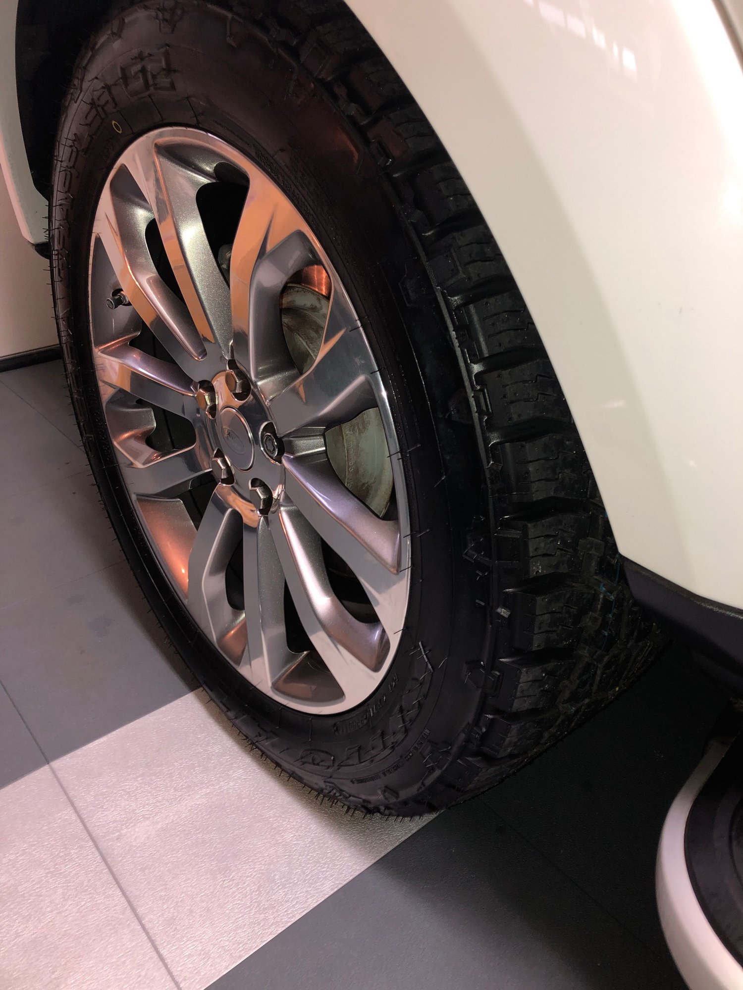

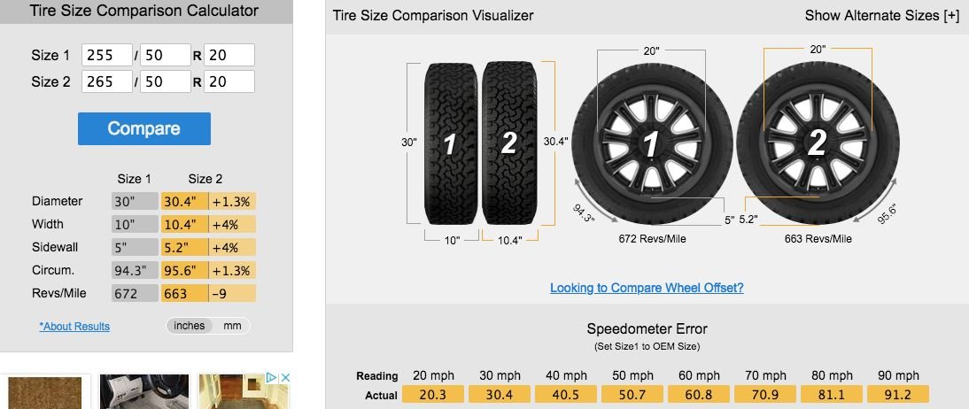

Decided to go with the Nitto Grappler G2 series 265/50/R20 which will add a slight amount of height and width over the stock 255/50s while planing to leave the OEM suspension alone for now.
Old Nov 13, 2018 | 03:05 PM
rewillia's Avatar
Joined: Aug 2007
Posts: 48
16 LR4 HSE
Views of Front/Rear Tire
Nitto Grappler G-2 265/50/R20 111Y
Diameter 30.04 x 10.91 TW
No clearance Issues at any height setting including access.
These are mounted on LR's 20" 5 Split Spoke Alloys
