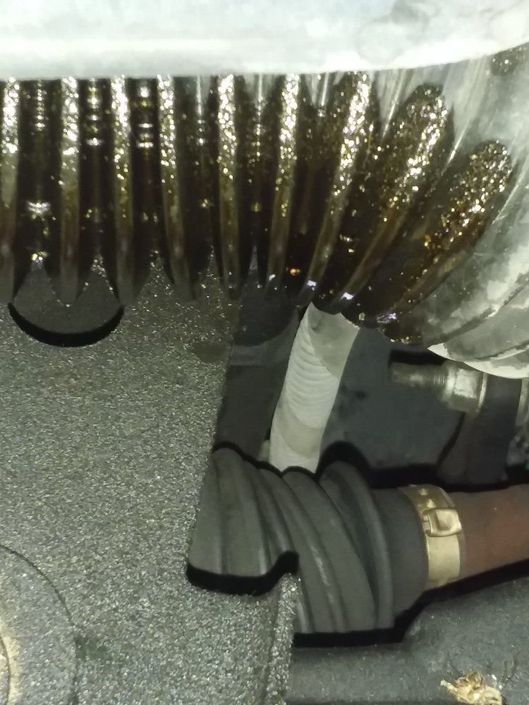

I've just joined as I plan to be a LR4 owner in the near future! Currently looking at a 2013 LR4 for sale near me (SoCal). It has the 5.0L V8 (obviously) and about 100k miles. The body and interior are in great condition, the engine sounds good but there is an oil leak with oil around the half shaft area on the driver's side (left side of vehicle).
I've read about all the various reliability issues with engines etc....so I'm particularly focused on making sure I find a good vehicle to purchase.
Here are a couple of photos. Can anyone tell me the most likely source of the leak and how difficult/costly it would be to fix?

Cannot help you on the source of the oil leak for that area but if a 5.0 is "rattly" run away as fast as you can because it probably means the cam chain tensioners are worn and chain is loose...big expensive job on the jlr powerplant.
Unfortunately LR stated oil changes on these could go 14k mile intervals...way to long with that design so i would find one with quiet cam chains and associated parts with history of oil changes every 4-5k miles. My son's 2011 has 90k miles on it now and engine is quiet as a church mouse...religious oil changes with synthetic 5w20 and jlr oil filters ever 5k miles

Can’t tell what I’m looking at int the photos, but most common oil leak is the valve cover or timing cover. Getting the valve covers off (and you need to do that to get the timing covers off properly I believe) is not exactly easy from what i’ve read, though doable for the home mechanic if you like to do that sort of thing. I think all the injectors need to come out.

I'm planning to look at the vehicle again tomorrow and will take a scope to try to see where it's leaking. I'll check around the valve covers first. Thanks again
