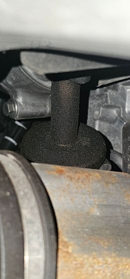

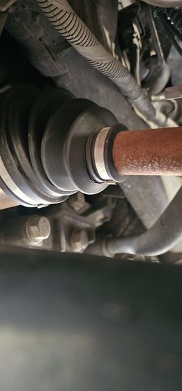

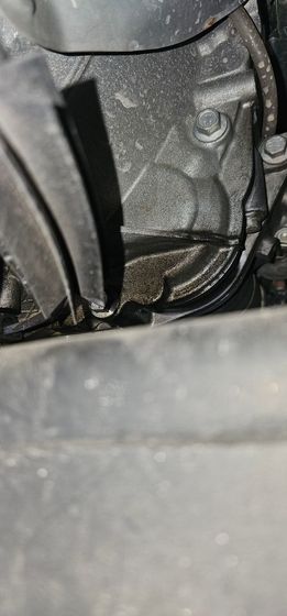

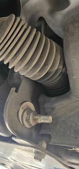

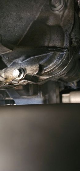

Hello, I was hoping to leverage the expertise of this group as a potential future LR4 owner. I am in the process of purchasing a vehicle and just had it inspected. Of course, there were a handful of findings - trying to determine how significant they are. If you have a sense for cost, would welcome greatly! Will likely need to have done at a local independent shop.
rack and pinion seal seeping
Oil seep transmission bell housing
rack and pinion shaft seal seeping
LF axle boot starting to crack
seeping

steering rack leak is going to be expensive to do right [need new/reman rack] and full alignmnent. at that time upper and lower a arms need to be inspected and lowers probably replaced.
oil seep at bellhousing could be rear main seal or further up engine; hard to diagnose but expensive labor to correct in any case or live with it if minor
cracking axle boot..needs new CV axle--not too bad and should be done in conjuction with first items

Te rear main seal will be some large hours, either the engine comes out or the transmission.
Between the rear main seal, or the front pump seal in the transmission, the rack, the axle and the rest of it is going to be thousands. It's hard to put and actual number on it because shop rates vary from place to place but none of this is cheap or easy. How many thousands can only be answered at an actual shop.

I was quoted $3200 for a rack replacement on my 2013 LR4 from an independent shop in Minnesota, just adding fluid as I save up the cash.
