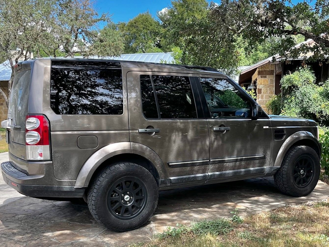

Hello, all.
After a cold weather air compressor failure dropped my 2012 LR4 onto its 285 60 18's on the interstate and left me stranded, I bought an off-road SYA Kit from Lucky8.
With the SYA kit installed, I thought I noticed a harshness when driving over certain bumps on pavement that hadn't been there before. Instead of a muted bump it was a bang. I recalibrated the suspension using the GAP tool, but the harshness was still there. I reached out to Lucky8 but they ignored me. I tried living with the ride quality for a few months, thinking maybe it was in my head. A couple weeks ago I needed a brake job and took the opportunity to remove the SYA Kit. The harshness is gone. That certain quality that the LR4 suspension has that makes it a joy to drive is back. The love has returned.
Anyone else have this issue with the SYA Kit? (Just a subtle but annoying change in the suspension's ability to absorb harshness.)
