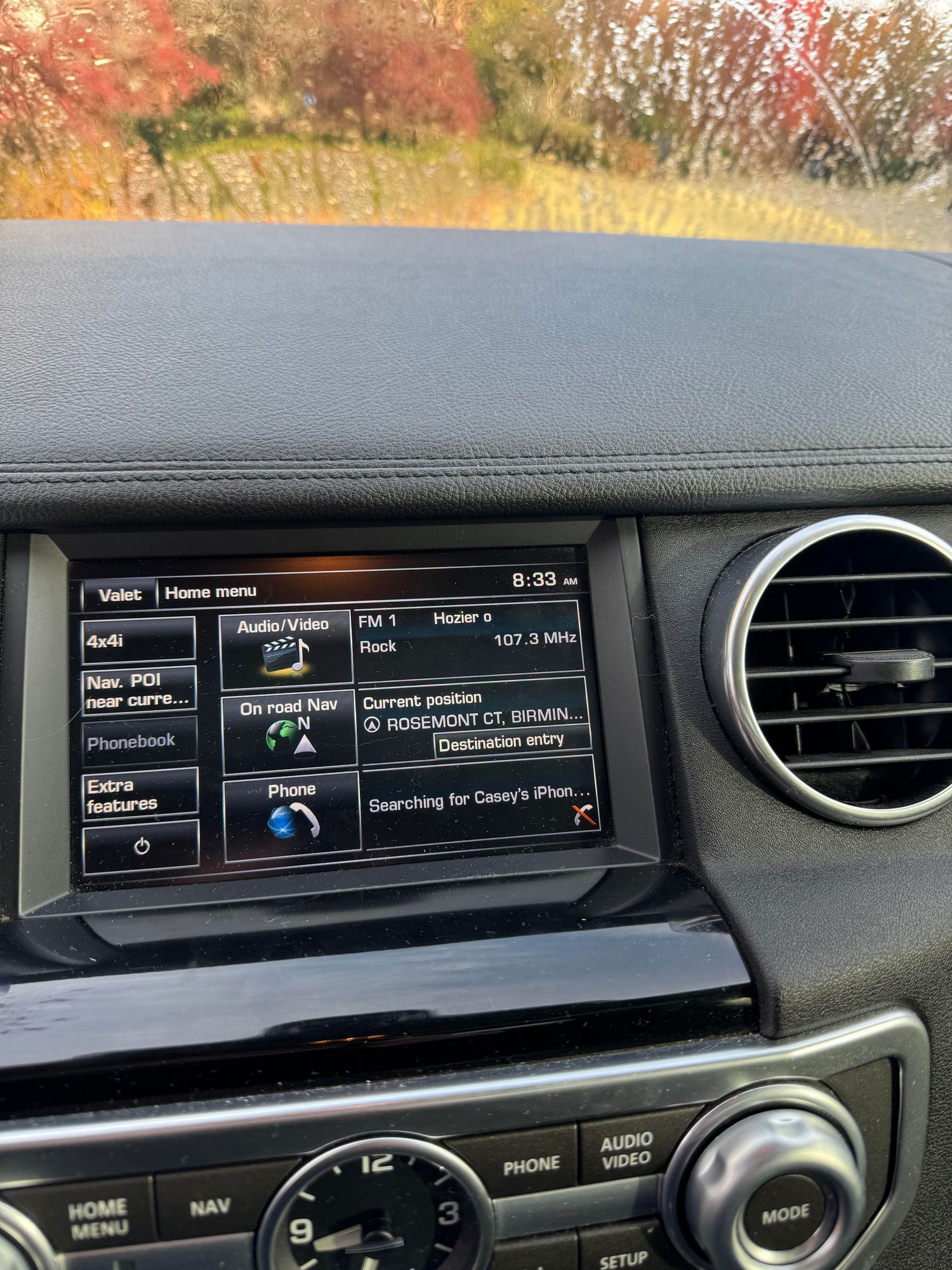

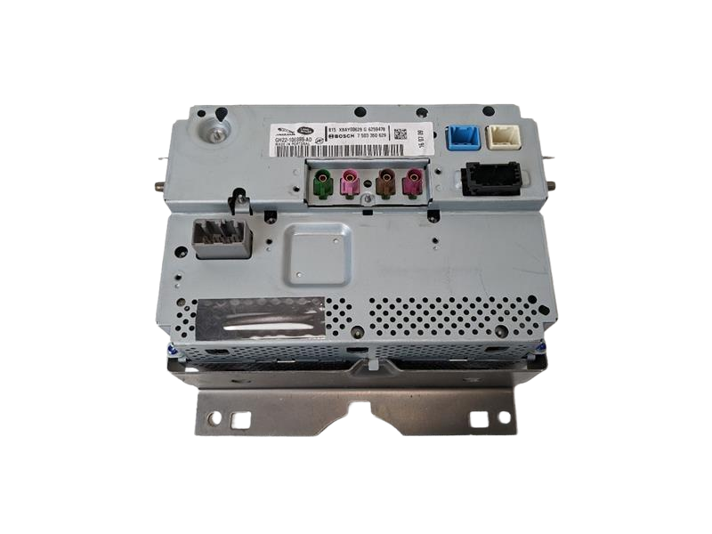

I found a post from 2021 with an install of a Tesla Style Screen, but I thought I would post an updated one. My son and I installed the Tesla Style Screen from Euronavigate in his 2015 LR4 two weeks ago so I thought I'd share. Euronavigate was very good at making sure they knew exactly which head unit I had (there are 3 different styles I think) so that they could program the correct can bus protocol. I originally purchased the dual **** style but they said the Tesla Style Screen was the appropriate one for 2015. Hear are a couple of pics of the front and back of my screen:

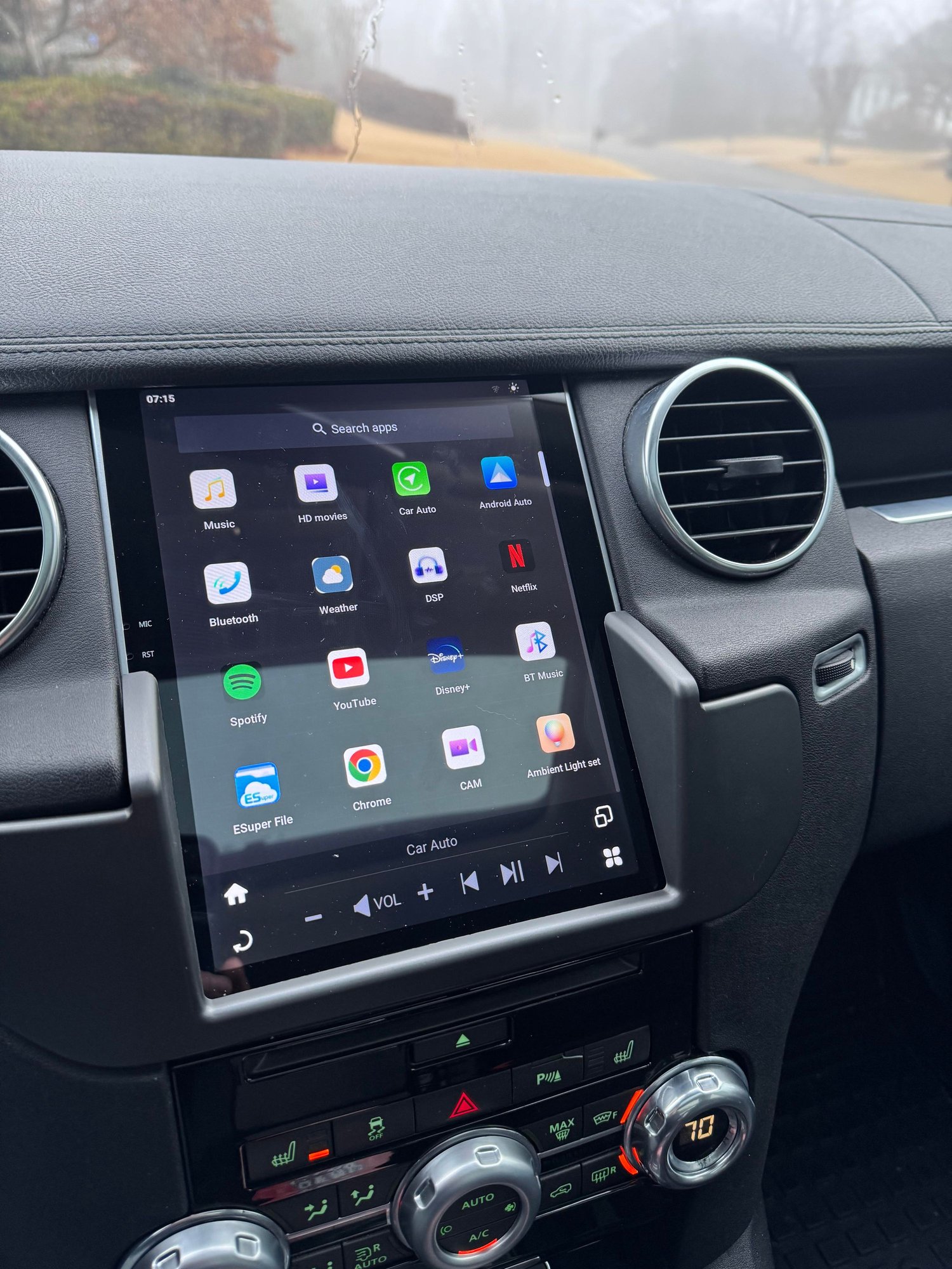

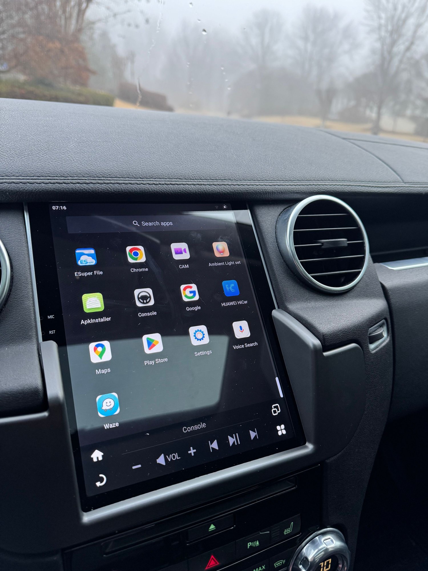

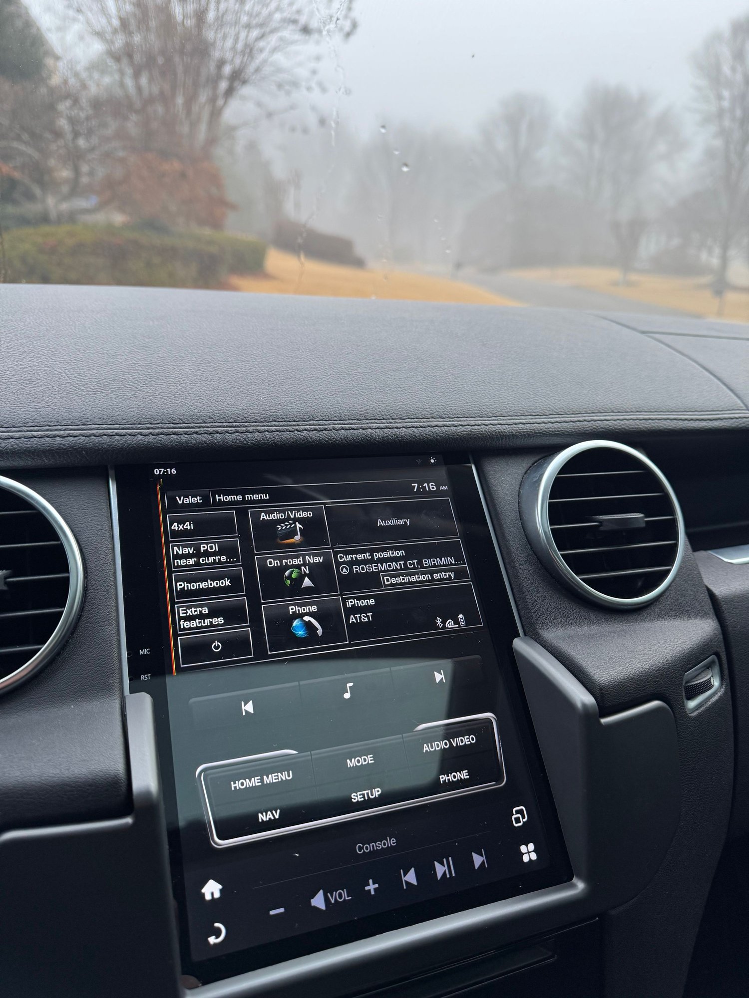

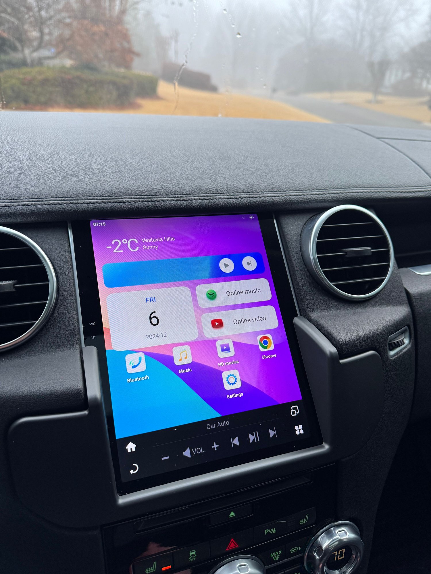

The older style head unit is a little more difficult to install from what I can tell from the Powerful UK video, but other than that it's pretty much the same. You need standard trim tools to remove the two side vents (and strong hands). Also, I had to use a T20 for most of the screws, a T10 for two small screws at the bottom of the AC control panel (they are behind a small trim piece), and a T8 to separate the back of the head unit from the front screen. Before you start, you might want to go ahead and set the Mode to AUX which is what you need to actually here sound. Here are a few pics of the result:
Final thoughts: Euronavigate was a bit slow in providing install instructions, but the video link above is pretty comprehensive. My son will mostly use Carplay which works fine and has been pretty consistent. As you can see for the pics above we still have access to the old screen (there is a steering wheel app on the Tesla Style Screen), and that's how I set the Mode to AUX after it was installed because no sound was coming out while using Carplay until it was set. At first the sound was only coming out in Mono on the right side speaker, but I reset the supplied 3.5mm stereo cable that I ran to the glove box and that cleared up the problem. All steering wheel buttons work as do the cameras. Overall I'm pretty impressed with the setup and it looks good in the dash. I may get some double sided tape to affix the trim piece that was supplied. It fits well enough but is east to pull off. Let me know if you have any questions.
