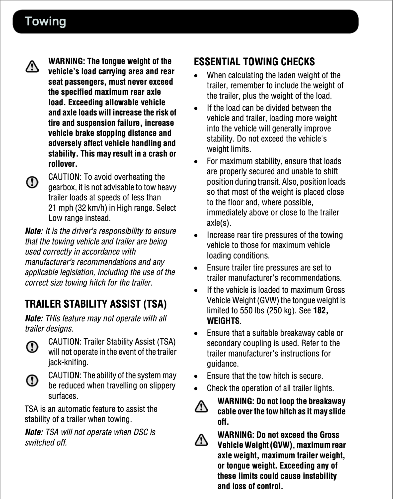

You may want to check the opinion on tongue weights seems to vary between 550 and 700 my hitch has 700 on it,but I don't l tow as rule

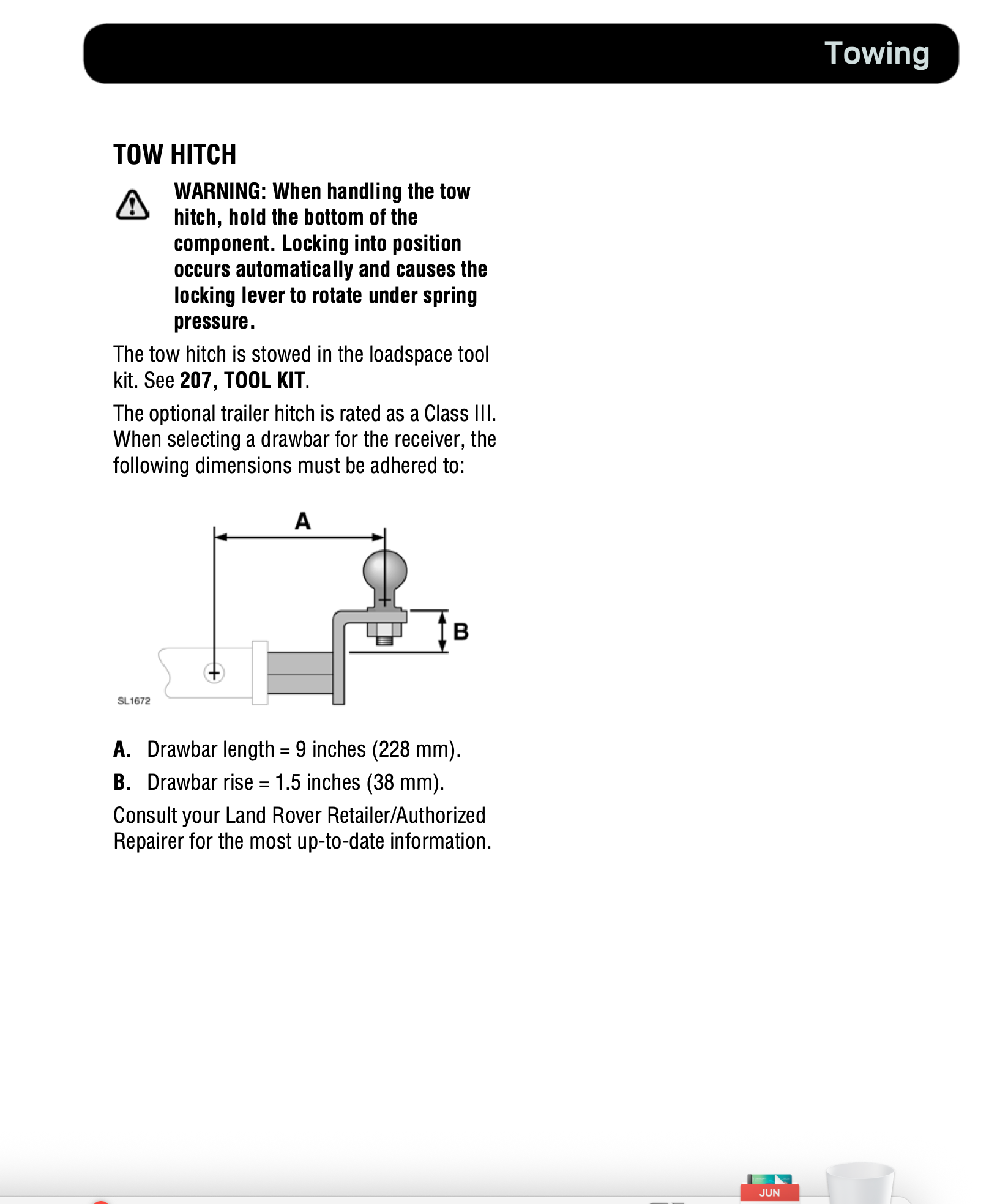

From the owner's manual. I've towed 7000 lbs.
