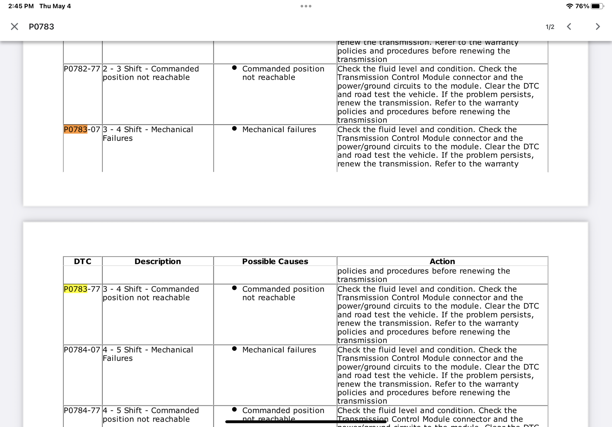

The transmission light came on a 2011 Landrover LR4 with 127,000 miles on it. There are no issues with shifting or on hills. The error code is P0783? Any ideas?

From the FSM. Good luck
