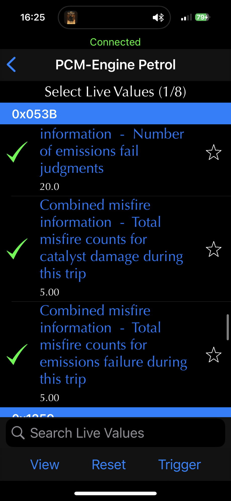

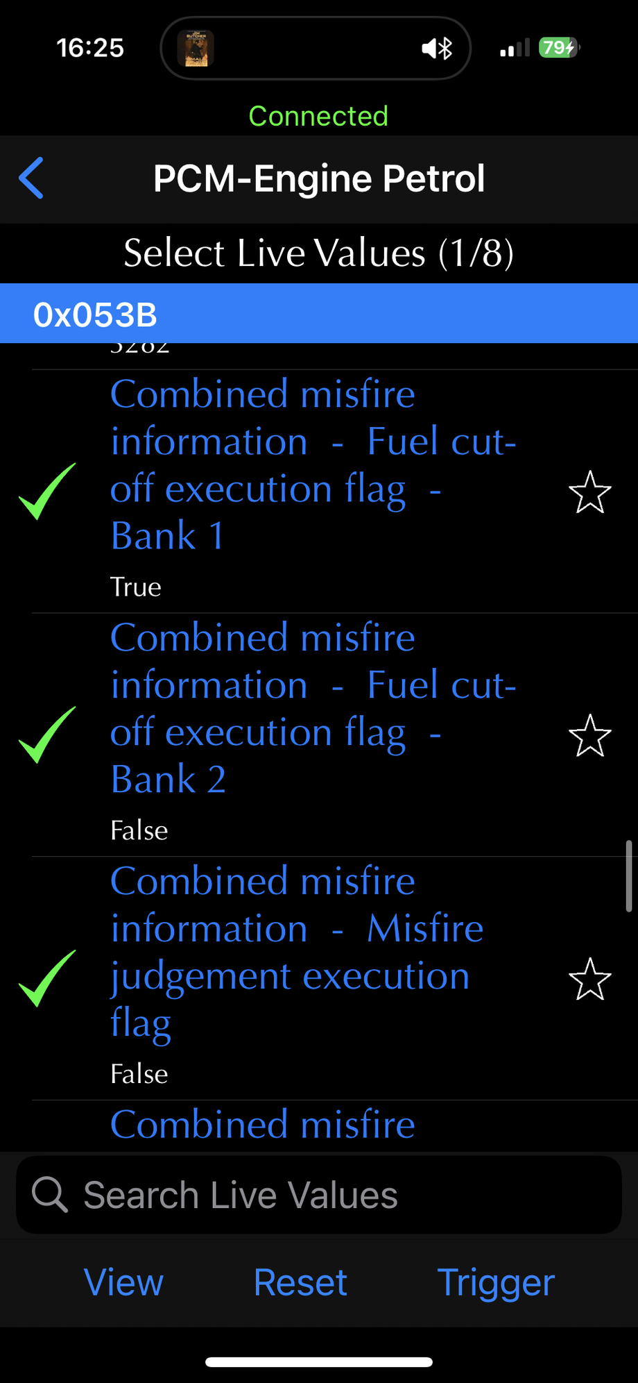

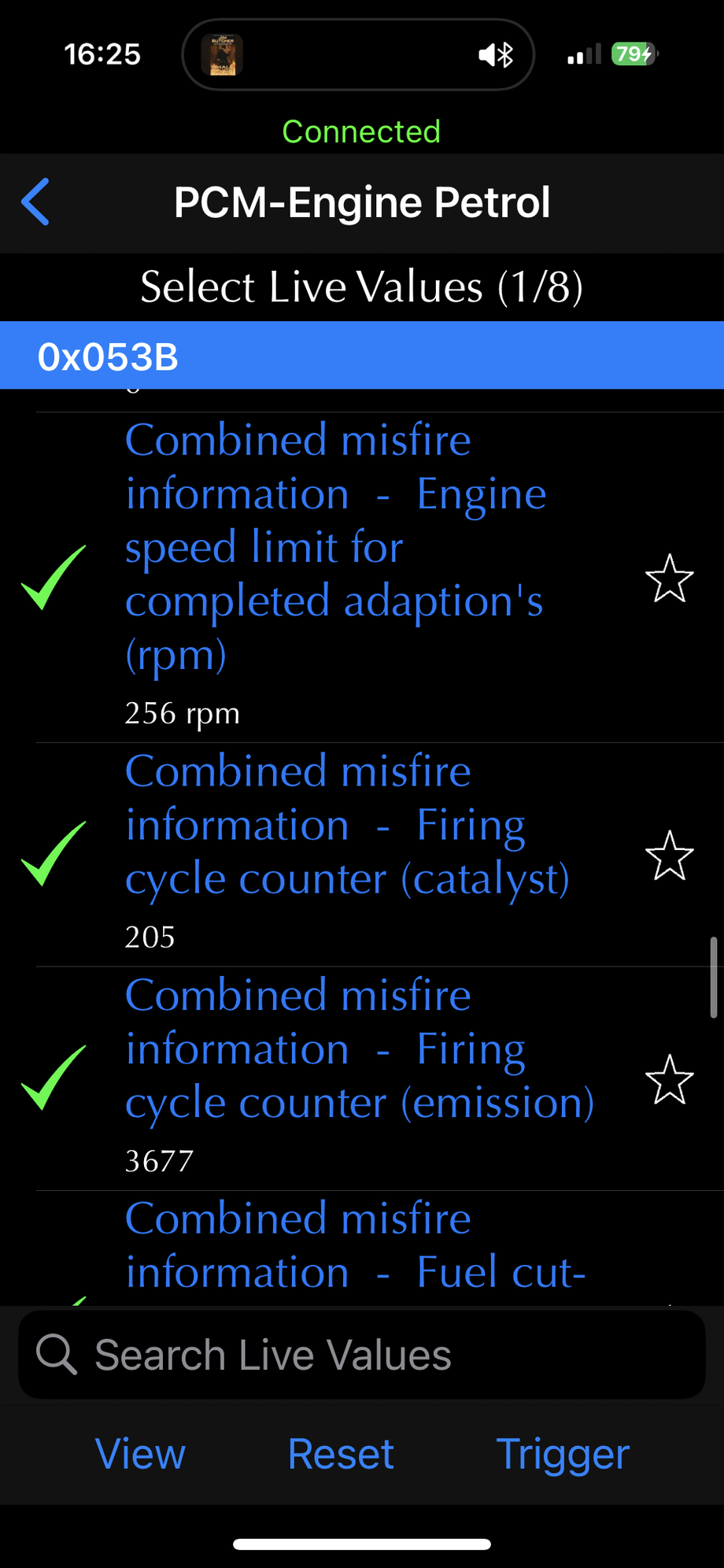

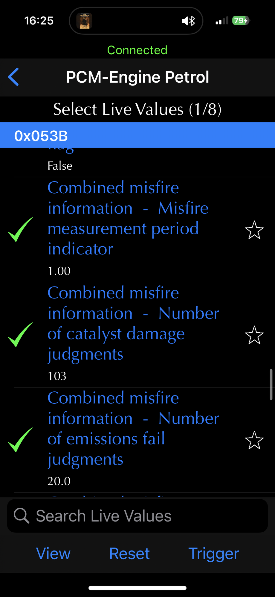

based on live values from the gap tool i am attaching some screen shots , that to my limited knowledge of how to read it, shows a missfire somewhere.

@Parky2012 Sure looks like misfires, but if you check you have no codes at all correct ?

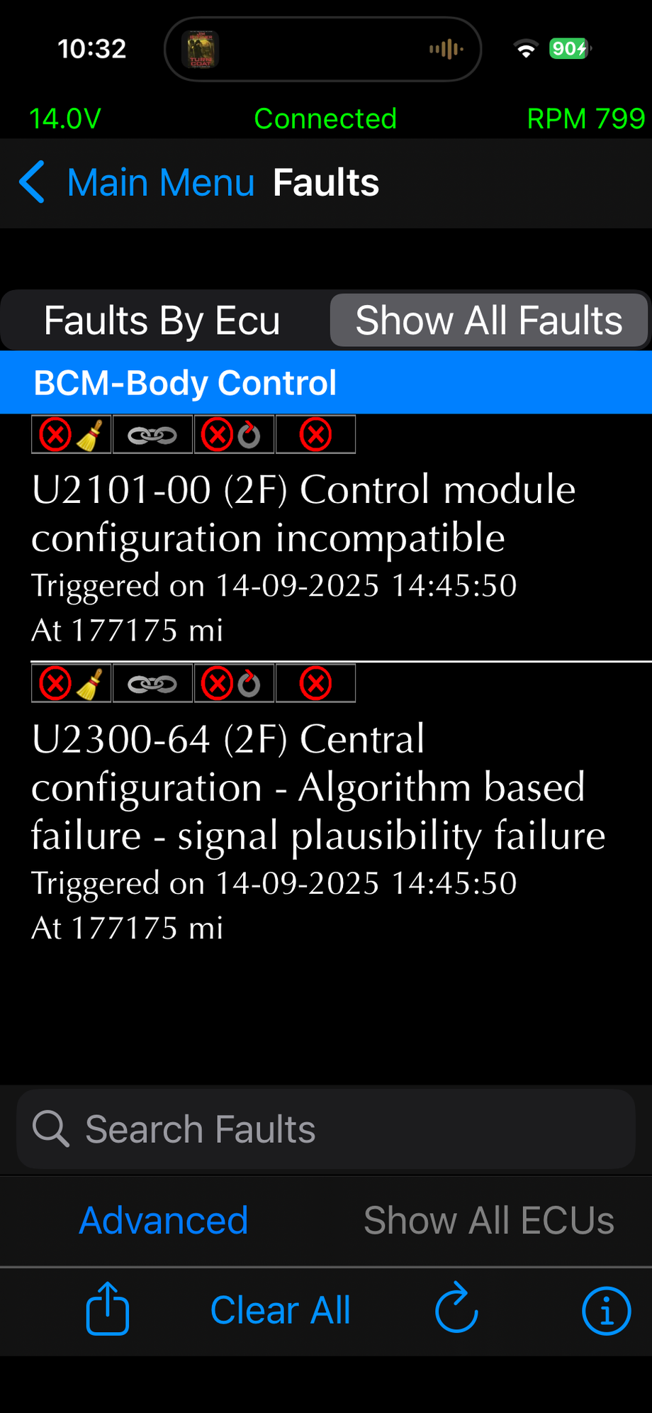

Richard
here are the faults. Not sure if they are relevant to the issue

@Parky2012 nope those are some of the random codes these trucks get. The whole thing is weird I would expect a misfire code, my thought is what grade gas are you running. These things want 89 or 91 good quality gas.
