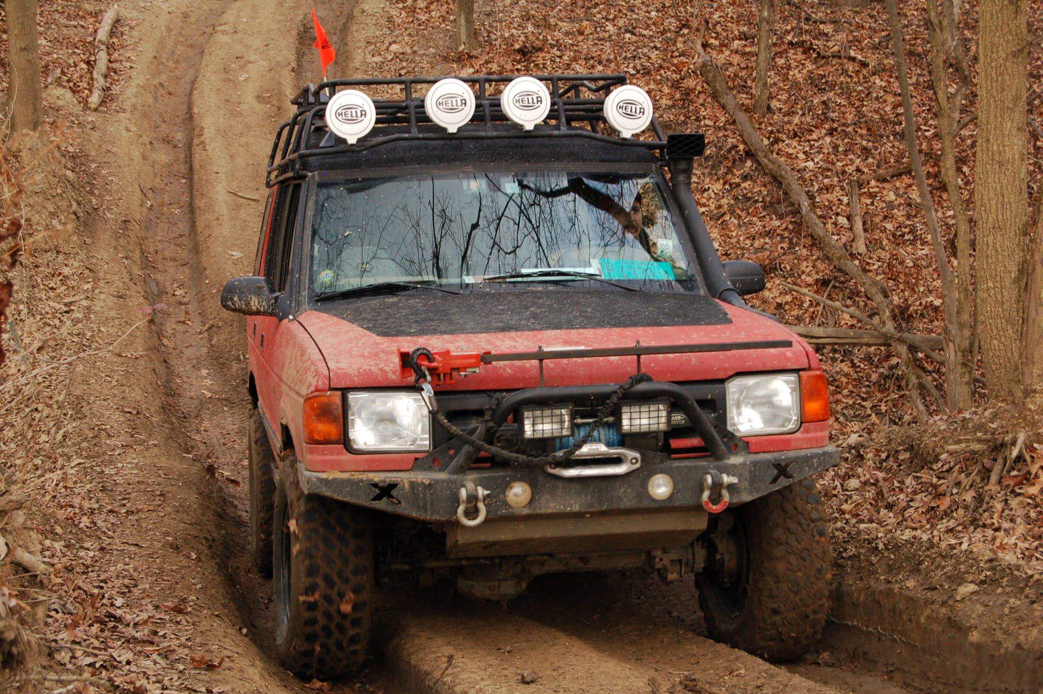

My buddy has fit a bunch of these Jeep bumpers to different Rovers he and his friends own, both D1's and D2's.
I think he gets them from Ebay or 4wheelparts

Think he would send you/post some photos of the way he has them mounted?
Or what brand he is mounting?
That actually looks pretty nice.
