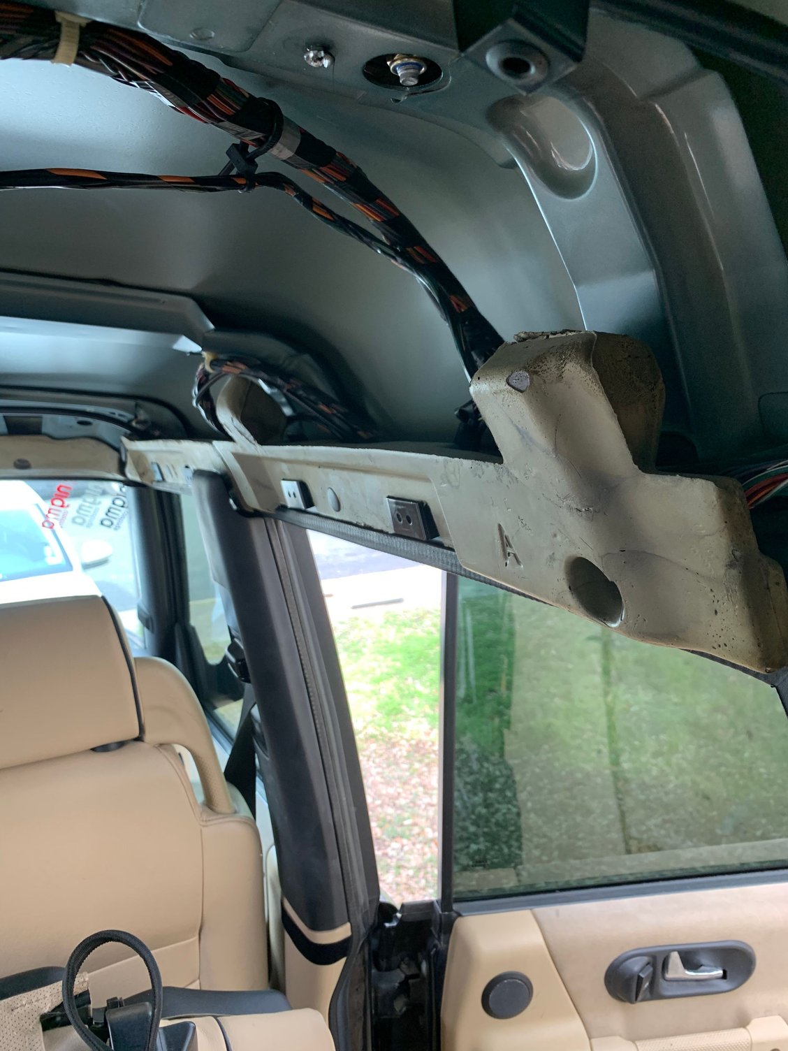

So I’m insulating my D2 so I’m taking the headliner out.

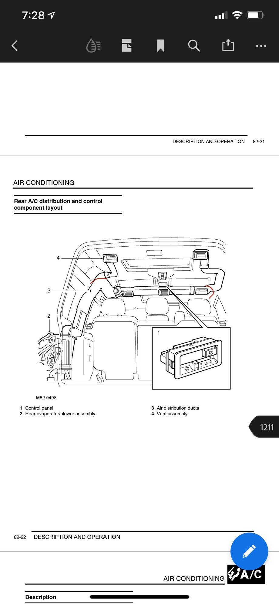

I do not have rear jumpers so I’m thinking of modifying the a/c duct work for efficiency to the second row.
Currently planning on making these mods with fiberglass but wanted to get other opinions. I’ve attached a rave pic that illustrates where I’m planning on modifying

Yea that’s all I’m doing. I’m removing the 3rd row a/c by cutting and fiberglassing the hole I cut closed.
im choosing that route because I’m trying to make sure second row air flow is as efficient as possible

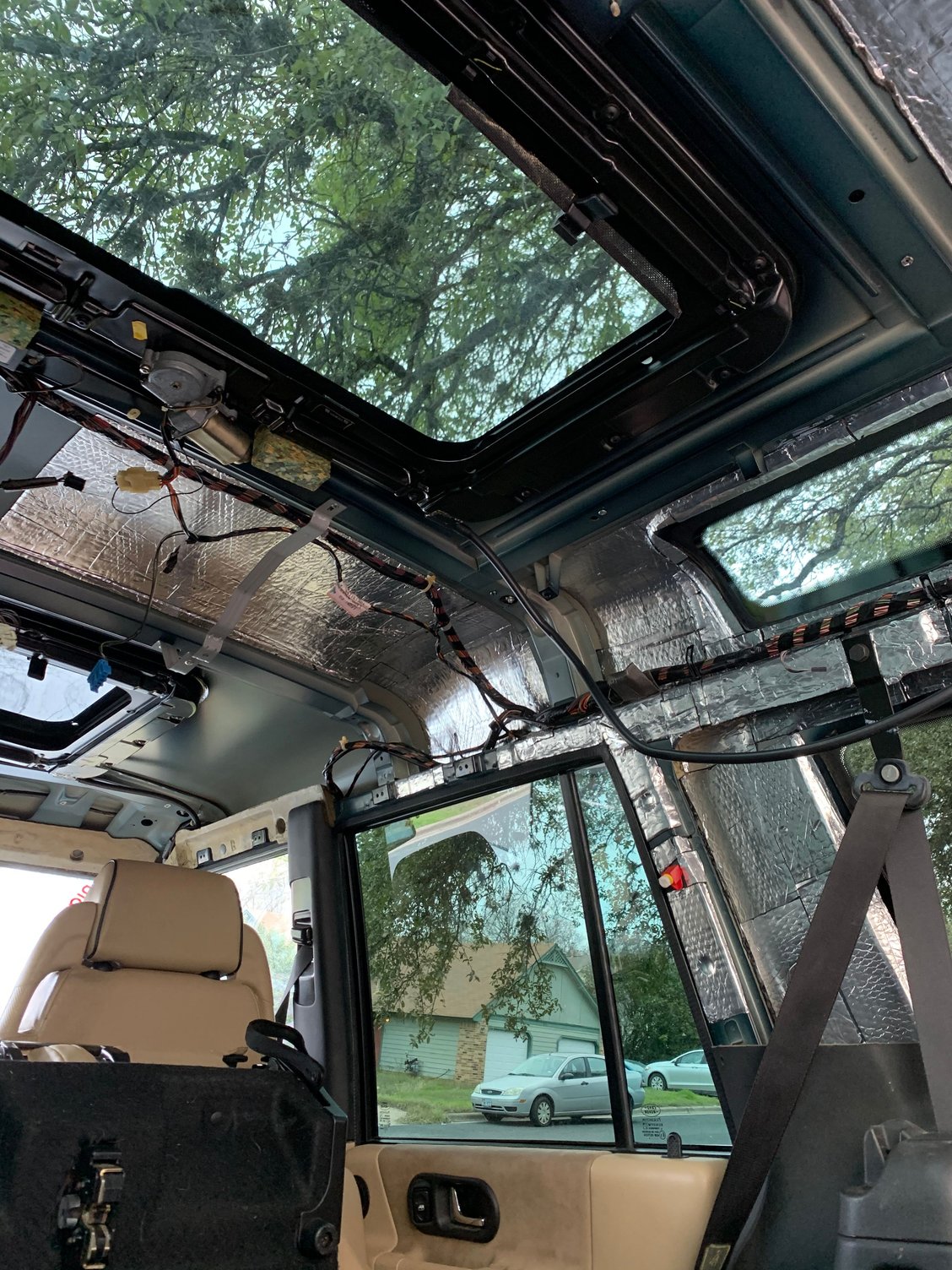

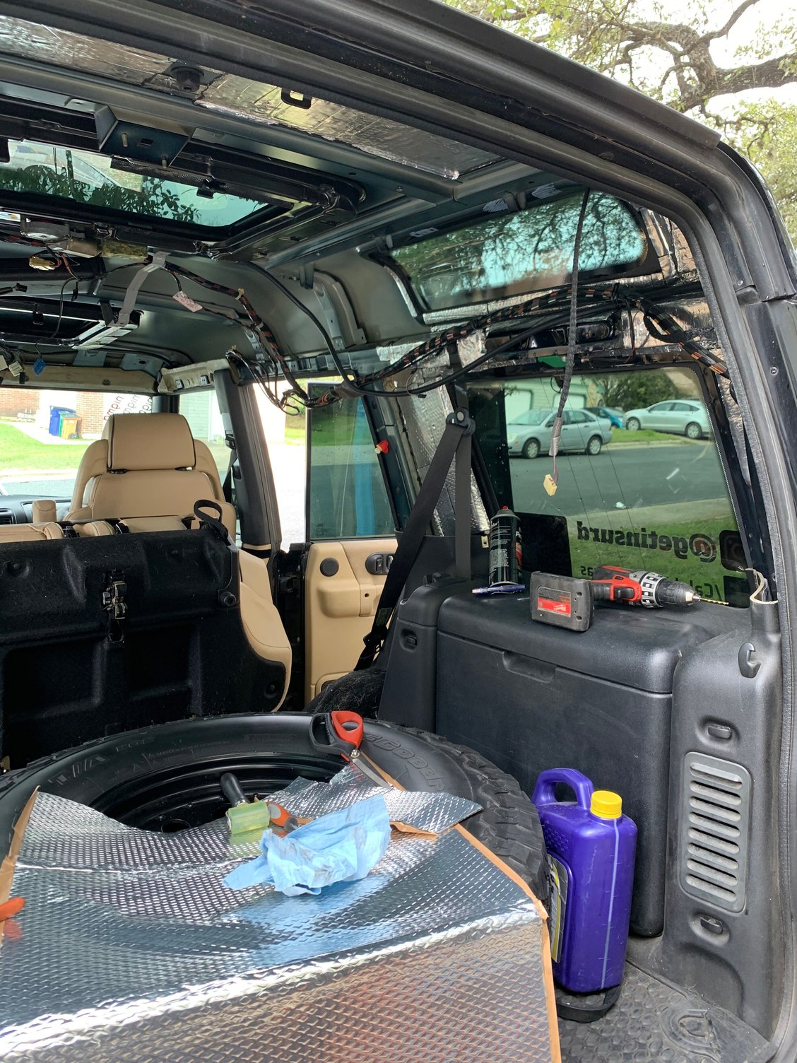

Some pics for more attention

So the update is, I just simply detached and covered the holes with foil tape and sound deadner. The 2nd row blows a little harder and gets cold faster. So I'd say this was a success.
