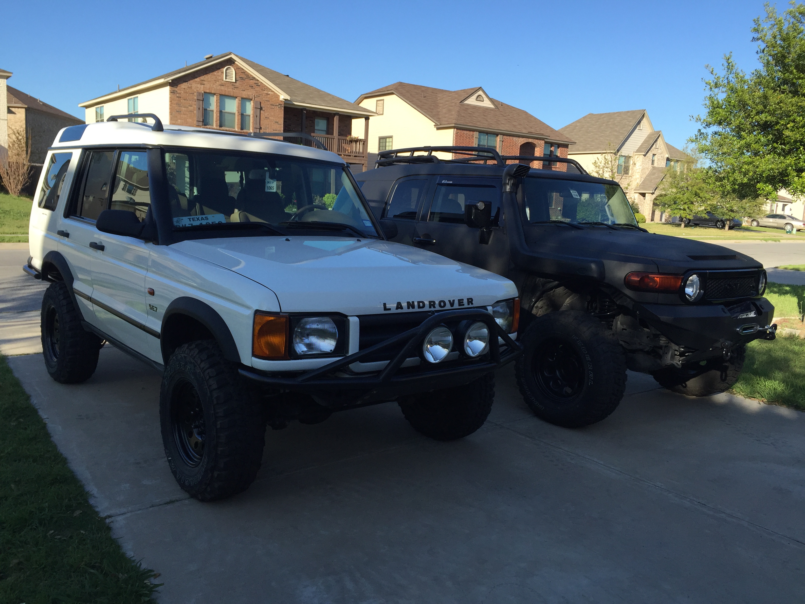

Went with the 32" and a 2" Terrafirma lift kit. Man the 2" suspension kit raised it more than the 2" lift spacers I used to use. Looks great...
Attached Thumbnails Looking for biggest tires without rubbing at 2" lift-037.jpg
