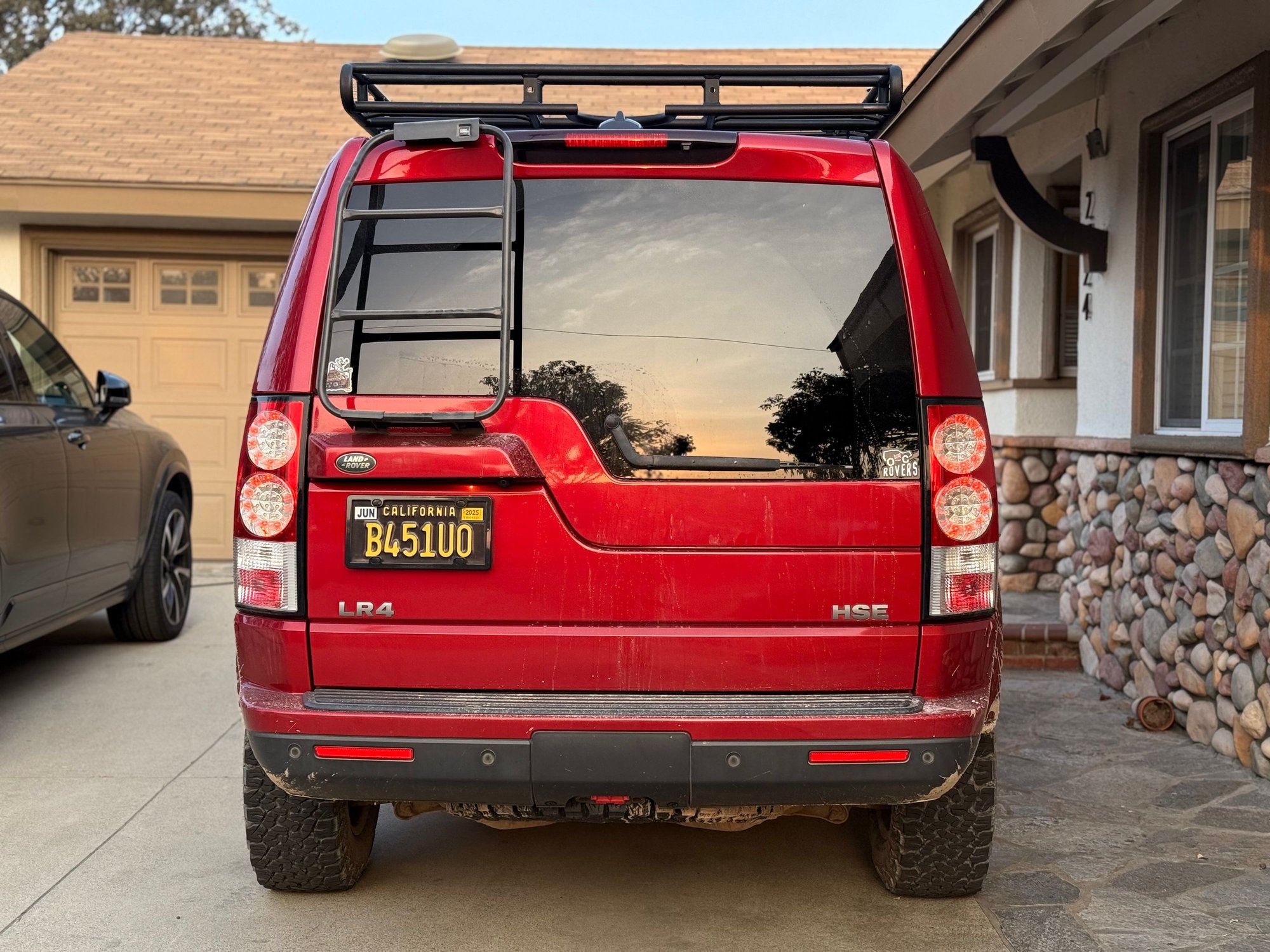

Hi everyone, My LR4 currently has a full length Bajarack up top which I'm very happy with. I'd like to add a rear ladder to the back and I've been looking for an OEM one but they seem to be long gone unless a used one were to pop up. I'm curious if anyone knows which ladders would be compatible with the Bajarack (as in wouldn't collide with the rack when opening the trunk). It seems like the Frontrunner one would work well but I can't find total confirmation.
Also, what are the realistic weight limit for these things? I'm pretty tall and broad (6'2" and 265lb) and just currently step up on the rear tires to access my rack but I like the idea of the ladder for a few reasons.
Thanks for any advice y'all can offer!

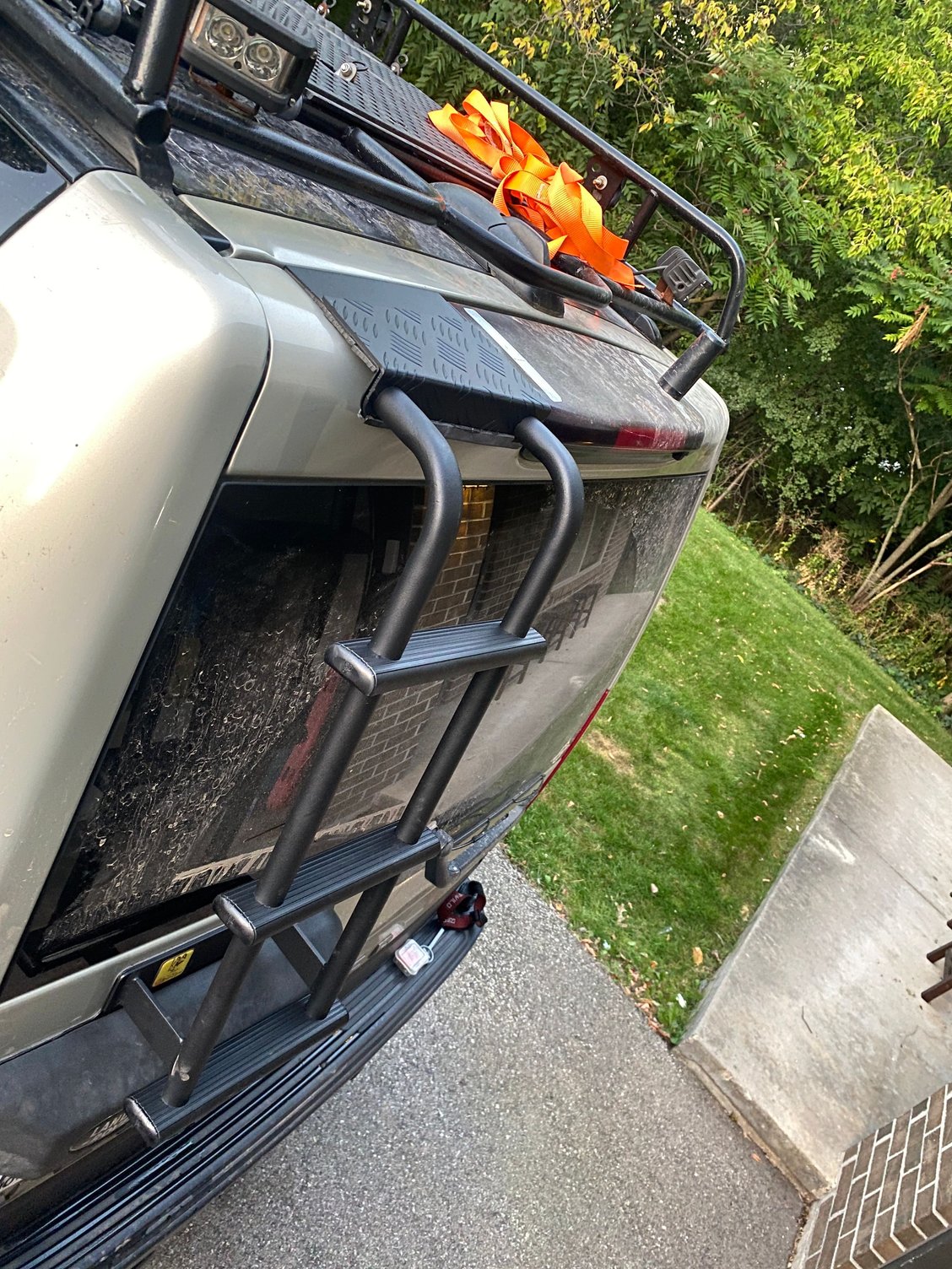

If the rack does not go past the hinge point - and it should not - then pretty most any ladder will work. Just avoid ladders that are higher than the lift gate itself and you should be fine. So like my ladder for example, it does not exceed the top height of the upper gate As for my rack, only the very center that protects the antenna actually gets close to the hinge point.

Great! Thanks for the picture that's really helpful!

I
In the end I chose the Frontrunner ladder and the install was very easy. Doesn’t conflict at all with my Bajarack
