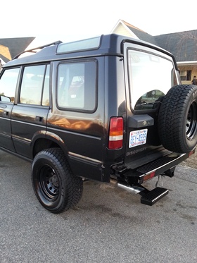

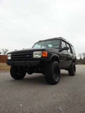

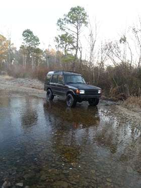

here is my 96 disco 7, so far i have upgraded the suspention to a 2.5 in terra firma shocks and medium duty springs. this disco is a blast to drive. i had also installed extension blocks on the swaybar for more articulation but unfortunately i had to remove them because my springs kept popping out of their place. im working on getting "relocation cones" to keep this from happening.
