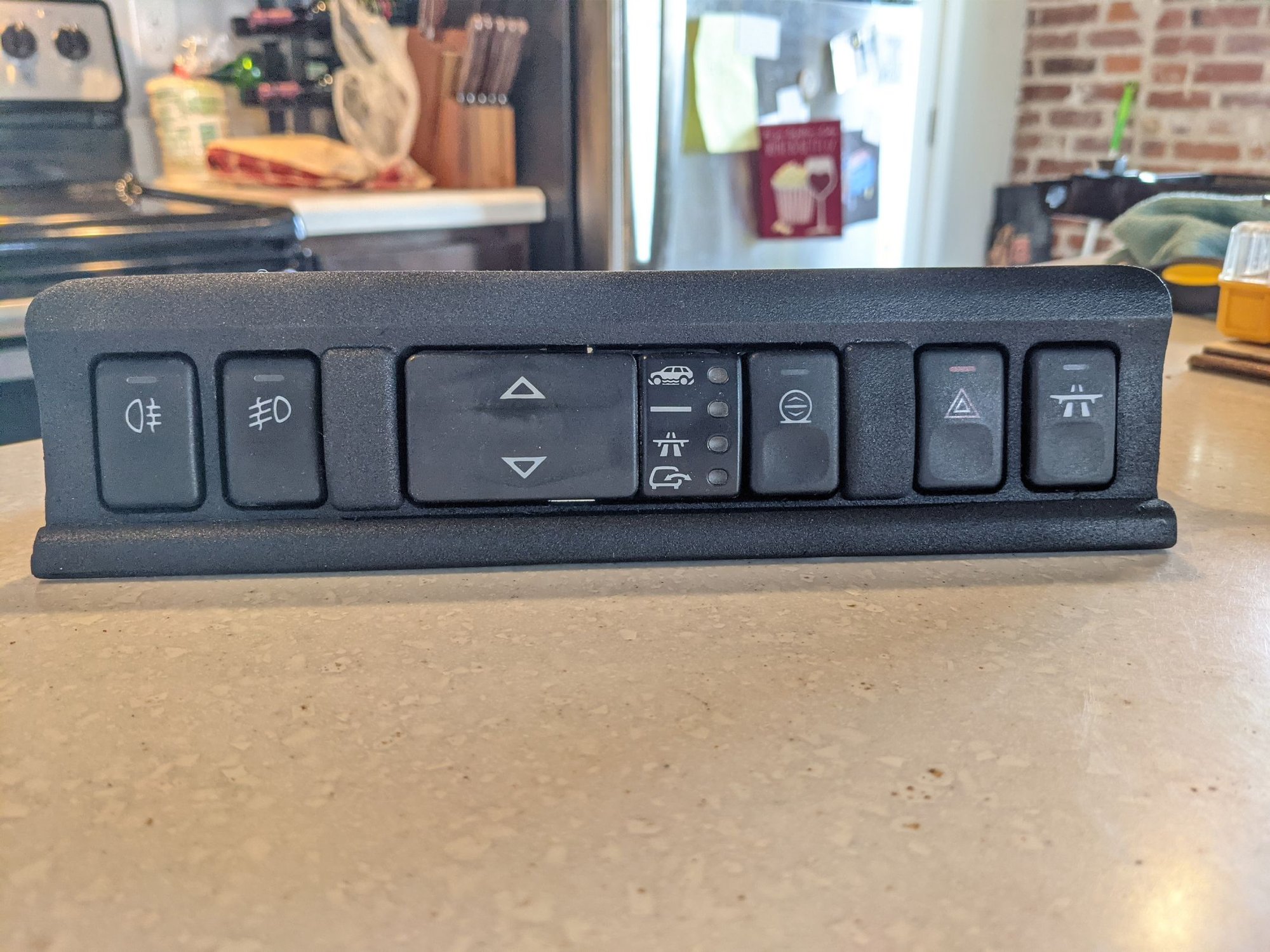

I made a stand alone harness to plug into factory harness running the factory HK 11 speaker system that preserved the steering wheel controls. Did not attempt to hook up the AM/WB or wire in the 6 disc changer as I haven't used any of those features in years.
I designed and 3d printed the bezel with brackets to lock the pioneer DMH WT76NEX screen into place. I can reproduce this if anyone wants the same thing.
Pioneer DMH WT76NEX or 7600NEX
PAC SWI-CP2
Metra 70-1784 harness adapter
(must include the two pin-in wires)
Metra 40-VW10 antenna adapter
SiriusXM SXV300V1 antenna
(Add cameras, HDMI, aux, USB as desired for your application)
