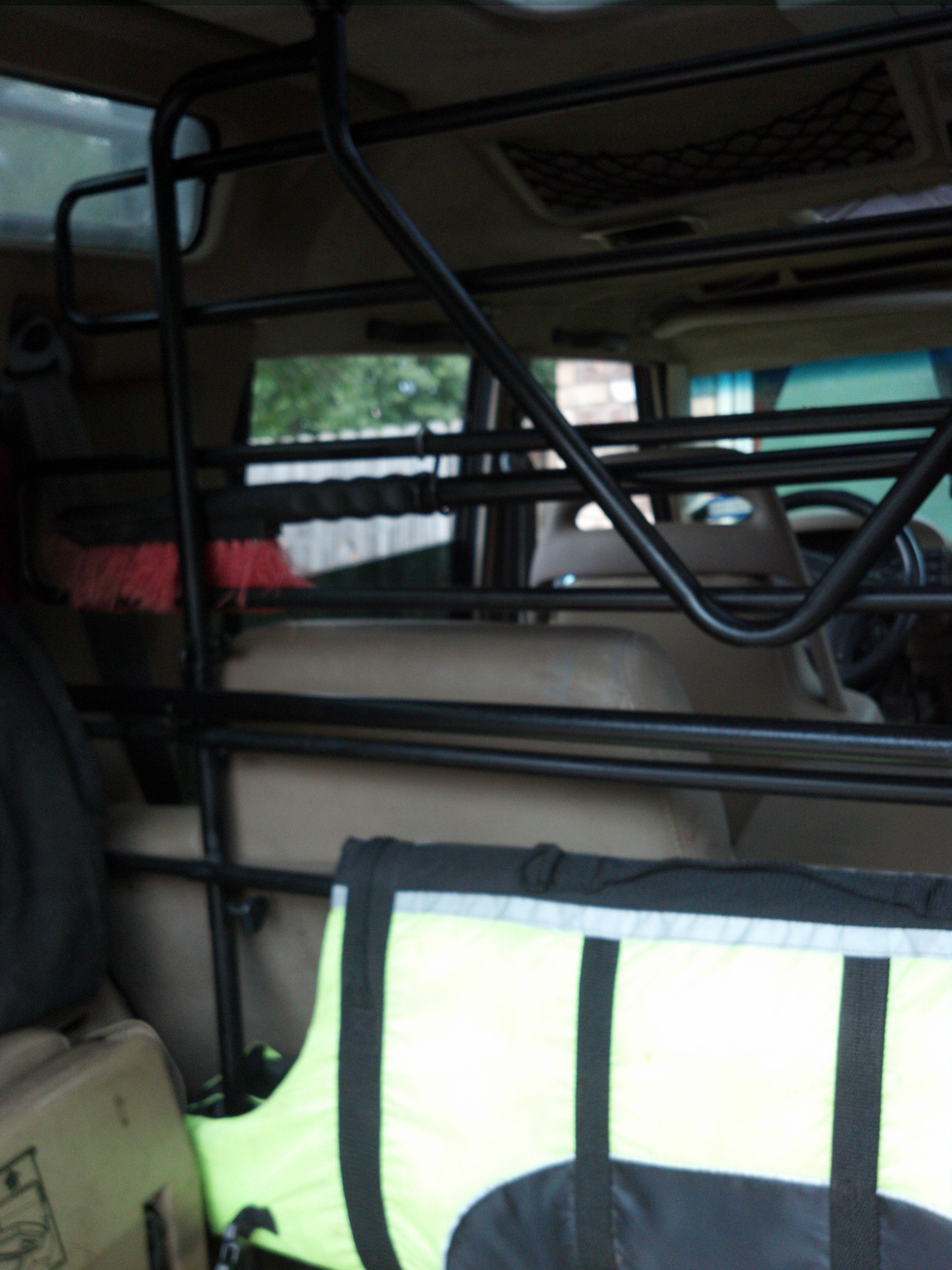

It took way to long to do this, but it is done now. I cleaned this area completely up to make room for Woof my dog.
I used the other half of the toolbox that I used for the bumper mounted tire gate/toolbox to make this one inside.
The area not covered by the toolbox is an old rubber floor mat protector that I had lying around. I used the existing holes for the original cover to fasten it.
The reciever hitch is held by the old jack mount that was in the fr4ont beofre I made that into the second battery compartment.
The blue bag inside the toolbox is a recovery chain.
The stainless steel rings are for 2-quart dog pails that are on their way from Ebay.
I mounted the snow plow foam handle to the inside and the ice crapper to the outside. (No need for them but, old Boston habits die hard.
The jumper cables are mounted to the back of the small seat in an old laptop case and are accessible by the back or pulling down the rear seat.Attachment 26944

Sorry about the delayed response..I did not see the many years ago post till the last one posted and then I have been in the middle of changing things on the gate yet again. I have not ever had to change the tire on the rover in all the years I have owned it, so I decided to move it to the roof rack. I am still going to mount the Poulon chainsaw case on the top of the rack but I need to buy another case, as the last one was lost in a fire. I also made a mounting bracket for the tractor supply out of 1/2 inch EMT that I had laying around.
I took more pictures of the mounting points of the gate. Just let me know what else you want to see or know about.
